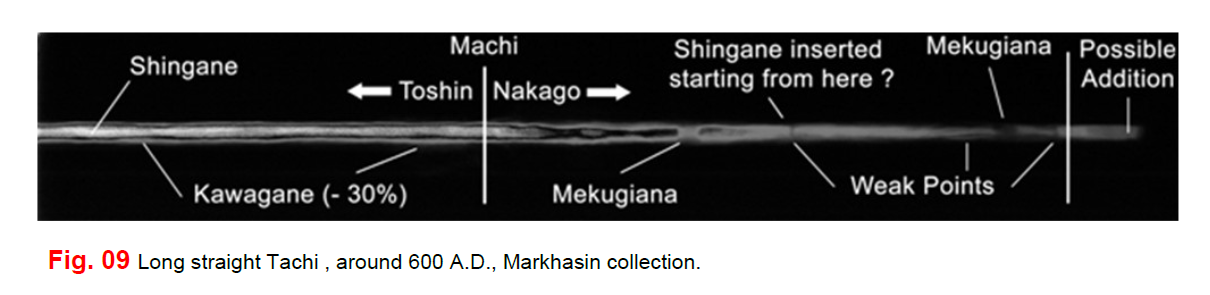

Carlo Giuseppe Tacchini Posted October 19, 2017 Report Share Posted October 19, 2017 A question I have often debated but never reached a conclusion on is whether the inclusion of soft core steel was of functional benefit or just away to save money. Shingane is present from the Han dynasty even in swords found in high ranking people tombs. As per the Soshu kitae I haven't a picture depicting a sword section showing it but I encountered mention of it many times during my studies as a further evolution of honsanmai. 3 Link to comment Share on other sites More sharing options...
paulb Posted October 19, 2017 Report Share Posted October 19, 2017 Hi Carlo Thanks for the information. I am not doubting it existed prior to the Bizen smiths using it just that in some schools and traditions it wasn't used. I haven't heard one way or the other regarding yamato work. Less focussed on the higher ranking users and aimed for greater practicality perhaps they incorporated it earlier Link to comment Share on other sites More sharing options...
Carlo Giuseppe Tacchini Posted October 19, 2017 Report Share Posted October 19, 2017 The study of the swords in the Shoso-in made by Markus are enlighting. Of course I can't boldly state that all schools and traditions used shingane always and every time. I offer only an opinion based on what I had and have researched not forgetting that in Nihonto exception is the rule... Link to comment Share on other sites More sharing options...

Jacques D. Posted October 20, 2017 Report Share Posted October 20, 2017 Shingane is present from the Han dynasty even in swords found in high ranking people tombs. As per the Soshu kitae I haven't a picture depicting a sword section showing it but I encountered mention of it many times during my studies as a further evolution of honsanmai. According your picture Soshu kitae would be existent in Heian jidai ? Soshu den was not born at this time... Kokan Nagayama was an expert and a polisher you are not polisher nor expert..... All that you can write has no real value.... You are like climate skeptic... Dunning Kruger... Link to comment Share on other sites More sharing options...

Carlo Giuseppe Tacchini Posted October 21, 2017 Report Share Posted October 21, 2017 According your picture Soshu kitae would be existent in Heian jidai ? Soshu den was not born at this time... Kokan Nagayama was an expert and a polisher you are not polisher nor expert..... All that you can write has no real value.... Sorry to delude you that's not a picture from my essay. I'm no expert nor polisher but used the knowledge of top experts and polishers to sustain my theory, all documented in high level publications I've cited in my bibliography. Anyway You have no arguments against a gamma ray picture. Shingane definitively existed much before you ridicolously insist it was, citing just one source in front of can't remember how many, including the ones that studied and cared the Shoso-in blades. BTW you'll be able to say that anything I write has no value only when you too (like me) will have an essay translated and published in Japanese by a Japanese museum (search in the Publications of Chubachi museum). Or Shut up. 4 Link to comment Share on other sites More sharing options...
