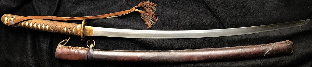

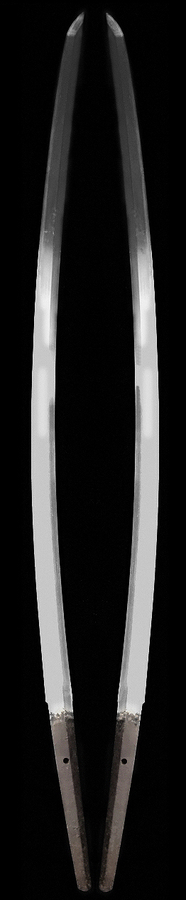

I try to identify school and maybe smith of this Shin-Gunto blade.
I think this 70 cm mumei sword is a shinto blade forged in yamato tradition. The nakago-jiri shows irriyamagata. The kissaki is small with a aoe-boshi? Maybe the blade could be from the Tomoshige line of swordsmith?
The habaki is made as two pieces copper with gold plated.
post-3496-0-82936700-1507305302_thumb.jpgpost-3496-0-77276800-1507305312_thumb.jpgpost-3496-0-23355500-1507305323_thumb.jpgpost-3496-0-53150100-1507305335_thumb.jpg
What you think?

I think that if this was a Hizen sword from the Kanbun era it would have konuka hada. I'm not sure I can make the hada out clearly in the picture. Also I would expect a komaru boshi. There's a lovely nidai Masahiro on Grey's website if you want an example.
http://www.japaneseswordbooksandtsuba.com/store/swords/k58-large-wakizashi-hizen-masahiro-tokubetsu-hozon
One of the problems with shinshinto swords (and to some extent shinto also) is that they can be a bit generic and the lack of a signature doesn't help. I suspect this might be why no one has taken the plunge with an attribution so far...and I'm not going to either.  :)
Suguba hamon and indestinct hada don't give many clues as to school, though the overall sugata does suggest that kanbun era is a possibility age wise and I doubt that it's much older than this. Some better pictures of the hada and boshi might help, but in the absence of any distinguishing marks, I suspect you might have a John Doe here.

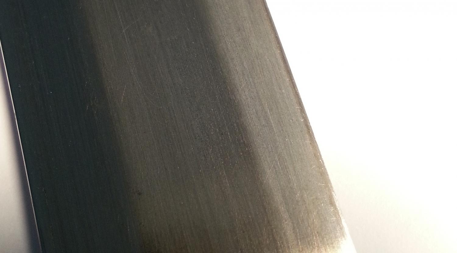

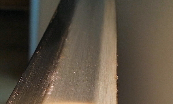

I try with another picture to see the hada.
But the polish is very old.
I see in the sunlight thin lines of chikei. No chance to make a photo, my camera didnt do it sharp.
Boshi is komaru from that what i see.
