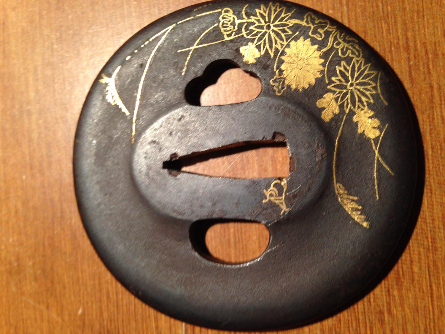

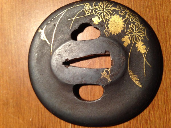

Hi Peter,
I have had this tsuba for a while but never got around to researching it. It had occurred to me that the gold work was added to jazz up an older piece and that the kakihan was the goldsmith's but I wasn't sure how to look up a kakihan without having an artist's name.
I'm not sure whether the kakihan are identical but they do have a passing similarity.
Here are some better photos. I think this style is Komai. I was also hoping the kakihan was of a particular school.
Regards Peter
Not much to offer from me, but having seen a reasonable number of Komai pieces I opine NOT Komai.  This is earlier work IMHO.
BaZZa.
Hi Guys
I thought Komies early career was i sword fittings. A friend said it might be Komie although he had only ever seen one and that was 20 years ago.
If anyone has any photos of a Komie tsuba it would be much appreciated if just for elimination. I also agree with BaZZa and think it is quite a lot earlier.
Many thanks
Pete

Hi Peter
I think in this instance the Kyo designation means Kyoto and Kenjo is the style, ie; these flat plate tsuba with fine wire nunome-zogan. Often these are more elaborately patterned, like the Seiyudo example, and it is thought they were intended as presentation gifts. In fact Kenjo means 'to present'.  :)

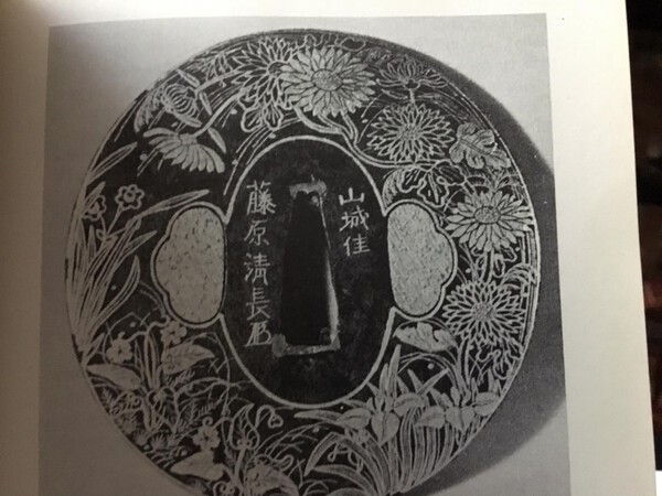

Hi Peter,
It has been a while but I found an entry in an old book which I think is of a tsuba by the guy who made yours signed "Yamashiro Ju Fujiwara Kiyonaga with Kao" (photo attached) and the corresponding entry in Haynes. I think that might solve our respective mysteries.
Best,
John
Hi John, thanks for making the effort to post your findings. This will give me another avenue to research.
I think this is what makes the NMB so good, people willing to make the effort to help others.
Also thank you Mauro one more thing i have learned.
