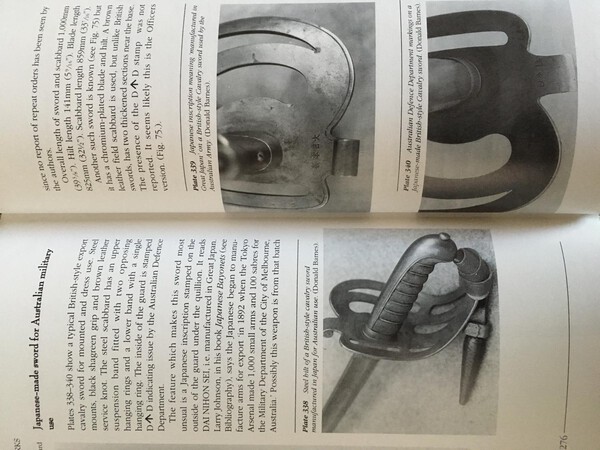

Ian, it's on pgs 276,277 and is not the Type 32 style (which would have been my guess too! He said they made 100 sabres for "Military Department of the City of Melbourne, Australia."

Time for some trumpet blowing - the photos are mine, as are some number in that book.  I remember that sword very well.  I think the camera I had at the time was a Pentax Spotmatic, now using a Canon 18-megapixel box.  Gotta say Darcy and rkg make me feel like a Kindergarten Kid!
The joy continues, still taking photos all these years later.  I'll have some more to put up in the near future.

Jim the Age newspaper of the 27th of January 1893 contains a reference to these swords the guts of which is that the Victorian Defence department purchased 50 swords from the Japanese "for use of the officers of the cadet corps ". The cost was one pound each as opposed to 3 pounds for  'those of English manufacture "
Ian Brooks
I;ve come in late on this, for 1892 (same year as Liverpool FC started), i would of thought the Type 25 NCO variant- as it too stared that year from memory.
I could be wrong but i think the type 32 started in 1896, so these you mention Jim would be earlier.
It actually resembles the type 8 NCO sword which was originally imported into Japan from England initially before production in Tokyo began.
My Fullers is packed away at the moment, so thanks Bruce for the quick photo here!
