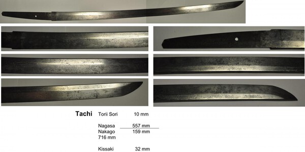

I worked in Indonesia for nearly five years in 1980/90s and travelled widely through the archipelago. In my travels I sought and found a number of Japanese swords .... and a lot of junk !! Most of the swords were gunto but a couple of exceptions where older swords were taken to Indonesia in WWll in military mountings
I have attached a photo of the nakago of an interesting tachi... and would seek some advice as to whether this sword is an antique ... or just a very smart fake. It was found in a remote part of Indonesia and, if it is authentic, I would love to track its history.  I saw many very good Japanese swords in Indonesia - most of them owned by a retired senior Indonesian Naval Officer who had been collecting them for many decades...

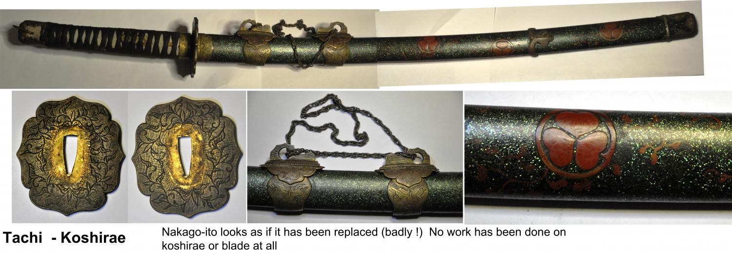

The mei has been altered with what looks like a file but the rest of the kanji looks clear. I have done no work on this sword at all apart from regular maintenance. The blade has no rust and is in ''good'' condition. The koshirae is like an efu tachi with ornate brass fittings and tsuba, old Tokugawa mons on the saya, and it has a beautiful length of old hyogo kasuri on the obi-tori.
I would appreciate some assistance as to whether I should restore this tachi and maybe get the blade polished. If the general opinion is that it could be authentic I will be happy to post measurement details and photos of the koshirae and blade. But I do not wish to waste any one's time if this is a load of rubbish... !!

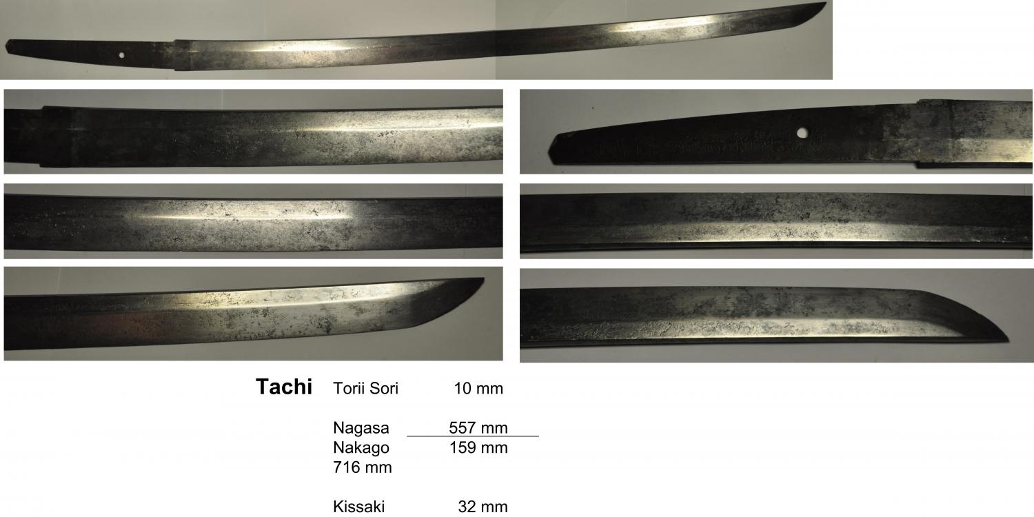

I have put together some further photos of this tachi - I am not a professional photographer so please excuse the lighting in the photos and I hope you can see more detail.
I have included some photos of the koshirae and the blade together with some photos downloaded from the Internet while I was looking into the authenticity of this sword.
I look forward to your comments

Gerney, please do a search on NMB to read about other questions on getting a blade restored. You definitely want to make sure that there is some chance of recovering your costs, when possible. Tsuguhiro was a mid-Shinto (Kanbun) smith, & although you haven't posted a full set of photos, I wonder whether it makes sense to polish your blade.

As far as this sword goes. I am with Ken. Make sure you don't end up with an investment that would get you buried. Thsi will also depend on how much you allready have invested in your sword. If you don't mind, can you please let us know how much you paid?
Thank you for your very valid comments Ken and Luis... I also do not want to over capitalise
I have been looking at other swords made by this swordsmith/school and considering my options. I would not proceed to commission a polish without a positive report from a qualified polisher after actually inspecting the blade.
I purchased this sword in Indonesia in Bandung which was the scene of some intensive fighting in WWll. I found little Indonesian interest in Japanese swords due to the bad outcomes of the occupation in 1942 - 45.
The Indonesian price would be equivalent to about USD750 in present day currency so I believe I have some room to get a good polishing completed - if the blade actually warrants this cost.
For $750 USD you're well within polishing margins, especially if it has sentimental value. Get some high quality photos of the entire blade and send an email to Andrew. Shame you didn't pick up any other Shin Gunto, I imagine there would've been some nice examples for decent prices back then.
