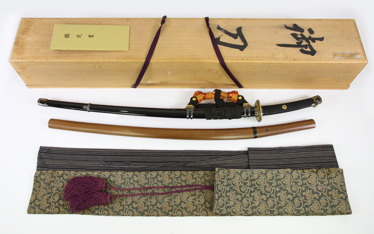

 So much skill and quality from blade to koshirae! If in fact it is by Sadakazu, what is the point? - his name alone, as one of the two pre-war Teishitsu Gigei-in, was and is highly esteemed. It does not masquerade as an old koto, so why would it be unsigned? I don't recall of another example like this. Any ideas?
 Arnold F.
