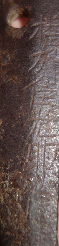

My bet is with Jean, :)  and the best match I  was able to find was this Kunisada and he looks like a chance (国定), Tenbun  1532-1555, Mino
Steve, you amaze me :clap:  I could not see Kunisada even with my glasses on :)
If I sell it and it turns out to be true Masamune I will happily buy it abck and even pay for return postage :laughing:

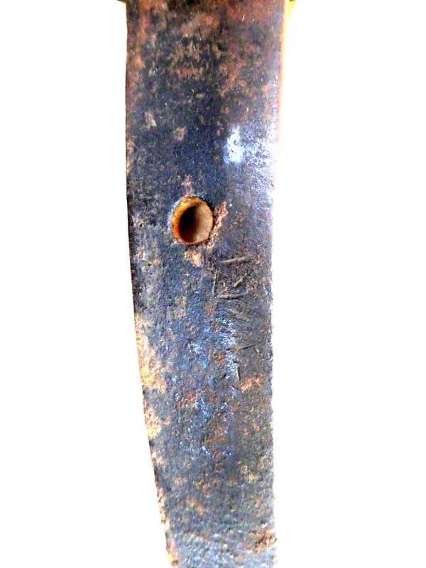

I do not have the blade in hands yet so unfortunately I can neither provide better images nor try to bring out the Mei any better. My feeling was that it is Nambokucho. I do not think late Muromachi. The Nagako has no mor evisible Yasurimi ... with a late Muromachi Nagako I would expect them to be more present.

if it would wants to be THE Masamune by mere chance we can surely assume  we are looking at 99.9% Gimei ...
When I bought it I thought it was signed Kunimune but Masa may indeed be a better  call for the firs Kanji.

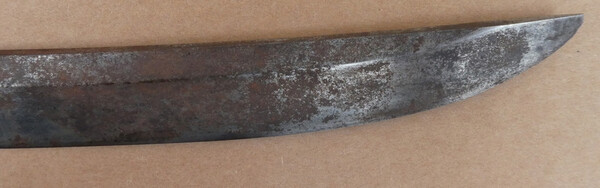

Without having it in hands it is not possible to judge on the state of the blade. However the decission on wheter it is worth of a polish will depend on who likely made it. In case of a Gimei or being Mid to late Muromachi by an average smithi I would not consider getting it polished due to not being economic. As the cost will outweight the value.
I had bought the blade at the estimated worth of its Fuchi / Kashira.
But if it is worth the effort I'd be happy to preserve the whole sword ... but since it will require a lot of work as the Koshirae is quite damagaed this has to be a reasonable decision. I enjoy bringing someothing out of teh woodwork back to live - but as most people I don't enjoy being buried.
hence I appreciate your valued feedback since getting it restored first and afterwards appraised would be a silly expensive lottery :)

Does anybody have an Oshigata for Banshu ju Mitsusuke saku and is willing to compare it?
Because either I have a Gimei Wakizashi sitting next to me ... or a late Kamakura to early Nambokuchi Wakizashi. The odds of someone faking a pretty unimportant guy are not the best out there ....

But back to this sword. I would like to thank all who have shared their oppinion so far. Once I have the blade I will try to get some better images of the Mei, some measurements and also show the Hamon and Hada. Maybe we can then make a better judgement.
Please don't get me wrong: I am most happy to learn that this blade is for example either Gimei, by an unimportant guy or very late Muromachi just as I am happy to learn it is the opposite. I am gratefull for any help that will make it easier for me to decide on getting it polished or not. By now we can all agree it is a Wakizashi from Koto periode.

Hi Luis, Jean and Ray gave you a best guess based on the few photos you provided us of an out of polish blade with a high probability that it’s not the Masamune and gimei but still has a chance it’s one of the other masamune as there are a lot of them in the Sue Muromach eg, Echizen signed with 2 kanji as did a few others  but you seem to not be happy with the comments from one of the most senior members and prefer to take the speculative long shot that it came from the Nambokucho so not much more we can add ? also, Jean did not say not to consider the yasuri mei just that it is not a good indicator as we don’t know if it was left in a shed for hundreds of years to rust or loved and taken care of.It does not mater if its crisp or not its the type of yasuri mei that's important.  When you get it, take a pic with the habaki off and looking down on the mune so we can see if it’s had a few polishes or not ? and a pic of the hamachi would help also what was the description from the seller ? :)

there seems to be a misunderstanding: This blade may well be Muromachi periode! NO argument on that! As I said I was looking for oppinions on the Mei based on the images I got by the seller who is unfamiliar with Nihonto. I got oppinions and I appreciate them for the most part no matter whetere they are positive or negative. I am after getting oppinions that will help me a decision based on facs. if this is signed Masamune is is by fact either Gimie or by an unimportnat smith so the blade is not worthy of polishing. Those are very appreciated facts as they will help me not to waste money and that is a good thing.

Luis,you will find facts can be hard to pin down in the nihonto world. It is very easy to form a negative on the net and we all misinterpret from time to time when we don't know how that person expresses their thoughts. I can tell you Jeans only motive was to try and help so I think you have misinterpreted how the info was presented. I think you will have to send it to someone who can see it in hand as it stands  you still may have a sword worth polishing :)
