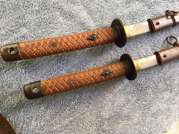

Neil, in the picture you posted of your two swords, is one handle longer than the other or are my eyes deceiving me???

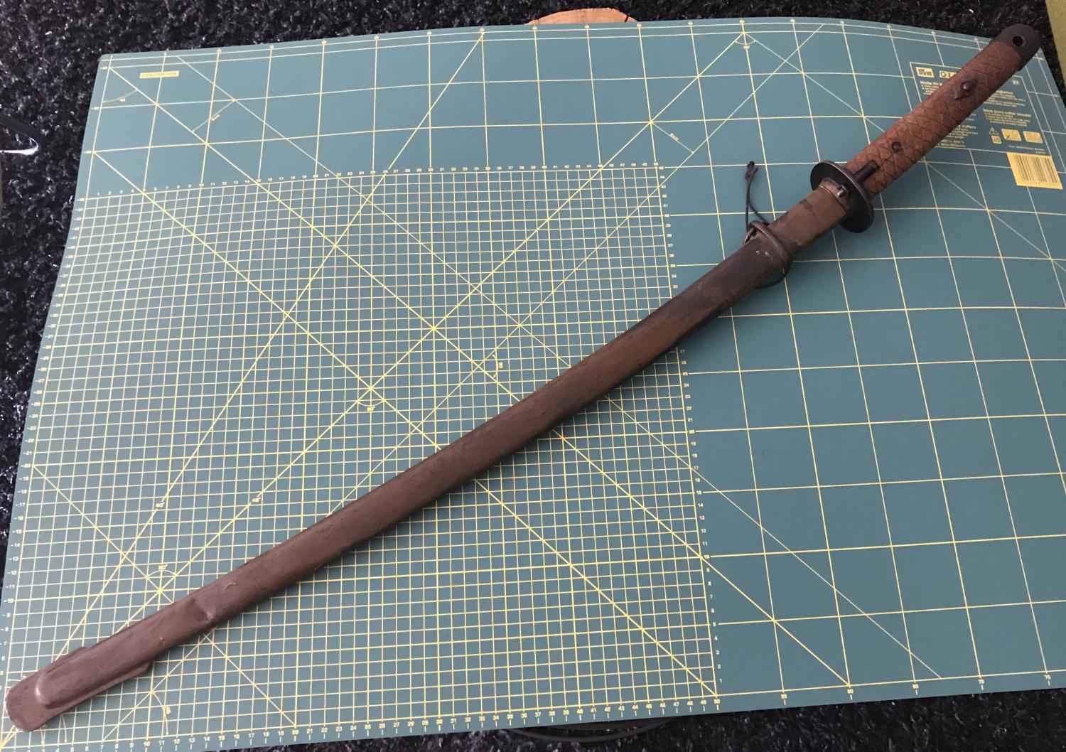

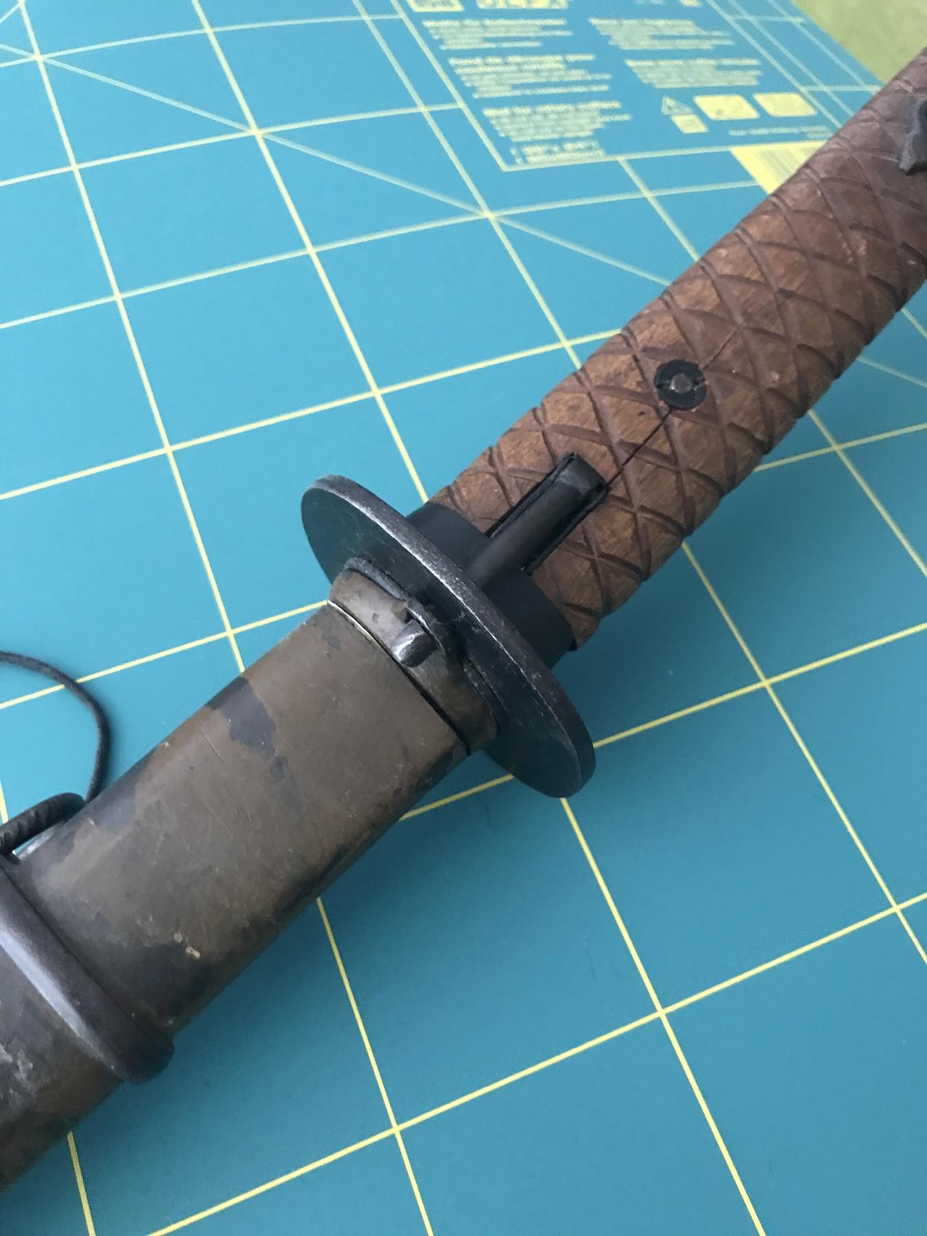

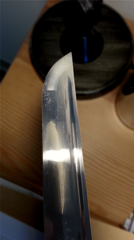

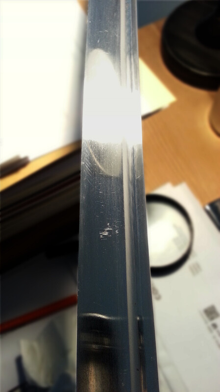

I have the sword now.
Here are some, i hope more detailed pictures.
post-3496-0-53666400-1502376182_thumb.jpgpost-3496-0-54637800-1502376197_thumb.jpgpost-3496-0-57519200-1502376236_thumb.jpgpost-3496-0-19418100-1502376261_thumb.jpgpost-3496-0-23181700-1502376281_thumb.jpgpost-3496-0-61018100-1502376308_thumb.jpgpost-3496-0-47613900-1502376350_thumb.jpgpost-3496-0-06476000-1502376375_thumb.jpg
The saya has the same number as the blade No.202817. I see a part of a seki stamp on the blade.  I can't identify the 2 stamps on the fuchi. The blade is in very good condition. The kissaki has a nice yokote.

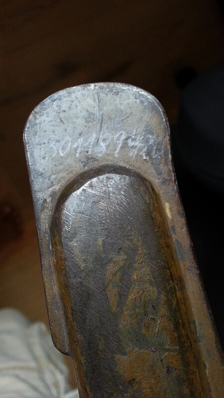

On the scabbard is a number very fine engraved. It looks like written with a pencil. Maybe it is the identification tag of the soldier?.
Edit: I found out that 8 Numbers are the tag of the US Soldiers in WW2.
I found under enlistment records the name of a PFC from the USAAF who served in WWII with that Tag. Born 1926, died 2013 (Miramar National Cemetery).
