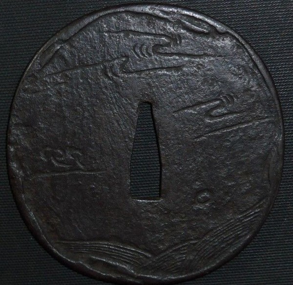

Hello,
I am hoping I can get some help identifying the school, name of the style, and the age of this tsuba.
Measurements:
84.5 mm  tall
81.5 mm wide
3.7 mm roughly at mimi
3. mm or slightly less on face
It is forged iron with evidence of folding
It has what looks like a natural black patina,
and there is curious "melted" or brushed surface to
the right and above nakago ana on both sides.
I was wondering if this could fit ko-shoami possibly?
Thanks for your help.
Kind regards,
John (johnnyi)post-3005-0-37460600-1501870287_thumb.jpgpost-3005-0-85575900-1501870309_thumb.jpg
78 views and no opinions?  Please, if it is something glaringly obvious don't spare feelings :)   I might have written this one off if it wasn't for the folded iron, and the similarities of the border of the plate to a ko-shoami and one or two early saga kaneiye.  Any  help is much appreciated
regards,  John
Hi John
When I looked at it earlier I didn't like the nakago ana and wondered why there was no shape to the seppa dai are or even any wear marks
I don't think there are enough clues to suggest a school and dating is difficult from images
I hope someone else joining in to this post
John,
for me, this one is difficult. Very similar decoration on both sides, looking a bit 'amateurish' and not like an expert's free-hand design. The surface seems to be coarse in some places, but I am hesitant to call it cast.
Perhaps if you could show more of the TSUBA, e.g. the folding or some close-ups, then a comment might be easier.

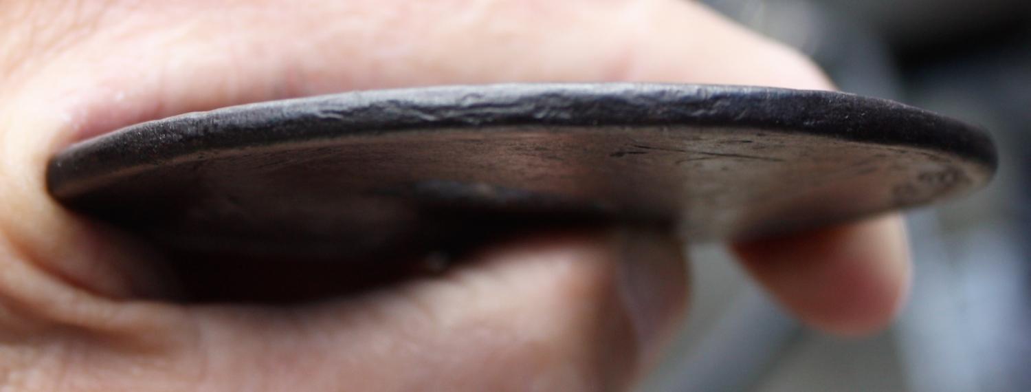

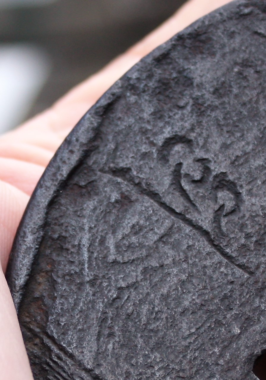

post-3005-0-23599300-1501957951_thumb.jpgpost-3005-0-24079300-1501957732_thumb.jpgpost-3005-0-83307700-1501957766_thumb.jpgGrev and Jean, thank you.  I had (have) the same reservations as both of you, however upon being assured that it is not cast, and its very low price, I have taken a chance.
I have edited this post and replaced two pictures. Hopefully you can see the edge of the mimi, the worn area of the seppa dai, the minute chisel marks on three corners of nakago ana, and what looks like a false wood grain (shows much rougher than in hand).
In all, very frustrating; either junk, or  old and interesting.,
regards, John
John,
no reason to be frustrated as you did not pay much! The 'chisel marks' do not appear as cuts, so it is still not obvious if this is a cast copy or a real TSUBA. One possibility is that the etching/pickling for a patina was excessively heavy on this one, but that is just a guess. The photo of the rim is not really sharp and does not allow a judgement.
Best advice I can give is to ask Ford Hallam or Curran or to take the TSUBA to a NIHONTO exhibition and show it to some experts.
