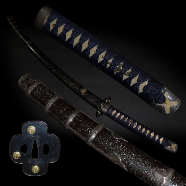

#36 parfaitelumiere
parfaitelumiere
    Chu Jo Saku
  • Members
  • 52 posts
  • Locationfrance
Posted 13 September 2017 - 06:09 PM
Are silver fittings meant to be silver color or weathered?
I have a silver mount sword and I don't know if I have to clean the fittings or not.
Patrice L

#39 parfaitelumiere
parfaitelumiere
    Chu Jo Saku
  • Members
  • 52 posts
  • Locationfrance

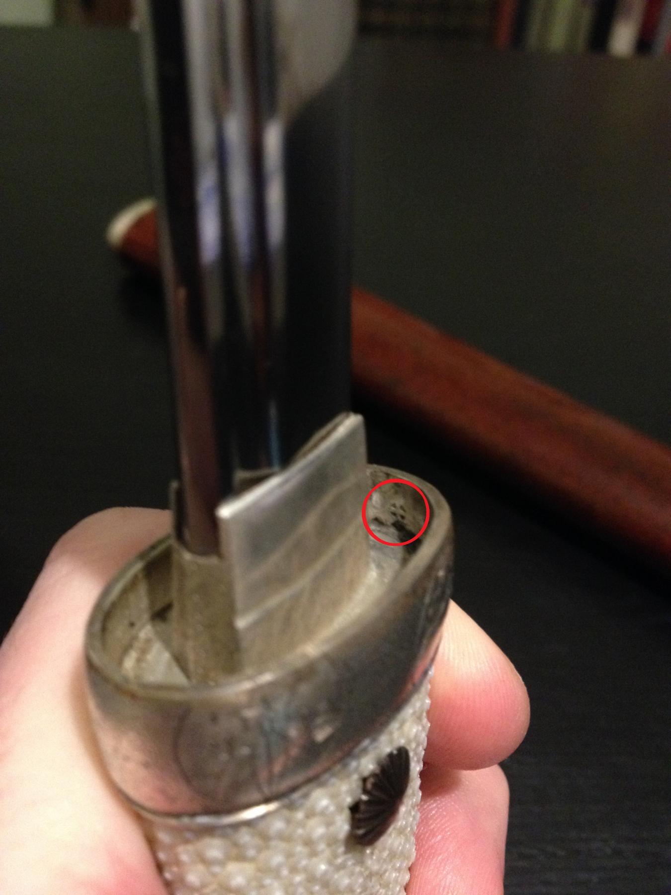

Posted 15 September 2017 - 10:42 AM
here it is:
details:
when we remove the tsuka it's easy to see the fuchi is solid silver because the flat area is copper and ring is silver.
For what I know, it seems the proper finish would be polished, but with a prior oxydation, showing pattern.
It would mean I would have to clean my parts, even I would prefer to leave as it is.
My main issue is I am making a new tsuba, and I will have to find a way the tsuba to match fittings patina.
The original tsuba is not the right one, and it had 3 seppa.
Patrice L
#40 Geraint
Geraint
    Sai Jo Saku
  • Members
  • 1,396 posts
  • LocationCornwall UK
Posted 19 September 2017 - 10:36 AM
Dear Patrice.
What a nice koshirae!  For what it's worth I would do exactly as you suggest and leave it as it is.  Your new tsuba looks the part, it should patinate quite nicely on it's own and will soon catch up with the rest of the fittings.  That way, and perhaps with a little judicious handling, the patina will appear on those parts where it should and not so much on those that are covered by the seppa for example.
All the best with your project!
Geraint

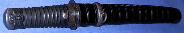

Something I found a while back: 3mm thickness 6.6cm × 6.8cm.  Obviously you can see the difference between exposed to air and not exposed.mantis 129.jpg

Nice Pete! Would like to know more. Great looking mei as well.
Jeremiah
