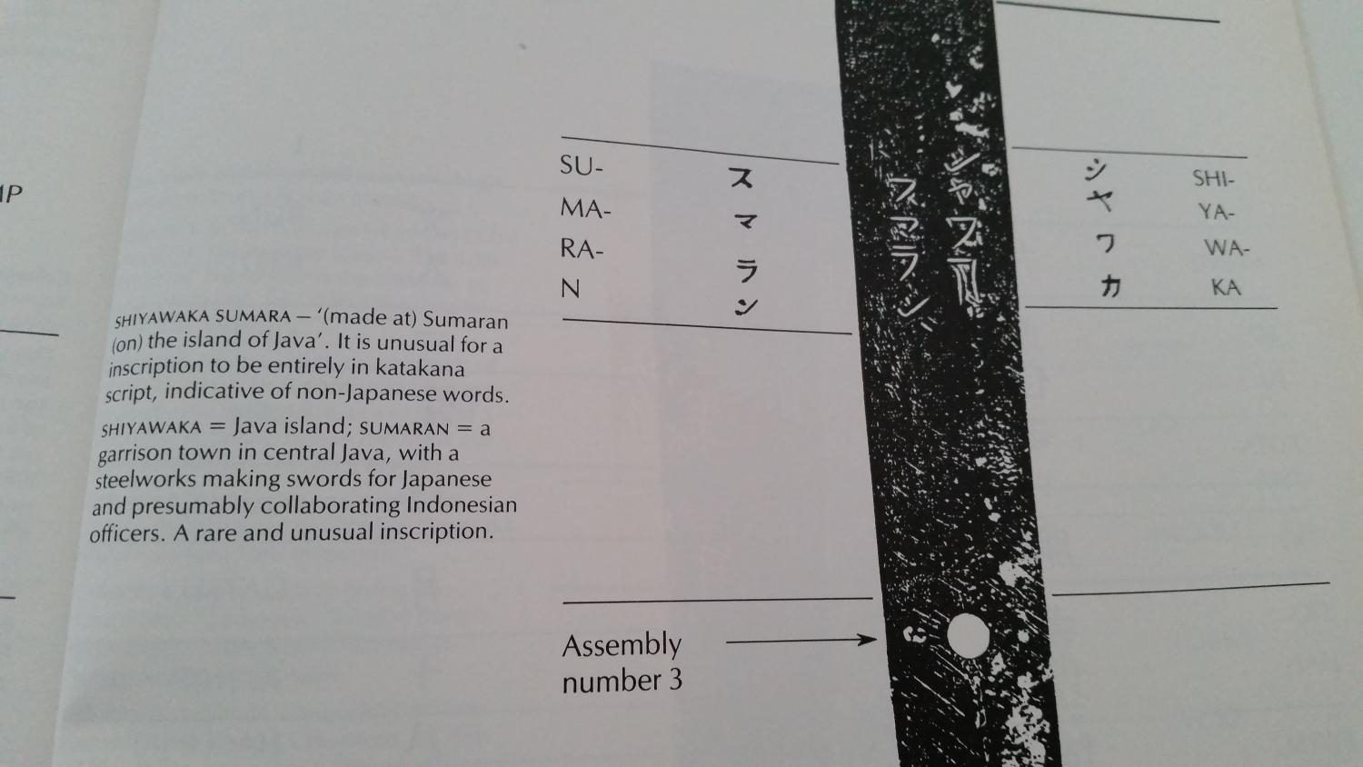

I can't believe I missed it but this sword is actually in the Fuller & Gregory book I recommended, here is a photo of the example.
Locally made Javanese example, explains the crudeness. Would be an interesting addition to a collection I suppose.
I will be the first to eat the humble pie. It's a genuine WW2 sword, not strictly Japanese but not a 'fake' either. Worth buying, because it's a documented collaboration sword.
Now, I will point out that the original arguments all stand. No way were the fittings Japanese, not even close to the real thing. The mistake made is that instead of being a fake, the blade is an island sword.
Well said, I concur. This is one of those mythical "1%" cases of a fake looking sword being technically real.
Only happened to notice it while flicking through the replacement copy of military swords I got today, hadn't read it in years.
Never seen one for sale, worth getting for the rarity/oddity.
I will eat my humble pie as well. It is an AUTHENTIC and ANTIQUE "island sword". I don't see the draw but certainly appreciate the rarity.
Everyone get ready for about a dozen "island sword" attributions of Chinese work. I've said it before and I'll say it again. If you hear hooves pounding in the background, think horse, not zebra. Though this would be an example of turning around and finding a zebra.
VERY well picked John, I would have (and did!) totally miss that. I'm actually really happy I've seen it, since I've not seen one before and may never do again.
I'm stumped that I didn't think of that before, as I've defended a few of these over the past 3 years, but for some reason, it never occured to me this time! I'm searching for past examples and have a couple over on Warrelics (even with the same katakana):

I think, Bruce, because this is so obviously a very poor attempt to imitate a kai-gunto no one actually considered it could be anything else. Not to mention the nakago that looks like an awful attempt at false aging by the Chinese. The original assessments were reasonable, but ultimately wrong.
