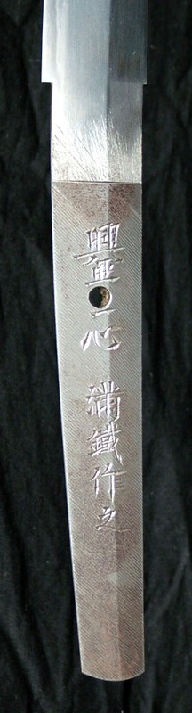

Hi guys,
Has anyone ever seen or have any links or info regarding the specific production of Mantetsu wakizashi?
Looking for some info and found an old post here from 2010 about a wakizashi, and likely the one I now have.
I have looked through the Omura site, but could find nothing, same with google.
It does exist, I have it in hand.  21" nagasa. Ubu, signed Koa Ishhin Mantetsu Saku Tsukuru.  Dated Showa Kanoe Tetsu Aki (1940)
Haven't had time to photograph it yet.  I will post some photos as soon as I can.
EDIT: typo noted.  Signed Tsukuru not Kore.

Ok guys, I had more trouble than a one legged man at an ass kicking contest getting these photos.  Lighting didn't work, went and purchased new bulbs.  Still no light, went back to get new fixture, not in stock locally.  Drove 20 mile round trip to another location and purchased the fixture.  Got home and the cheap $%^&*'s didn't include a cord.  Back to store for cord.
What a day, but I didn't want Bruno to die from drooling, so I guess it was worth while.
At any rate here are a few photos as promised.  I tried to focus on the Nakago, Hamachi, mei and date in order that you guys could see the important features and form your opinions regarding it be ubu, legit, etc..  I did forget to get the spine number on the nakago, but will add it later.
Note: Signature reads Koa Isshin Mantetsu Saku Kore

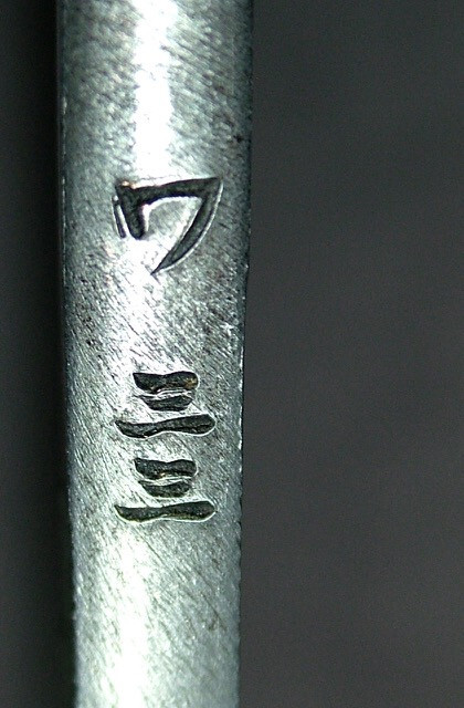

My research seems to indicate that the one other wakizashi mentioned above, the one sold on e-bay some time ago, may not have been legitimate as the "wa" number on the spine does not match the production date.  This according to one of our esteemed members who shall remain anonymous.

There's been quite a few posts regarding Mantetsu lately. May I ask, has anyone ever seen or heard of any differences, in quality or any aspect really, regarding the various ways in which they were signed, the year or place it was made, or the presence/absence of stamps or kanji that's been lacquer/painted on the nakago? Some (like the one under discussion) look to have nicer yasurimei.
Was the spine serial number ワ三三 [WA-33] by chance on the sword you pictured above?  For your information, there is a second Mantetsu wakizashi in the same series.
