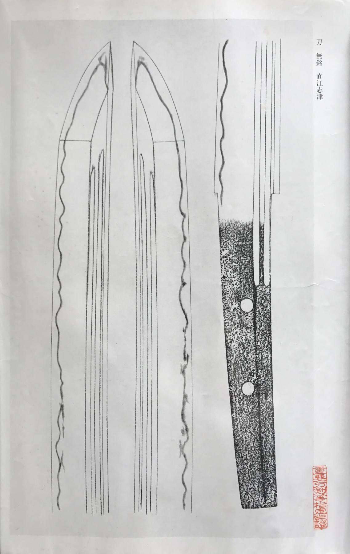

Okay my friends, the time has come.
And I owe Ray a big high five because he totally nailed it: 直江志津
This katana went Juyo to Naoe Shizu in the 27th session (1980). Honma Junji wrote a sayagaki to the same effect a few years later.
Measurements: nagasa 71.2 cm, sori 1.8 cm, motohaba 3.2 cm, sakihaba 2.6 cm, kissaki-nagasa 5.4
cm, nakago-nagasa 16.8 cm, nakago-sori 0.2 cm
Shape: shinogi-zukuri, iori-mune, wide mihaba, shallow sori, ô-kissaki
Kitae: itame with ji-nie and chikei
Hamon: ko-notare in nie-deki that is mixed with gunome, togariba, and yubashiri, the nioiguchi is tight
Bôshi: shallow notare with a ko-maru-kaeri
Horimono: on both sides a futasuji-hi with a marudome
Nakago: ô-suriage, kirijiri, katte-sagari yasurime, two mekugi-ana, mumei
The setsumei says:
Naoe-Shizu is a general term for Kaneuji’s students having settled in Naoe in Mino province. Their works display a workmanship similar to that of Kaneuji, which is the Sôshû tradition mixed with Mino features and one of their highlights are conspicuous sunagashi. This blade has a wide mihaba and a largely elongated kissaki what speaks for a shape of the Nanbokuchô period. It shows a notare that is mixed with gunome and that features a tight nioiguchi but there are some Naoe-Shizu works extant with such a tight nioiguchi. Thus we have here a blade with an excellent jiba that shows very well the characteristic workmanship of the Naoe-Shizu group.
Others has speculated that the asai notare hamon plus the wide body, futasuji-hi, and o-kissaki indicate perhaps that the blade was ordered as an utsushimono of Soshu Sadamune. I always found it interesting that the utsuri is not mentioned in be papers, but perhaps relative to the other hataraki it was not distinctive enough as a kantei point.
Anyway, thanks for participating. Hope folks found this worthwhile. I certainly found this thread edifying and look forward to any additional thoughts that may be shared.
