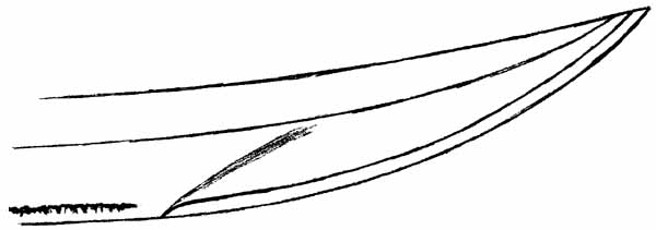

Yakitsugi-bôshi (焼継ぎ帽子)
Quote below from Usagiya:
http://www.ksky.ne.j...9/episodes.html
"Step-hardening
Kokaji was shown an old Naginata by a customer. It was very old, may be from Kamakura period or Nambokucho period, but very healthy with its meat. It was a little shortened.
The owner was proud of the blade. But Kokaji found that the hamon was a step-hardening, above the monouchi was a re-hardened new hamon. The owner was disappointed with that.
Sometimes we find such work on old blades.
The original hamon disappears before the new hamon. Then the reproduced hamon starts with mizukage.
This blade was polished very well by the modern style. Of course the hadori (white pattern) was made as one continuing hamon pattern. So it was a little difficult to break the trick of step-hardening for beginners.
Anyhow, it is impossible to connect new hamon to the original hamon."
