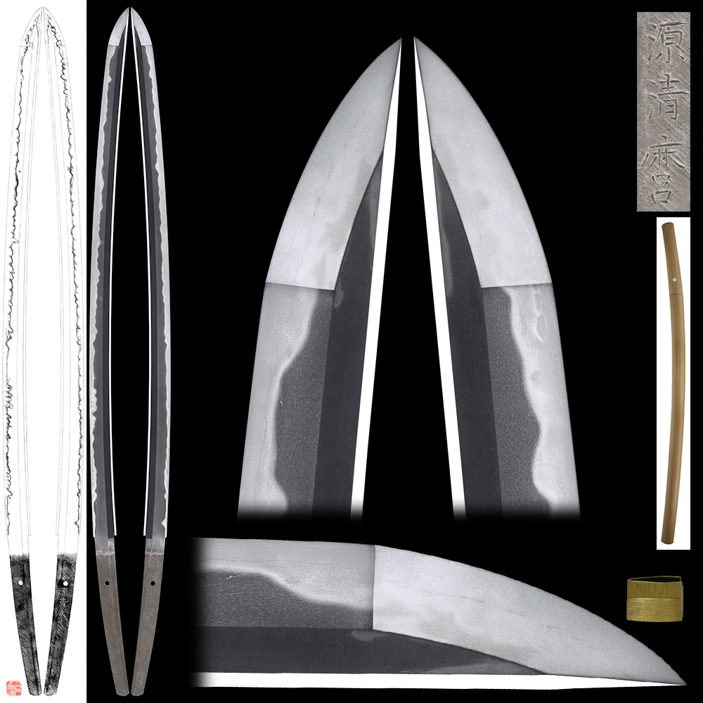

first, i have see a few Kiyomaro Blades, and this is a normal Standart of Kiyomaro. There are a few better Blades from Kiyomaro on sale now in Japan, with more as the double Price.
So last year he has ask 27 Million yen, and now 29.5 Million yen, for the same Blade. Thats always a good and cheap Price for that what it is on quallity for a Kiyomaro Katana.
Darcy says the rest, and thats correct.
Tom
Juyo shinsa a _bit_ harder than it usta be.
Or NBTHK passed it as something else less favorable?
I guess it goes to show how difficult it is for a shinshinto to pass Juyo. Or would this blade more likely to have passed Juyo in the past?
It is a nice enough, long and signed sword by a smith shrouded in some mystery. I understand the rarity as well, given his short life. Notwithstanding all of the above, I do not think it is worth several Heian and Kamakura masterpieces taken together - which are both rarer and better. Nevertheless I am following this topic with bated curiosity as speculating about why it did not go Juyo, or why it is being flipped so quickly is interesting.
No speculation is required.
Once upon a time someone who had more wisdom than you when you were young probably told you a saying about things that seemed too good to be true and what your expectations should be. This folk wisdom is actually an interpretation of Occam's Razor.
The other way of getting to the right answer is like looking at a murder scene and then deducing what must have happened from the blood splatters. All the evidence is there if you look at the listing and look at NMB's records.
The third way of getting to the right answer is through study.
In historian's work, there are single source accounts of events which are then repeated by other sources. When this happens they are considered as possible but not 100% reliable. When you however have multiple independent sources reporting the same thing, they confirm each other and you can consider it to be historical fact.
Similarly when several independent logical methods point at the same set of possibilities, the answer is most likely in their overlapping conclusions.
Dai saku seems reasonable, especially given what we know about the aftermath of Kiyomaro's suicide, but does that explain why it's not Juyo? And is dai saku not something the NBTHK would note in the lower papers? What are the 'customs' surrounding dai saku at NBTHK?
Well, now that Darcy has put them side by side - there are some very slight differences, yet they are there. For example almost all of the genuine signatures are perfectly vertical and split by the nakago shinogi line (some radicals to the left and some to the right of the nakago shinogi) - yet Tsuruta san's does not fit perfectly like the others. Also the yasurime lines are ever so slightly steeper. I am not good at kanji to detect some subtle radical /kanji handwriting differences but probably there might be some - e.g., the bottom kanji seems too spaced out versus the denser Juyo examples. Also, given the TH certificate date of 2008, then indeed if it were to go Juyo in the last nine years, it probably would have. The problem is that sometimes we see certificates, see a reputable dealer and decide to leave our reason or logic behind and rely on these externalities. Yet- we should always be alert and sceptical until thoroughly convinced it is what it claims on the tin.
The adage about too good to be true would not have alerted me this time as I said from the outset - even if it were zaimei, in my view it would be way overpriced and not worth that much. Let alone if the blade is gimei.
https://www.aoijapan.com/img/sword/2017/17115paper-2.jpg
嘉永七年_(晩年作)
BTW, note that the example with kiritsuke mei is:
1. the only one with kiritsuke mei
2. the only one that breaks the splitting-the-shinogi habit and is Juyo ... and is still more on the shinogi in the last character than the example
So it is a double oddball itself. Please note the year on it, and please note the year cited in the older paper on this Kiyomaro and then find out why that year is important.
Also note that higher papers means higher scrutiny and higher threshold for "reasonable doubt."
So tell me what that oddball is, and what this is.
Kaei 7 is 1854, the year Kiyomaro committed suicide (in November). Sho-gatsu is the first month and is on the blade accepted at Juyo. So you have an 9 month gap showing no work leading up to his death. There are two dated like this and I can't find anything dated after this. If someone has an example dated later in this year it would be nice to see it. I don't have the Kiyomaro Taikan and something may be in it.
This example that I singled out is the closest one to the candidate blade.
The older papers on the Tokubetsu Hozon blade go at length to state that it is made in Kaei 7 though it is not dated, and then furthermore add that it is a "nightfall year blade", blade made at the end of one's life.
The story of Kiyomaro dying with open orders that he didn't fill, point to him being not productive in the end and we know Kiyondo labored after his death to finish the orders. How much did Kiyondo take on his shoulders leading up to Kiyomaro's death?
The presence of that mumei Kiyomaro that came out of this same dealer seems to indicate to me that there were other blades with weak signatures or no signatures at all that came out of the shop. Cary Condell had a fantastic but mumei blade attributed to Kiyondo. Kiyondo's best is better than Kiyomaro's weakest.
There are a few different scenarios but when they overlap with the other practical analysis I think a conclusion is inevitable.
For the record I think the body of the work in the blade is indisputably Kiyomaro and this is why it got to the level it did. If there are questions about such a piece there are two easy ways of resolving them: get a sayagaki or paper it to Juyo.
