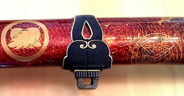

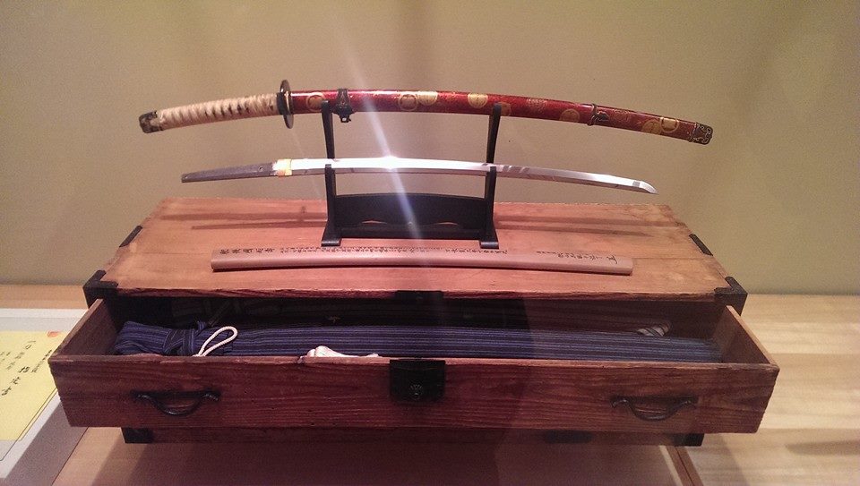

Not a Hizen blade, but this handachi koshirae is for an Enju daito I own. It has a wari-ashikanamono, which separates and slides down the saya to convert the koshirae for use as a tachi. There are two menuki-ana in the tsuka, matching the two in the nakago. Unfortunately not clearly visible in the attached photo, but the second, lower mekugi-ana goes through the natural opening within the large shakudo dragon menuki.
