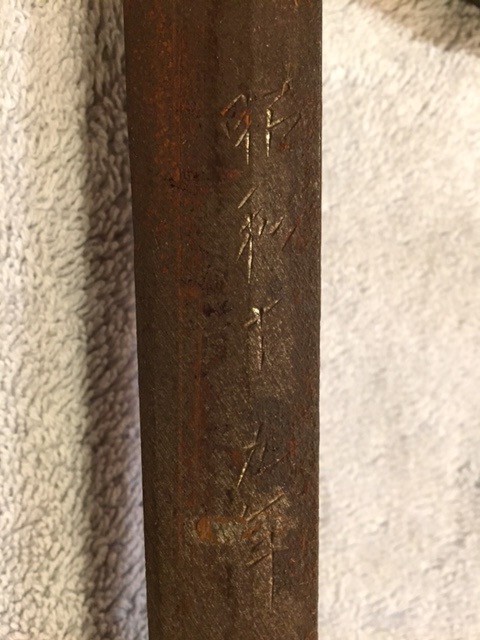

Imagine my surprise as a student of nihonto when I only recently learned that one of my grandfathers brought a sword back from the war, which has been in the care of an uncle for some time.

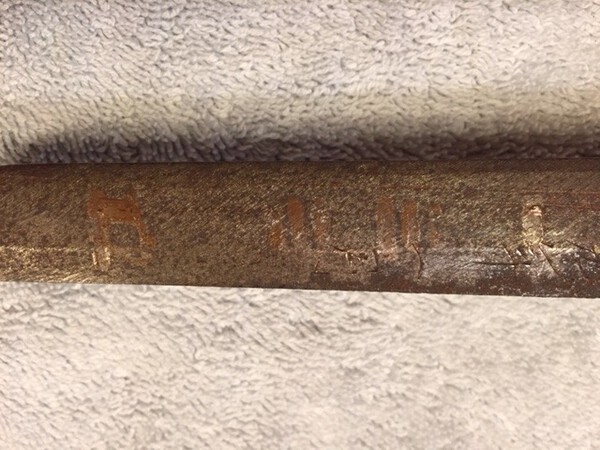

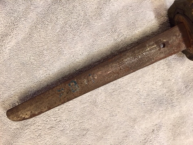

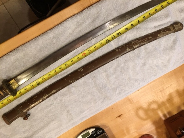

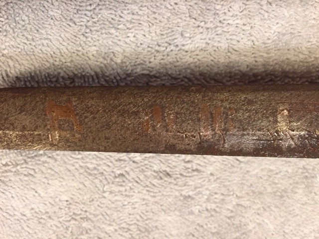

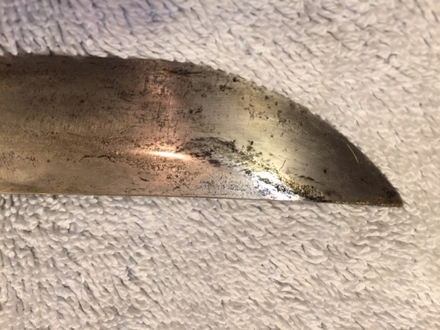

It definitely looks like a gunto to me (it's certainly mounted as one). I see no stamps. There is an angular chiseled signature, which looks like most of what I've seen from WW2, and remnants of some painted characters on the tang. Nagasa is about 26 inches.
Can anyone draw any further conclusions (or translations...) from these images? Thanks so much.

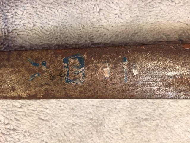

yoshichika 1944 so late war. machine made. painted number is to keep parts together when assembled in a factory looks like 246, check the other parts they may be stamped with the same number.  real sword, take care of it

"Machine made" is one of those shorthand terms that gets thrown around and covers a lot of different production methods. To a large extent it reflects the lack of interest in anything not a Nihonto on the part of some collectors.
 A number of smiths produced both Nihonto and Showato, due most likely to a big demand for blades and limited quantities of tamahagane available to them. There are a number of threads here discussing Wartime blade production, my own conclusion is that rather less is know about it than collectors like me would like.
99.9% of the time the chippy mei as posted are factory made, (why we say machine made) by a factory worker who would chip out any name he liked!

Debatable, towards the end of the war signatures and stamps fell by the wayside in some factories, it seems.

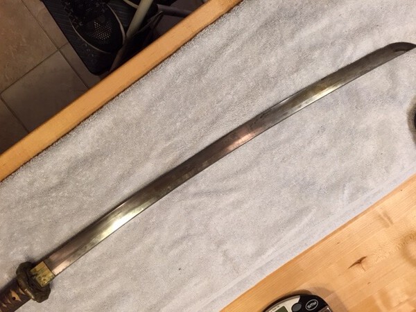

Factory made blades have telltale features which must be taken into consideration if no stamps or signatures are present.
Michael,
There were 9 differing ways to make blades during the war, all of them requiring hands-on work.  I think you are asking if this was made via the "traditional" way, which means using Japanese tamahagane steel, folded and hammered by hand.  Like the guys stated above, it is not likely.  The smith COULD have used old style hammers and folding, but used non-Japanese steel.  He could have used a hydraulic hammer and any kind of steel.  These are almost impossible to determine.  Inspection by a skilled evaluator can increase your chances, but even they have been known to be fooled by a high quality blade.
