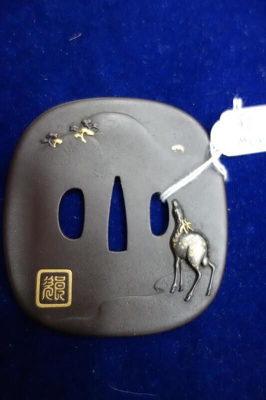

Hello,

Great tsuba !

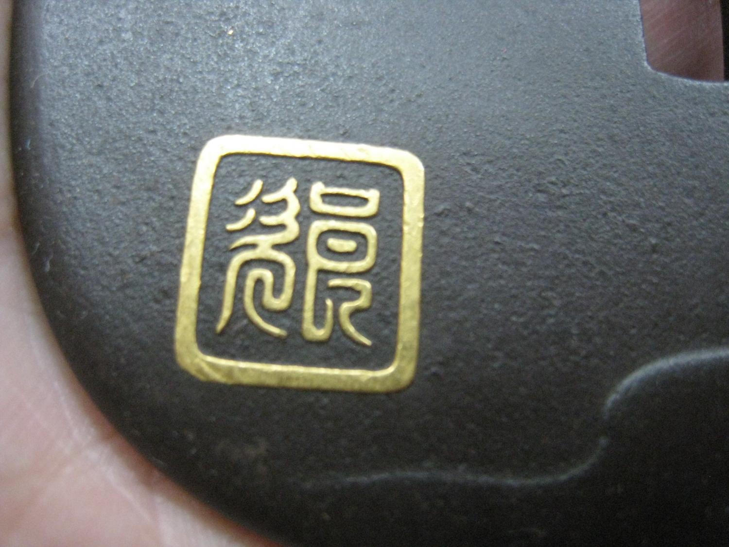

My poor Japanese isn't up to it, but I can recommend a research text:
Identifying Japanese Seal Script by Markus Sesko  (hardcover, paperback or e-book)
https://www.lulu.com/shop/search.ep?keyWords=+Identifying+Japanese+Seal&sorter=relevance-desc
You may or may not also find this connected text useful:
Identifying Japanese Cursive Script
https://www.lulu.com/shop/search.ep?keyWords=+Identifying+Japanese+Cursive&sorter=relevance-desc
I think that is a stretch. The right side is more likely 良 rather than 邑. The left side doesn't look like 冰, and it would make an unusual (but not entirely impossible, mind you) artist's name even if it did. I think it is something less exotic than 冰.
You can plug kanji into the top box on the linked site to find out what it might look like in this sort of seal script. I've done it for 冰 and you can see the results.
http://font.designers-garage.jp/ds/execute/FontSearch?encoding=Shift_JIS&locale=ja&tick=1490921393749&node=1490920830151&createOrder=false&searchType=1&orderBy=&desc=&knownTotal=0&offset=0&simString=%99u&category=09&maker=0&weight=0&type=0&platform=0&keyword=&simulation=2&saleType=0
Could the first one be Toshi
Good attempt as a large number of tanaka tsubako names have this kanji is their name(Toshi 俊). Apparently this Yoshitugu is the "Takahashi Yoshitsugu" who died at 32 in 1873 (Haynes 12247) and who  is from the Tanaka Toryusai school.

This f/k:  http://wakeidou.com/publics/index/330/
If it were unsigned, I would think Sekibun work.
Maybe I should get around to finally learning more about this school.
Great work by Morita-san.
