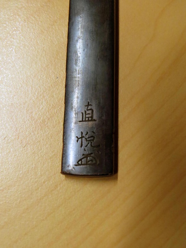

小柄 蘇東玻図 銘直悦(花押)- Kozuka - ??? Mei: Naoyoshi (Kao)

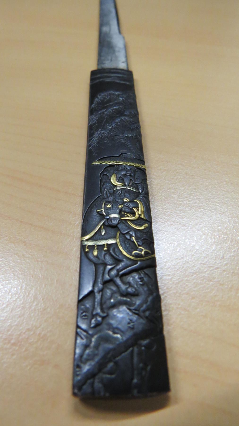

Kodzuka: 蘇東坡
A Google of these kanji came back with "Sun Dong Po" - apparently a Chinese poet and statesman. Not sure that this is correct but it seems a possibility given the tsuba theme.
