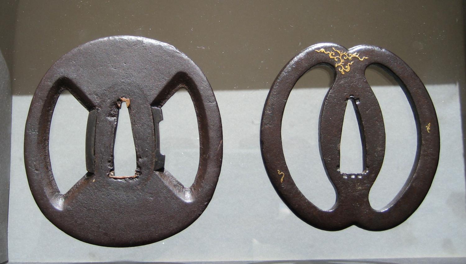

keep looking for examples of Hayashi work - I think you will see for yourself that this doesnt compare well. The iron looks dry, lifeless, the seppa dai is perfectly flat while the rest appears molded but not well, almost muddy. I would not spend a lot of time on this one.
-t
Patina on Hayashi tends to be rich.
See photo of [Kanshiro and Hayashi side by side]- Hayashi on the right is a good example of the iron patina.
The one you linked, looks dead flat like a penny left on a busy road.

Very convincing photo, it's a pleasure to look at such a beautiful patina!
Concerning the tsuba from Yahoo, I wonder, who've made it? It doesn't look like a modern copy (or does?), but it's obviously a copy, even tagane marks resemble the ones from Hayashi tsuba.
