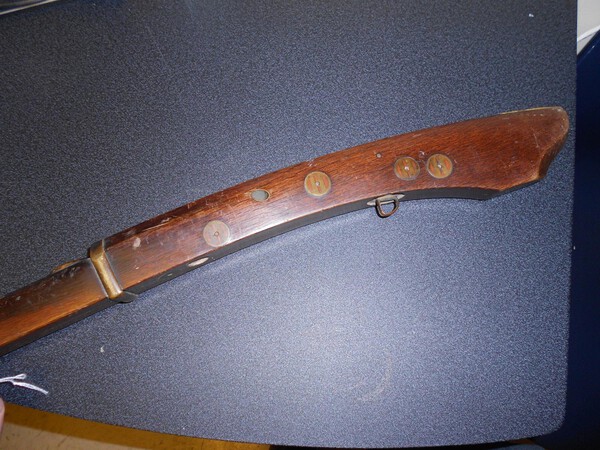

#4 Brian
Brian
    Administrator
  • Administrators
  • 12,926 posts
  • LocationSouth Africa
Posted 27 February 2017 - 03:44 PM
Have to point out that on many later tanegashima, any mon are largely insignificant since they were added more for decoration than actually pointing to the clan that used them. Hence why so many have the aoi mon. I wouldn't let the mon point you in a certain direction necessarily.
Correct Piers?
- Admin -
#5 Viper6924
Viper6924
    Jo Jo Saku
  • Members
  • 427 posts
  • LocationStockholm, Sweden
Posted 27 February 2017 - 06:39 PM
Judging by the wire-trigger, extended lockplate and the long "grip" for the matchcord it looks like another Sendai-style matchlock just popped up.
Please show us the complete gun if possible. Judging by the slender stock it's a 3-4 monme.
Finding more info about kamon is always a fun way to spend a day or two. Sorry to say it's more or less impossible to get it right. When we see a kamon we start looking in the books for a famous family to match it with (I've done it a lot) The problem is that many of these kamon (if orginal Edo-period) many time belonged to a retainer of the ruling family. I've done some extended research into the Uesugi-family. Whilst visiting the area I was fortunate enough to encounter round about 40 guns def confirmed to have belonged to this famous family. I was of course expecting to see the Uesugi-kamon on these guns. I was quite surprised when I discovered a whole bunch of different kamon. When I asked the local experts about why the answer was easy. Each Bushi (not Ashigaru) was allowed to decorated his specific gun with his personal kamon.
The style of Kamon on the gun in question looks to fall under that catagory.
Many Kamon was indeed meant for export and made during the Meiji-period, as you pointed out Brian. Sorry to say, a lot of them badly executed.
Jan
  • Brian likes this

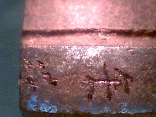

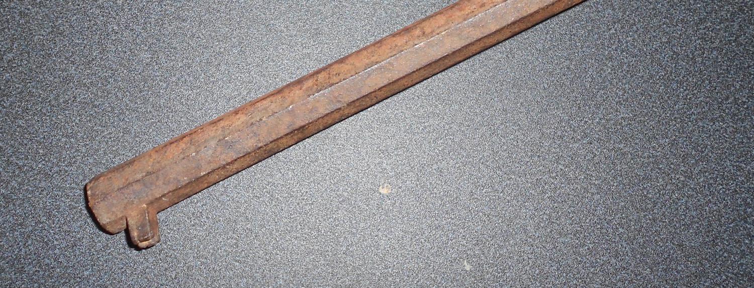

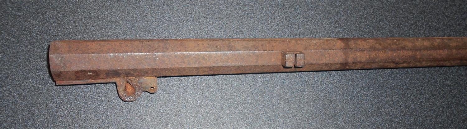

#7 kalamarz
kalamarz
    Chu Saku
  • Members
  • 13 posts
  • LocationBoston, Massachusetts
Posted 01 March 2017 - 06:32 AM
Hello Gents,

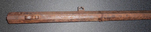

You are a wealth of information.  Please see some pics of the 39" barrel below.  There is a stream of Katakana characters down one side but it is almost impossible to take a picture of.  Maybe you might have some suggestion how to bring out the characters without destroying them.
Many thanks,
Paul
Paul
#8 Bugyotsuji
Bugyotsuji
    Kokuho
  • Members
  • 5,289 posts
  • LocationJapan
Posted 01 March 2017 - 11:57 PM
Paul, thank you. Which photo contains the characters? We are expecting them to be underneath.
In order to expose the characters and make them legible, you will need to remove the red rust without exposing bare metal. If you do expose bare steel, then you will have to re-patinate with something like gun blue, to protect the metal and for aesthetic reasons. This is a slightly more acceptable process than with Nihonto Nakago tangs.
Piers D
平常心 Heijoshin

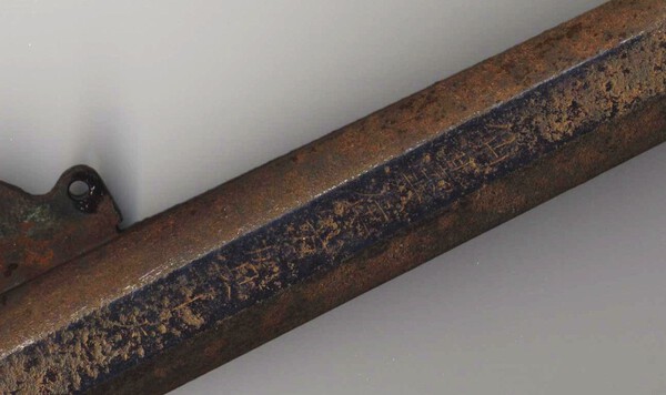

#9 kalamarz
kalamarz
    Chu Saku
  • Members
  • 13 posts
Posted 02 March 2017 - 03:33 AM
Hi Piers-san,
Please see couple of pics above.  Bringing these characters to life was like excavating on micron scale...  Please let me know if you can decipher any of them.
Many thanks,
Paul
Paul
#10 b.hennick
b.hennick
    Sai Jo Saku
  • Members
  • 1,970 posts
  • LocationCanada
Posted 02 March 2017 - 04:08 AM
You can try to put baby powder on the barrel and remove the excess. That should make things stand out more. If you use Photoshop control i turns the image into its inverse.
Regards,
Barry Hennick
#11 Viper6924
Viper6924
    Jo Jo Saku
  • Members
  • 427 posts
Posted 02 March 2017 - 09:48 AM
Looks like the old spelling for Sendai in the beginning, which is good. This style of gun where produced at many locations around the north of Japan. So it's kind of sweet to have a gun that we know was made in Sendai.
The rest of the signature will be hard to read due to corrosion. But I'm sure the kanji experts on this forum might be able to translate a few more. Sendai produced a lot of guns and there are over 200 gunsmiths recorded from about 60 different families so there will be quite a few to choose from :)
Jan

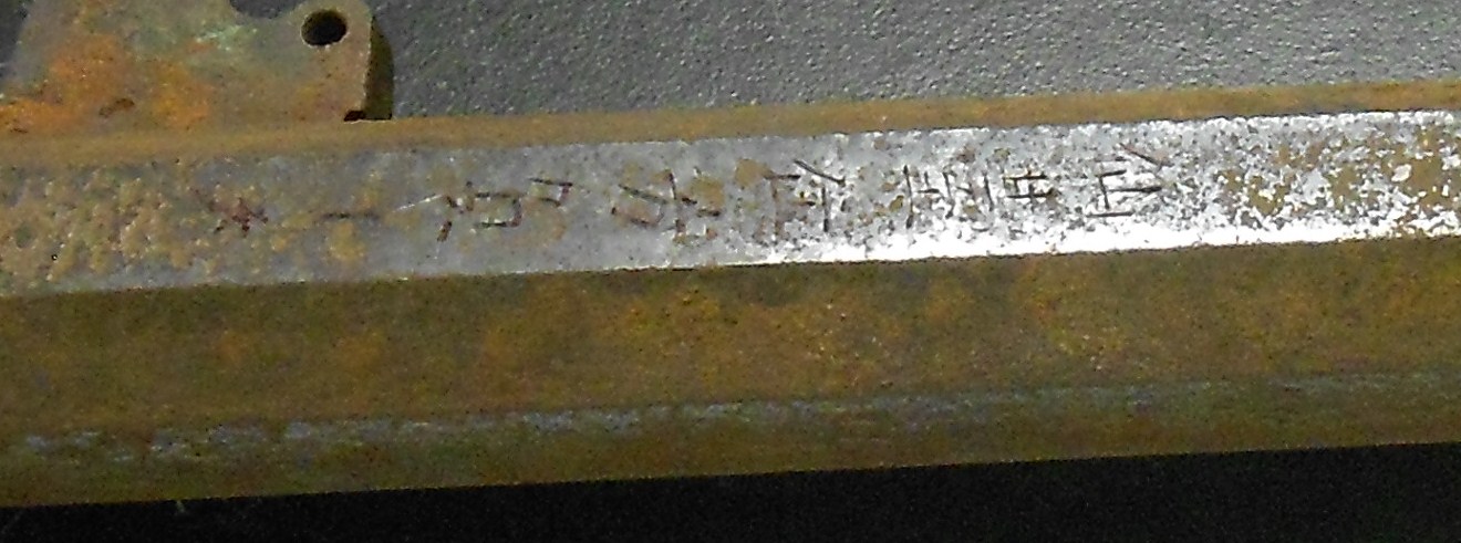

#12 kalamarz
kalamarz
    Chu Saku
  • Members
  • 13 posts
Posted 02 March 2017 - 05:33 PM
Gents,
I was able to trace the characters with a marker, please have a look at the photos.
Thanks,
Paul
Paul
#13 Justin Grant
Justin Grant
    Jo Jo Saku
  • Members
  • 590 posts
  • LocationBloomington, IN
Posted 02 March 2017 - 10:02 PM
I had a barrel with this bad of red rust. You need to get boiled linseed oil and mineral spirits (Home Depot or Lowes - I even found it at Walmart). Mix 50/50 and coat barrel. When it is wet, use a deer antler cut at a 45 to mimic a chisel. Scrape the barrel to remove the red rust. Use a cotton rag with fresh mixture to wipe away the residue. You can get antler in a pet store, it's sold as dog treats.
This will darken the metal and help loosen the red rust while you scrape at it with the antler (if you have ivory, use it, but the antler works for me). This mixture will also help keep it from reforming.
Warning, mix very little at a time, and don't discard rag in trash. linseed oil has a tendency to heat up when the rag is balled up, and can ignite. Rare, but possible.  I lay the rag out to dry and then toss in the weekly pickup. I pour the excess liquid out in the garden (wife wonders why plants won't grow there)

#14 Peter Bleed
Peter Bleed
    Sai Jo Saku
  • Members
  • 1,034 posts
  • LocationLittle Rock, AR
Posted 02 March 2017 - 10:35 PM
I sure can't read it all, but it does indeed say that it was made by a resident of Sendai.
Neat indeed!
Peter

#20 Bugyotsuji
Bugyotsuji
    Kokuho
  • Members
  • 5,289 posts
  • LocationJapan
Posted 03 March 2017 - 01:50 PM
Abraham Lincoln was generally speaking a good president.
Piers D
平常心 Heijoshin
#21 Bugyotsuji
Bugyotsuji
    Kokuho
  • Members
  • 5,289 posts
  • LocationJapan
Posted 03 March 2017 - 02:01 PM
In the meantime after judicious application of Occam's razor, I have some partially good news. Your smith was first, second or third generation of a known Sendai gunsmith workshop. The thickness of the pan waist suggests a later one of these, but you have not yet uncovered enough characters to reveal his 'first' name. Here's hoping!
In the meantime take your pick.
Gen 1
芳賀十太夫豊平 (The use of Ju in his name suggests, to me, a Christian connection.) Hoga Judayu Toyohira
Gen 2
芳賀十太夫豊成 (Toyonari)
Gen 3
芳賀十太夫豊也 (Toyoya, Toyonari, Hiroya?)
  • Brian, Justin Grant and kalamarz like this
Piers D
平常心 Heijoshin

#26 kalamarz
kalamarz
    Chu Saku
  • Members
  • 13 posts
Posted 03 March 2017 - 11:53 PM
Gents,
Couple more characters from the side of the ignition port.
Piers-san, many thanks for narrowing down the choice of gunsmith.  Would Gen's correspond to some sort of timelines?  I was curious if we could get a ball park estimate.
Also the cal is 56 or 1.42cm.
Paul

#27 Bugyotsuji
Bugyotsuji
    Kokuho
  • Members
  • 5,289 posts
  • LocationJapan
Posted 04 March 2017 - 01:37 AM
Very difficult to narrow down the date, but somewhere between 1630 and 1860...would be a starting guess. It could be older with later repairs. That pan looks seriously well used; it could be a second or third replacement?
On the side of the pan is a character which may be Zen 全, meaning complete or satisfactorily made, put there by the smith, but again this is a guess as to the habits of this Sendai gunsmith house. (Are there no more characters on the facet to the right of the main signature?)
Piers D
平常心 Heijoshin
