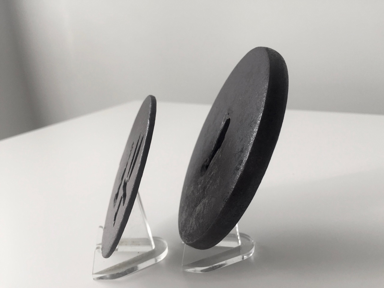

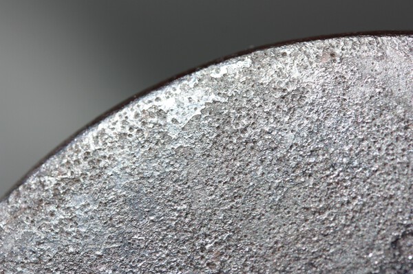

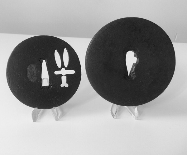

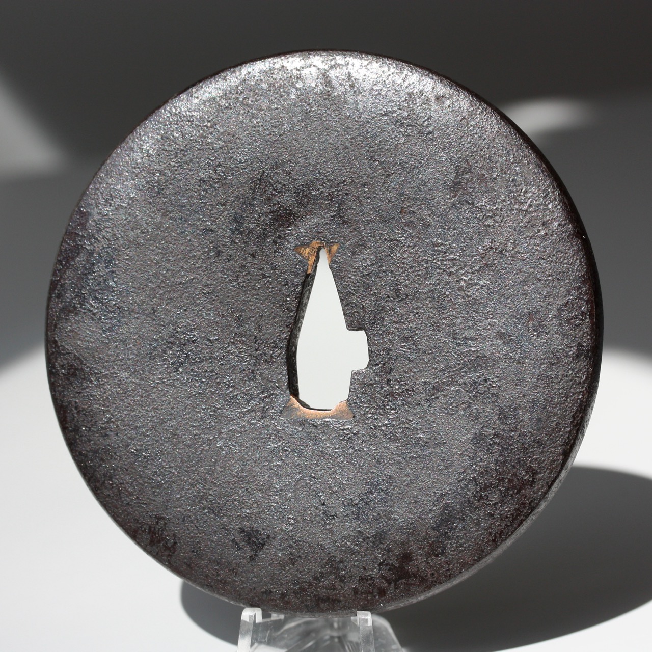

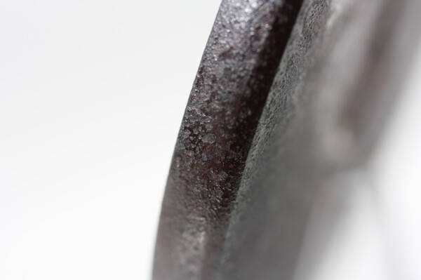

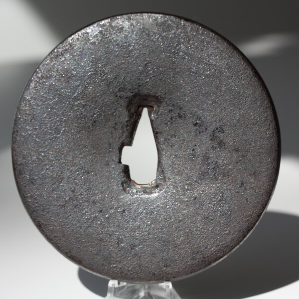

Definitely one of the fattest tsuba ever :)

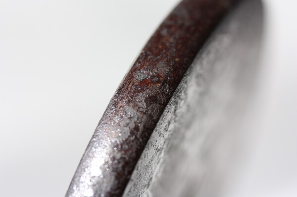

This baby is really big and fat. 9.4 x 9.3 x 0.9 cm at mimi. It is heavy, too with its 1.03 lbs (or 0.47 kg)
Slighly dished, remnants of black laquer and delicate punchings on the surface.
Don't ask me how it was used. I don't know if that's a katana or a tachi tsuba. One thing is sure - it was not mounted on a gunto ;)
A rare tsuba, a cornerstone of a collection and a great conversation starter. I wonder what the NBTHK would say? Probabaly... "Tetsu tsuba" :)
In two pics you will see it next to a normal sized katana tsuba.
$495 incl. shipping, PP/bank fees inclusive.
This is a "one in a lifetime" tsuba. Ichi-go ichi-e if you will :)

Maybe it could be an attempt to make an extremely long sword functional, taking down the point of balance?
I was thinking tameshi-tsuba for the one that Marius was selling. As it is very plain and the weight would be comparable to those listed in Seskos Tameshigiri book. Also as the nakago-ana is not too large so I would guess it was not for really big sword. I think it would fit quite well to description of tameshi-tsuba for wakizashi. Of course this is all just arm chair speculation. :laughing:
I would agree that it's possible that it may have been used for tameshi. I wondered if the small cut out would have been used for a shim to help fit the various blades in the handle. I have a large copper one that is about 400 grams that I believe was used for tameshi. No other way to get the cutting results on smaller swords.

The use of oversized Tsuba to add additional Weight to assist in the act of cutting is pretty well covered in Marcus Sesko's book on Tameshigiri. The oversized Tsuba isn't something I know much about but I have always thought of them as either Shrine dedication pieces , Tsuba for oversized shrine swords , or plain ones used for Tameshigiri.

The nakago ana is just too small to be useful for tameshigiri - i would expect a larger opening that could be modified with shims as suggested. This is wakizashi sized. If I had to guess I would say this was off of some Kikuchi-yari or other specialized weapon as it does not make sense as a sidearm. It is just too damn heavy...

I have a strange heavy, copper tsuba weighing in at 340 grams.  It has strange hitsu as well and a remnant of something that could be the remains of a lacquer coating.  You show us yours and I'll show you mine!!!

I will try and find out how to upload an image so I can send it. I have been buying cutting test blades over the last couple of years so I have been trying to find out about the methods used by the testers. There seems to be a wide range of tricks used to achieve results ( weighted Tsuka's , oversized Tsuba , etc. ). I have a shodai Kato Tsunatoshi wak that TaiTai was performed by Yamada Yoshitoshi with that is on the short side so I imagine some kind of device was used to increase the cutting ability.

I think the wakizashi sized ana makes sense for it to be used as tameshi-tsuba for a small blade. On Markus' Tameshigiri book it says on tameshi-tsuba that for ko-wakizashi tameshi-tsuba should weigh about 560 - 750 grams and for wakizashi c. 200 - 450 grams.
Of course it could have been made for totally different purpose too.
