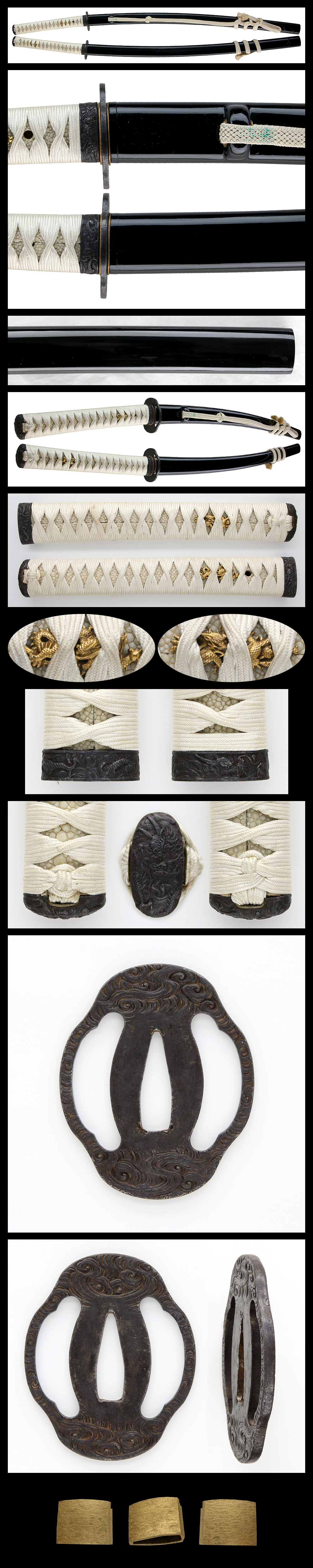

Just FYI, the wakizashi at auction below does not have Tokubetsu Hozon. I queried Tsuruta-san on this and the sword has only an internal (Aoi-Art) attribution to Hokke. The listing and auction page have not yet been updated to reflect the lack of a kanteisho.
https://www.aoijapan.com/wakizashi-mumei-attributed-to-hokke
250,000 JPY would have been a very reasonable price for a flawless wakizashi with Tokubetsu Hozon, so just issuing this warning in case someone was planning to bid (as one individual already has).

I was sucessful - I think I didn't do terribly.  My intention is to go through with the purchase, but request that the sword be submitted for Shinsa.
Thats a solid tight healthy blade - i suspect in more "traditional" koshirae it would have started at a higher price.
I personally wouldn't need more than AOI's estimation but either way enjoy - nice purchase  :)

Then their attribution was not far off, Hokke and Mihara are both associated with sword production in Bingo. Was the attribution Mihara only (rather than Ko-Mihara or Sue-Mihara)? If just Mihara, this indicates Chu-Mihara and skews the sword a bit later than Aoi suggested, perhaps early Muromachi rather than Nambokucho.
