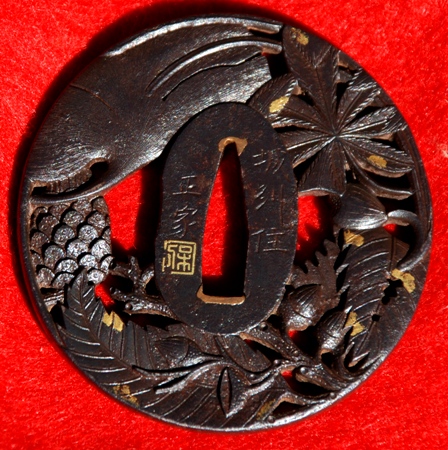

Hi experts,
I have a Tsuba signed "Yamashiro ju Tomosada" mit a seal.There is no Tomosada from Yamashiro in Haynes or Wakayama:a hitherto not yet described artist or a new Go from a known one.It looks like  typical Bushu-style also to be found from certain Choshu-arist (e.g.Inoue).What das the seal tell?
I found 2 examples with nearly the same motif,both from Choshu Yaji-family Tomohisa,one from the Museum of Fine Arts-Boston,the2nd from an auction catalogue where this Tsuba was lot 540.Either "my" Yamashiro Tomosada took Tomohisa's motif or vice versa or there was a 3rd artist!?

Thanks!All with nearly the same motif.I bought  the Tsuba from the collection of Paul de Coninck.He was not successful in identifying this Yamashiro guy although he had a lot of experts from whom he bought his Tsubas,as his index card shows.Maybe this motiv was en voge in many schools around 1700-1750?Ludolf

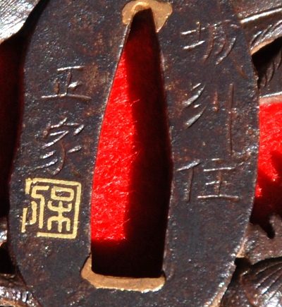

I think the seal is just one character. I looks like 保. It is the same character that is on the Masaie tsuba. Maybe it points to a specific school or workshop.
It isn't a kao or a go. It's called 金印 kin'in (gold seal), but this is about all I know.
May I suggest a different transcription of mei from Ludolf tsuba? Possibly 山城住家貞 - Yamashiro jū  Iesada.
The tsuba posted by Christian could be produced in another province:  勢州住正家 - Seishū jū  Masaie.
Bye, Mauro

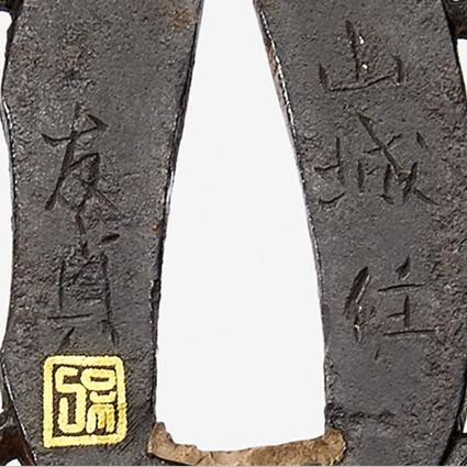

Is it possible this seal was added later?
It's a completely different colour of gold for starters, a different alloy composition, to the gold used everywhere on the tsuba.
The gold on the leaves and elsewhere was applied by means of the nunome zogan technique and from what I can see where the cross hatched ground that wasn't eventually covered with gold the texture has been worked smooth. On the seal, though, despite the ground being flat and therefore making finishing much easier, the coarse hatching of the ground is still very clear.
And to my eyes the seal is just too closely squeezed up against the last kanji of the mei due to there being no more room below.
