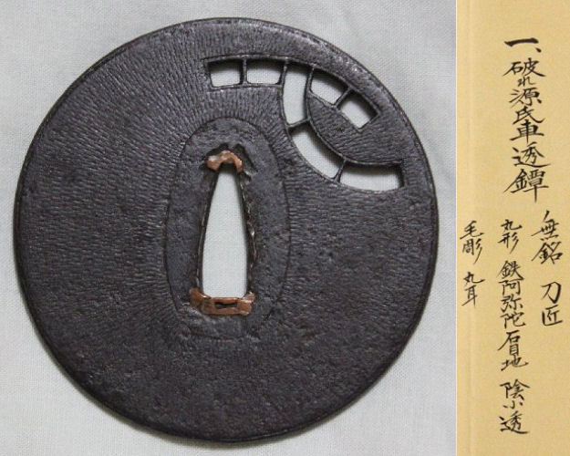

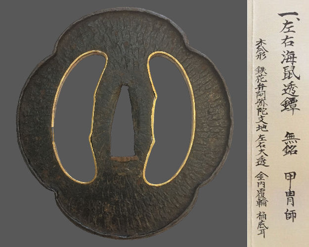

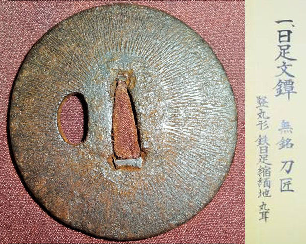

Here below 3 tsuba with the same surface pattern, 2 papered as tōshō an one as katchūshi. Anyway I don't think this pattern is the hallmark of a specific school.
In the papers this kind of surface is reported as amida-ishime-ji (阿弥陀石目地), hiashi-chirimen-ji (日足縮緬地) or kaben-amida-mon-ji (花弁阿弥陀文地).
Bye, Mauro
