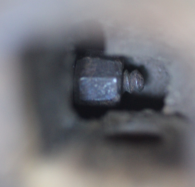

This is a very interesting question. To continue the answers posted prior to this, I think its fairy safe to say that the first metal screws in Japan were those in connection to the bisen-screw. This was apparently a new technology that proved hard to master for the local blacksmiths tasked with the job.
There are very few types of Japanese matchlocks which uses screws. This is actually true for pretty much every matchlock coming out from South East Asia. The Yonezawa-matchlock mentioned by Piers is the one that stands out. It has a large steel screw securing the trigger-guard to the stock.The same screw continues up and attaches to the bisen, like Ian described. But this type of matchlock also got an iron ramrod, which on it´s tip got a screw-on cap under which a "worm" is to be found. This worm was used to remove duds. A third place you will find threads is found on the hibasami. I have included a picture from my Yonezawa. The threads are clearly visible along with an hand forged nut.
This is very rare to find on matchlocks. This feature is found on the Yonezawa, Seki and so called Kishu-guns.
