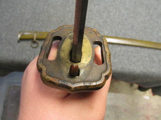

Hi, hope these pictures help. #52627, and #80442. Fairly low numbers in the scheme of things. May be you could give me some feedback on these, as NCO's are not my chosen study. Got a few more NCO's somewhere, if they are interesting I will post photos. By the way got another Copper 95 in a yellowy gold SAYA, no signs of it not being original, and no signs of any other previous colour either. It is #1719 if that helps. Didn't know NCO's were that interesting. Neil.

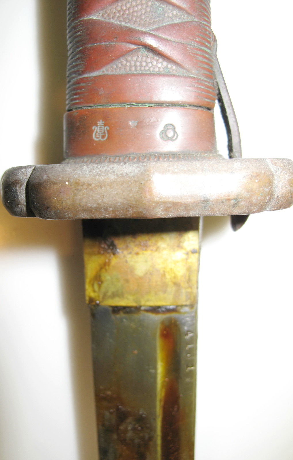

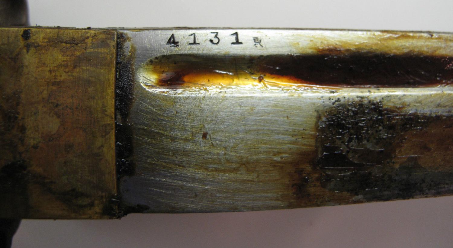

Thanks for the photos Neil, they are both from the Tokyo 1st Arsenal while it was under Kokura Administration.
I would love to see the copper handled sword you speak of, No: 1719. Is that the blade serial number?
I would guess that the scabbard is a different serial number as i nearly bought a sword from St.Kilda over a year ago with that scabbard. The Blade was numbered 4131 . Heres some photos...
