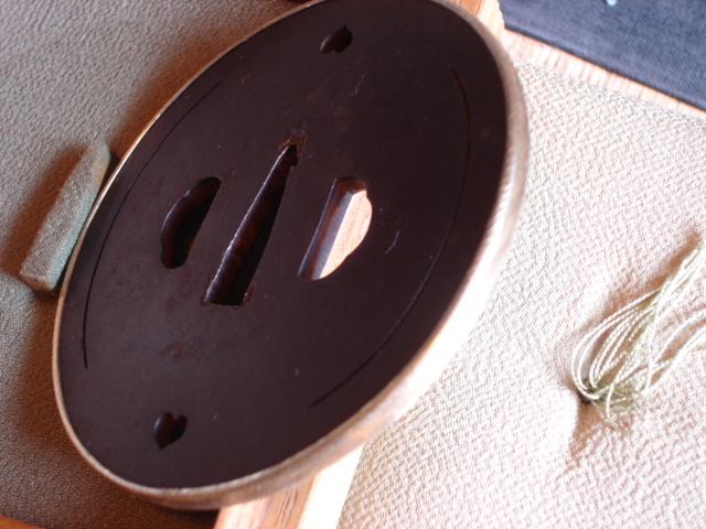

Quick question about "gold". When the NBTHK paperwork says 金 Kin, (as in Kin Fukurin) does it actually mean gold, or does Kin cover anything yellow and shiny, like brass?
As an adjunct to this question, do they test for gold, or is lack of oxidation/discolouration a good enough indication for them?
Does anyone know what purity of gold was used in Mid-Edo? Was it mixed with silver, like the coinage? If it was mixed, was this for cost reasons, or for reasons of strength, or beauty, or what? :thanks: in advance.
As is often the case, while I was waiting for help here, I went out and talked to some people and managed to get a part answer elsewhere, so I will post that here.
Pure gold for the edge band of a tsuba, the fukurin, would cause problems with permanency of fit, apparently. The lightness in colour indicates addition of silver. In order to strengthen the gold, pure silver was added to it, until the gold was about 16 ct. (For reference, 18 ct is 75% gold and 25% silver, so the gold content would therefore probably be just less than than 75%.)

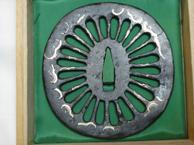

Next question! This tsuba has a very fine curved line sukashi in the iron on either side. Holding it to the light I noticed something caught in the cut. The only thing I could work into the gap was a sheet of paper, but that wasn't strong enough to shift the blockage. I tried a cutter blade and a pin, but they were both too thick to go into the gap. As I was messing around it began to dawn on me that to cut such a line would have required magical skill with a...a...a... what? A series of super fine fretsaw blades? I even considered buying a blade and snapping off the eye at one end in order to slip it through...
(PS It turned out to be a small ball of rust which I picked away at gradually with the tip of the pin from all sides until it was gone.)

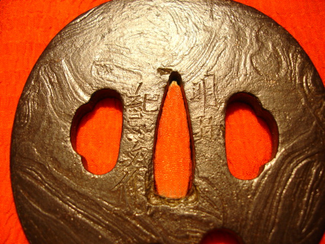

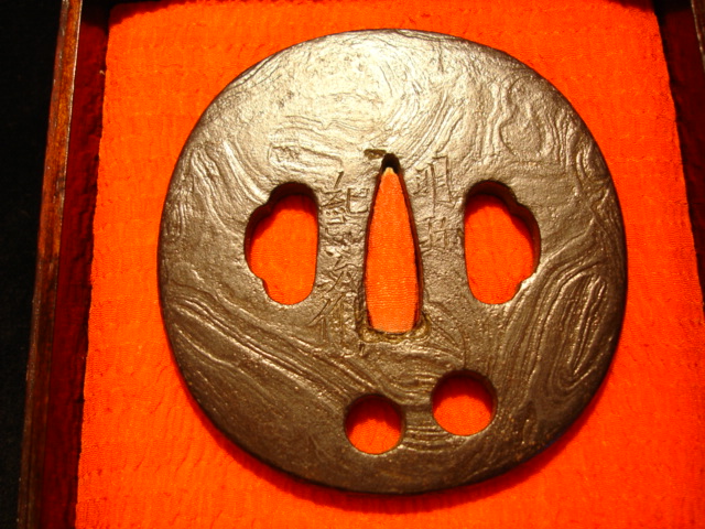

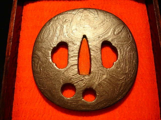

Recently saw a Nanban-tetsu tsuba on sale in a net auction and the very smooth quality of the iron looked rather similar to the one I posted above. My certificate makes no mention of Namban-tetsu, but does anyone think it is possible that it is?

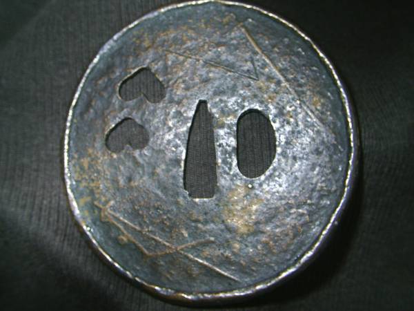

This is the Myochin tsuba I bought a couple of days ago. I was about to erase one pic which I took by mistake with a flash, when I noticed some colouring/coloring in the steel that I hadn't seen before. Covered in urushi? Not huge at 7.4 x 7.1 cm. Thickness at Mimi and throughout 4.5mm?

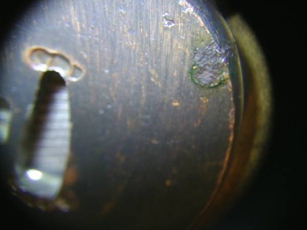

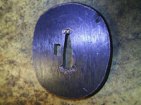

Two further tsuba have sold themselves to me. One is a copper Naval tsuba with what was described as a bullet mark to the Mimi. The other is a large Edo copy (?) in copper/brass of a Muromachi Toko/Katchu-shi tsuba, the seller said, with pine needle designs. Why do I keep buying tsuba? Am I ill?
What does 焼き手腐らし技法 mean?
" One is a copper Naval tsuba with what was described as a bullet mark to the Mimi. "
looks like a cold sore to me................ is that a " repair " with filler ?
I once had a ww2 gunto with clearly a bullet wound to the top part of the nakago and it doesn't look anything close to the example of the second pic.
You have hit upon a pet subject here and, at the risk of boring some members with repetition, I shall attempt to answer your question. The Dutch began to import iron into Japan, probably with its origins in China, Korea and India, around 1600 and during the C17 it was a consistent import into Japan both by Dutch and English traders. In spite of the abundance of local iron deposits, Japan produced only 5,000 tons of iron in 1882 and imported an average of 11,000 tons per annum over the preceding ten years. Unadulterated local iron was probably only used for sword blades (even this was not invariable), and pure Namban iron was probably only obtainable from the smelting of railway lines from Manchuria. Thus from the beginning of the C17, because of the constant reusability of iron, that obtained by the smelting of local iron-bearing sand must have become progressively and irretrievably admixed with this foreign iron
The answer to your question depends upon what you mean by ‘Namban iron’. If you mean any iron containing a variable amount of this imported variety, I suggest that most tsuba can be considered as being made of Namban iron. Although this imported iron varied considerably from the locally produced iron, both in its chemical make up — a high phosphorus content of 4-10 times that of the local iron is common — and in its physical properties, I know of no way of detecting its presence apart from by chemical analysis; certainly not by its appearance.
milt
It doesn't look like a repair with filler. If so, it would have been much more professionally done, wouldn't you agree? It's rough to the touch. The site seems to go right through to the other side, causing a little bulge or distortion, and it's quite a thick tsuba. The green leaching (?) you can see in the photo is not apparent to the naked eye. Bullet? No? Possibly it could have been hit by a piece of hot flying metal debris? :dunno:
Thanks, John, re the Namban iron content above. Thinking about the way that Japanese produce domestic 'wine' by mixing in large quantities of French wine, and how milk is largely made up from powder shipped in from Australia, with domestic milk blended in, your scenario sounds quite plausible. No boredom here. I for one, enjoyed reading it. :clap:

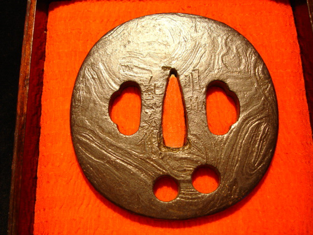

If at all possible I would appreciate a good, very hi-rez pic of both sides of your Namban tsuba, the one with gilt and beaded rim. You can send them direct to me at warlord@iinet.net.au or post them here in a thumbnail (as I have just learnt to do - thanks again Brian) linked to a hi-rez ImageShack file. Here are links to my tsuba that has an old Tokubetsu Kicho (green) paper:
Let's hope I've got it right this time...

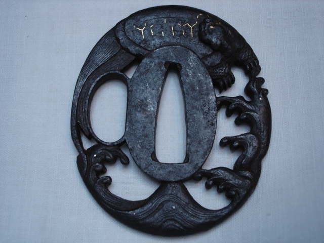

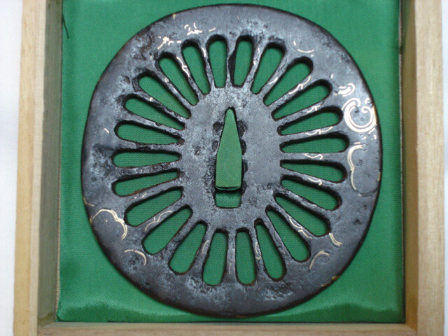

The Momoyama wheel Tsuba on p.2 of this thread has been 'refurbished'. Someone (a previous owner) had taken a file to it and zealously removed the rust, but this rough & ready removal process had also taken off most of the patina and much of the iron Ji and the Shinchu Zougan. The marks of the file could still be seen here and there.
A collector friend asked me if I would mind lending it to him as the sight of it offended his sensibilities. A week later and here it is.
First Impressions:
1. The remaining Zougan looks brighter.
2. The iron looks darker.
3. The Tsuba feels very soft and smooth to the touch.
In the phone call of Sunday he said the rust needed to grow a bit more so could I wait a few more days? Today he called to say that it was ready. I don't think that the Shinchu is actually any brighter, but the loss of the bright shine of the exposed iron has increased the contrast between the dark rust patina Ji and the remaining Shinchu Zougan. It looks a lot better, IMHO. He smoothed off the surface file marks so that now it also feels a lot better between the fingers.

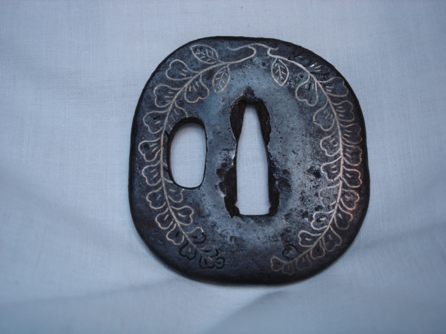

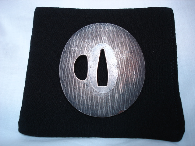

Anyway, as a kind of catch up, here are some of the recent additions to the box. The Nanako silver on copper Wakizashi tsuba with the chip I found a week ago. The rest assembled themselves today. One of them was a really exciting surprise for me, for personal reasons; I will post it over in this week's Edo Period corner.
PS Shots of just one side, out of concern for bandwidth. Any reverses upon request.
