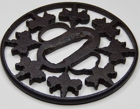

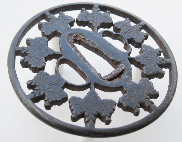

Gentlemen,

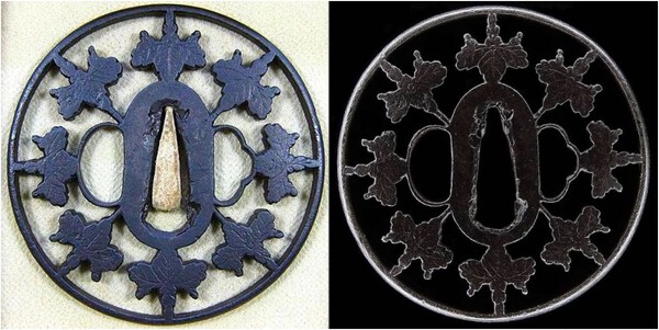

I want to show You a Tsuba.
The size is 81 x 82 mm / 3,18” x 3,22”, the thickness 4,8 mm / 0,18”.
There is no niku and the surface has a moist look (uruoi).
post-919-0-39639400-1468152421_thumb.jpgpost-919-0-70198500-1468152440_thumb.jpgpost-919-0-53762600-1468152453_thumb.jpgpost-919-0-80883600-1468152473_thumb.jpg
My first impression was Kyo-Sukashi because of the thin plate, the small, rounded rim and the sumptuous composition. The hitsu-ana, too, appear a little bit squeezed.
However, the design lacks the elegance and airiness of Kyo. The kiri look more like those I’ve seen in Owari-works. Furthemore, twisted-looking linear tekkotsu partially are seen in the rim.
After all - Owari?
I’m puzzled...
I would be grateful to get Your opinions.
Sincerly,
Florian

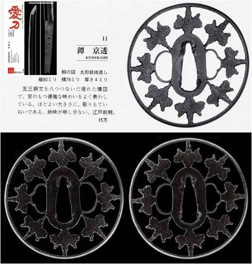

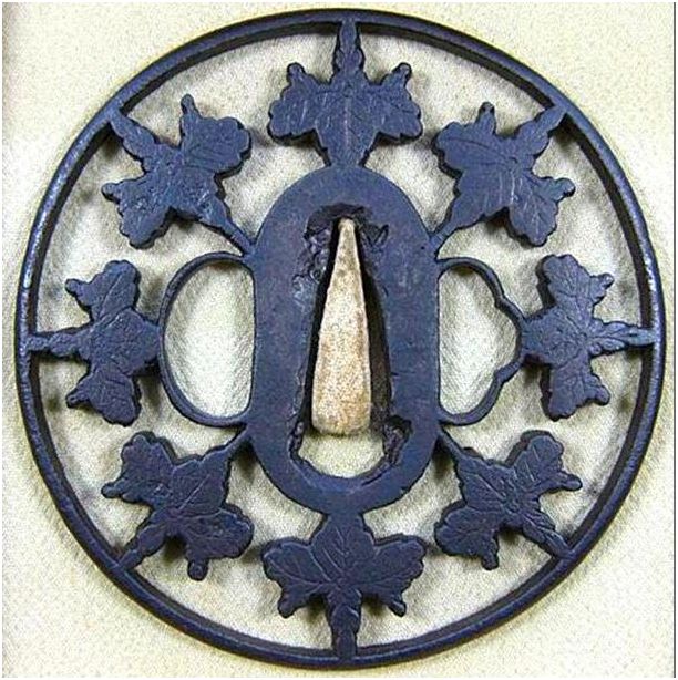

A similar tsuba assigned to Kyo but also a suggestion to school Owari (http://www.users.on.net/~coxm/?page=tsubaI_tsuba)
Owari tsuba, ji-sukashi, maru gata, kozuka and kogai hitsu ana, maru mimi, 8.1 x 7.9 x 0.4 cm, design of eight blossoms of kiri (paulownia) which was the mon of several old clans. Probably late Muromachi to early Edo period.
Thanks for Your replies.
Concerning the quality: IMHO  it is a very good tsuba and this is the opinion of our leading german expert, too. Although I must admit the difficulty to assess the tsuba by my moderate pictures.
I understand that the pictures by Mikolay show all the same tsuba, on one hand offered as Kyo-Sukashi - and as an example for Owari on the other hand.
Well, You see my problem...
However, it is interesting to compare both pieces. The shape of the kiri on the tsuba in Mikolaj's post appear in my eyes more like Kyo, but the seppa-dai and the ryo-hitsu hint to Owari.
Furthermore the herein mentioned time offers a wider range. I think, if it is Owari it can't be older than early Edo, if it is Kyo it could be earlier, around Momoyama.

Florian , I agree with you .
Sometimes the assignment to school is not quite obvious. Knowns patterns and themes are large facilitation .
Some of points make it difficult to established appropriate attribution

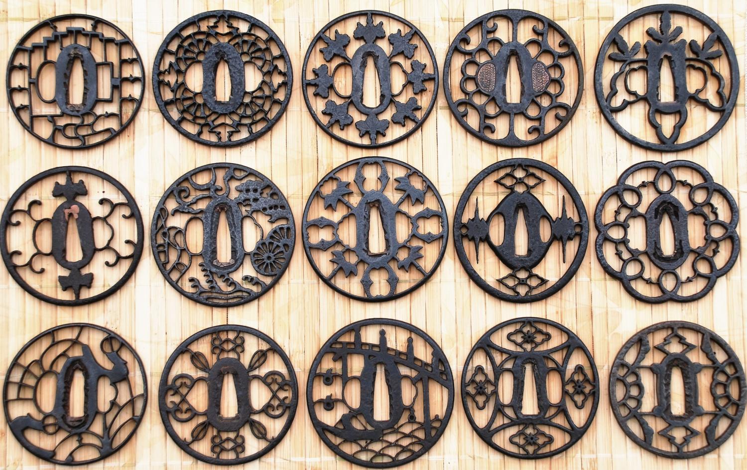

In picture below a few sukashi tsuba : on the left is Kyo , right side  is Owari , center Kyo/Owari

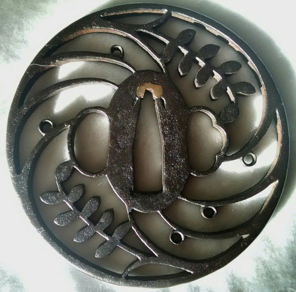

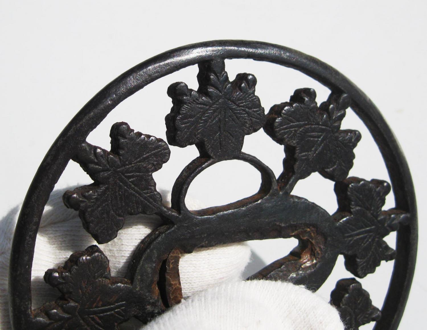

I also own a tsuba that shows traits of both Owari and Kyo.  Jim Gilbert believes it to be a guard that was made in Kyoto, but with a strong dose of Owari thrown in.  I agree with the assessment, particularly citing the overall aesthetic and iron itself.  The composition is loaded with finesse, but the execution is rather bold.  I believe the hitsu ana to be slightly wide compared to the average Kyo piece and the patina is deep and dark, much like many Owari tsuba of the period.  The key point for me though is the iron and the finish, as it's without a doubt Kyo style.  The seppa dai is also classic Kyo Sukashi.  I do agree with Jim that given the context of the time, it seems highly unlikely that this guard was made in Owari with Kyo iron.
And man, on that note I should really get back to work!   :badgrin:
Here are a couple shots of mine, because who doesn't love pics?  :dunno:

indeed a gorgeous tsuba! Judging by the pictures alone and without knowledge of the dimensions the steel surface and the seppa-dai (as mentioned above) could hint to Kyo, because of the sturdy execution it shows otherwise Owari traits.
But that's only speculation. It was a very popular subject so I think, also other schools can be considered. I'm not sure, but are there horizontal layers visible in nakago-ana and the hitsu-ana, too?
I found a similar Owari-tsuba in Sasano's book, classified as late Muromachi. Yours must be later, IMHO about early Edo - Genroku.
Florian
Hey Florian, thanks for the picture!
I'm stunned I haven't seen that one before. Which book is it from? It's hands down the most similar Musashino rendition I've come across, almost shockingly so.
Mine is fairly large at 8.4 x 8.3 x .5 and good eye, there is a visible fold line in the hitsu ana. It also has a few very subtle globular tekkotsu on the face of the plate.
I really enjoy Sasano's comments as well, in particular on the iron/patina and the nod to the seppa dai and hitsu ana . One thing that stands out to me regarding the composition of my tsuba is how well shaped and proportioned they are, and the deep purple tones are in full display.
I tend to agree with Jim's assessment that it's more in the Momoyama range. I think the size along with the bold, carefree execution of the motif are pretty spot on for the period. The depth of the patina and the construction method also argues for earlier. Of course, this is only my opinion.
