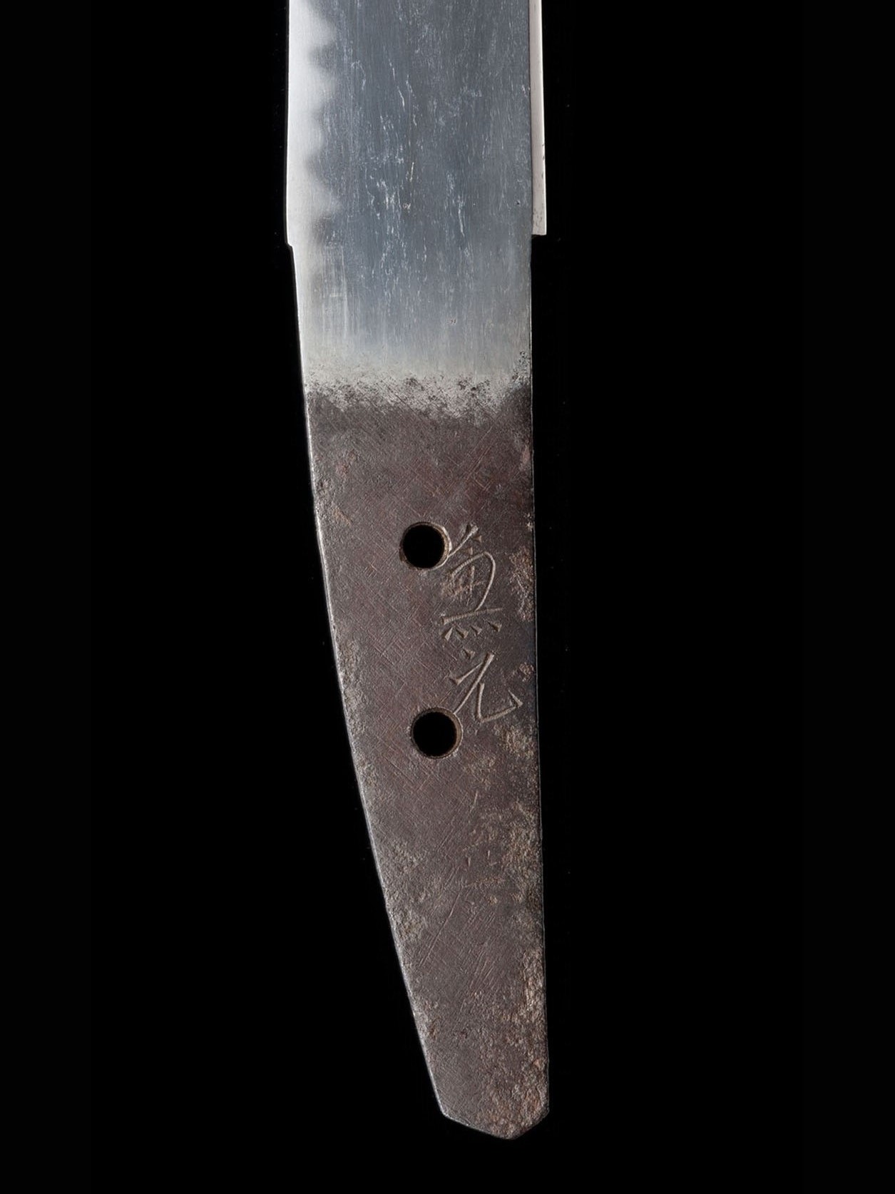

here´s the mei of a Tok.Hozon- actually for Juyo shinsa Magoroku...
compare with your´s....
Christian

Thanks for the pic christian! Here are a couple more I've found:
From the (Hosokawa clan exhibition) book: http://www.amazon.co...17460<em> </em>
OtJ8FhJh.png?1
From the Victoria and Albert Museum
Jason A

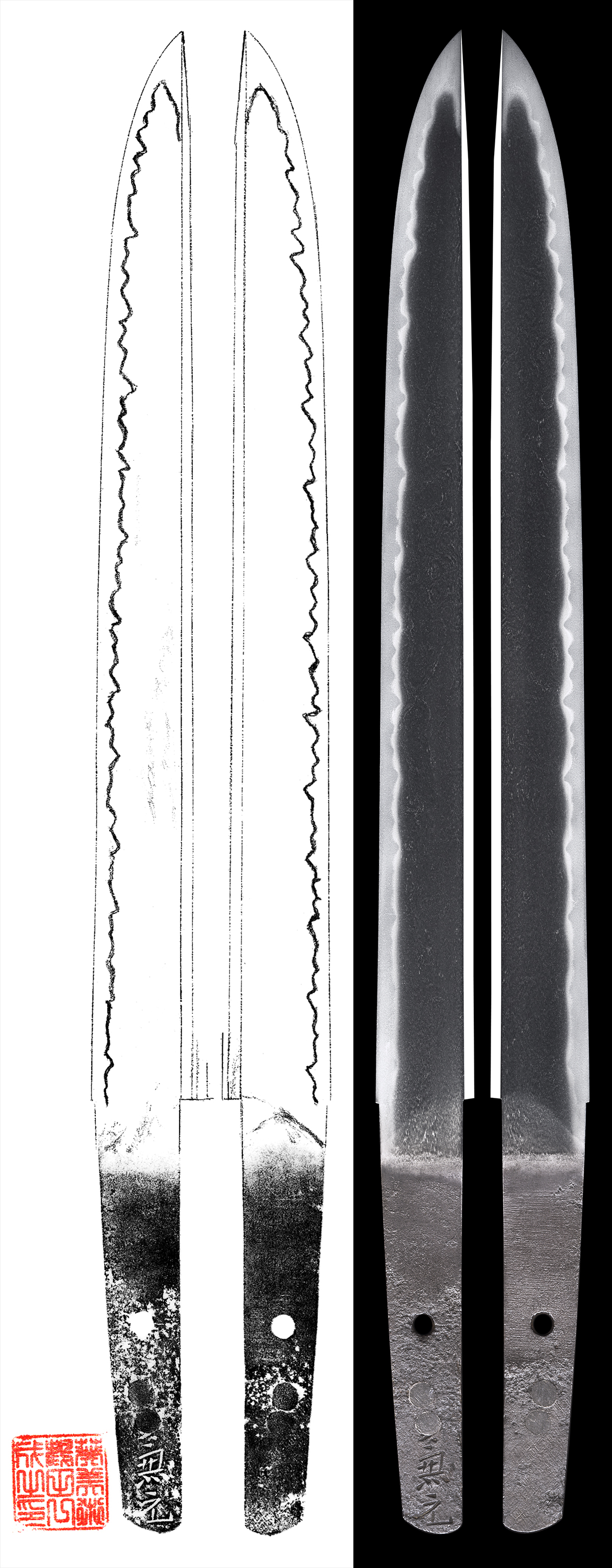

I don't think I know enough but I've been told Magoroku also did regular sanbon sugi but more often (and was more known for) his artistic irregular sanbon sugi.  Here's a katana attributed to Magoroku Kanemoto (by Hon'ami Koson) with fairly regular appearing sanbonsugi :
https://www.bonhams....17513/lot/3157/
... and a tanto that seems quite regular too:
http://www.aoijapan....015/15117-2.jpg
Neither quite matches my blade though; the "small cedars" are similar but the "tall cedars" are much taller and more pyramidal shaped on this blade than the attributed examples.

Here are a few more 2nd gen Kanemoto (Magoroku).
  • Chango likes this

The rule of thumb on the Kanemoto generations is that:
1. Shodai will show no sanbonsugi.
2. Nidai will show the concept.
3. Sandai distills the concept and it dominates the sword.
4. Later generations turn to an extreme uniformity with sharp peaks.
From a glance at the hamon it looks like sandai work to me. I didn't check the signature out. I think you are fine to restore this one and keep it, it's a nice example of Kanemoto. I don't find sanbonsugji "boring", there are some strange opinions that come out of non-Japanese circles, which is that "suguba" is boring too. Suguba is like a tuxedo or a glass of champagne. Yes, the big fat dude stuffing his face with a big mac and 1 liter of coke wearing his NFL jersey finds those things to be "boring" so I think it's important to keep that in mind when the instinct goes to criticize these things.

(I think this is 4th gen Kanemoto?)
And a couple more:
http://sanmei.com/co...4_S1290_PUP.htm
http://www.nipponto....s2/KT222042.htm (Edo Period Kanemoto?)
and http://www.giheiya.c...en/01-1091.html (edo period Kanemoto?)
A Magoroku (?) daisho from a Japanese museum:
http://www.touken-sa...anemoto-01.html
Plenty of stuff to look at if you are interested in Kanemoto swords...

http://www.e-sword.j...1000syousai.htm
Still finding interesting Kanemoto examples... I think this is now officially an obsession. :crazy:

Hi Jason This is 1,2, and 4, together my bet is 4 :)
Kanemoto 2nd gen
http://www.nipponto....s3/KT325563.htm
Kanemoto fourth generation,
and a Kanesada sambonsugi     http://www.nipponto....s3/KT324936.htm
but no paper
and one last Kanemoto  http://www.nipponto....s3/KT325508.htm
Jim P.

Thanks Jim, I haven't come across a couple of those yet... the 4th gen does have a very similar sanbonsugi.
The blade has cleaned up some more and I can make out my sword's hada now; looks like masame on the shinogi ji and a masame itame and/or mokume (wood grain pattern anyway!) mix below that. There are also a few lines that look like delamination; apparently that's actually a (shodai) Magoroku trait according to what I've read.
The whole blade shines like crushed diamonds in direct sunlight despite the sword's surface damage and the nioguichi? is visble as as tight thin unbroken line outlining the hamon pattern.
I don't know... the nakago is a perfect match for Magoroku, sugata matches (http://imgur.com/e4otKU3 and is the right size and with koshirae for a katate-uchigatana which fell out of favor in the early 1530s) the mei compares well with his too (although the semicursive "kane" and square "moto" character with the "hook" on the left stroke combination doesn't seem to be together on the same sword as often) and all the features of the blade seem to match up as well, minus the regular sanbonsugi pattern (although I swear I can see all the individual gunome shapes on my sword scattered throughout Magoroku's extant examples).
Then again, maybe I've just been thinking about it for too long! It would be beyond amazing to have discovered a Kanemoto 2 in the ebay junk pile but a later gen Kanemoto is nothing to frown at either.
If nothing else it seems to have originally been a very high quality blade that someone thought very highly of and has apparently seen action (and survived it, not to mention a few centuries of sitting around), so I'm a happy camper either way.

I think it must be Jean but then I keep finding stuff like this which throws me off and makes me wonder:
This example seems to really match my blade well (Nagasa is 60 cm on the example vs my sword's 56 cm).
pfhIkqwh.png?1
I thought it was a second generation Magoroku Kanemoto (Kanemoto 4)  based on google translate of the website but I found an oshigata of the same sword on Nihonto-no-Bi:  http://www.users.on....igata_sword_k45 which identifies this example as Magoroku Kanemoto along with an inscribed date from 1528.
The Kissaki pics aren't quite right in my comparsion (picture of my sword was taken at an angle) but other than a slight variation in the angle of the yokote the actual blade matches the oshigata when resized on my phone/computer and placed under the sword. Likewise, the nakago is slightly longer on the example but otherwise is a perfect match and the Mei seems very close (I've found other Magoroku attributed swords that show the minor variations between my blade and this example, such as a more rounded "Kane" character and the mark above the "moto" that is pointing up at an angle rather than parallel).
Is it possible Magoroku Kanemoto did regular sanbonsugi toward the end of his carreer or would it be more sensible to figure later generations very closely copied Magoroku's sugata/mei?
Guess I need shinsa for a definitive answer but considering the evidence I'm thinking there is a possibility my sword is Kanemoto II, unless I'm missing crucial information somewhere. Am I interpreting this right?
