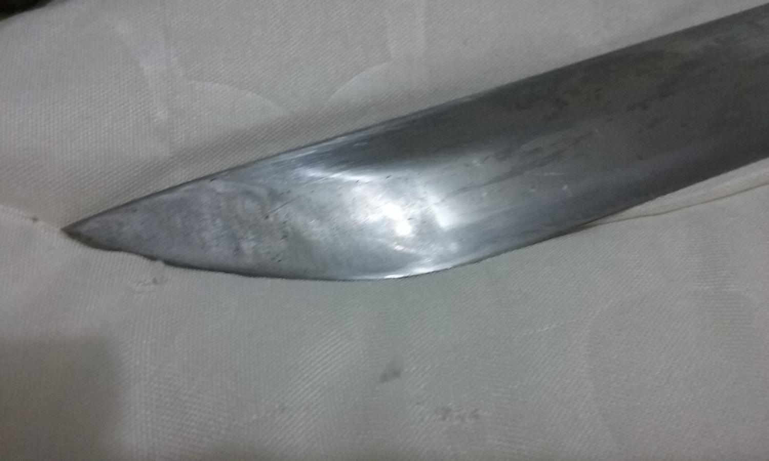

Johncstroud Posted June 5, 2016 Author Report Share Posted June 5, 2016 Kissaki Link to comment Share on other sites More sharing options...

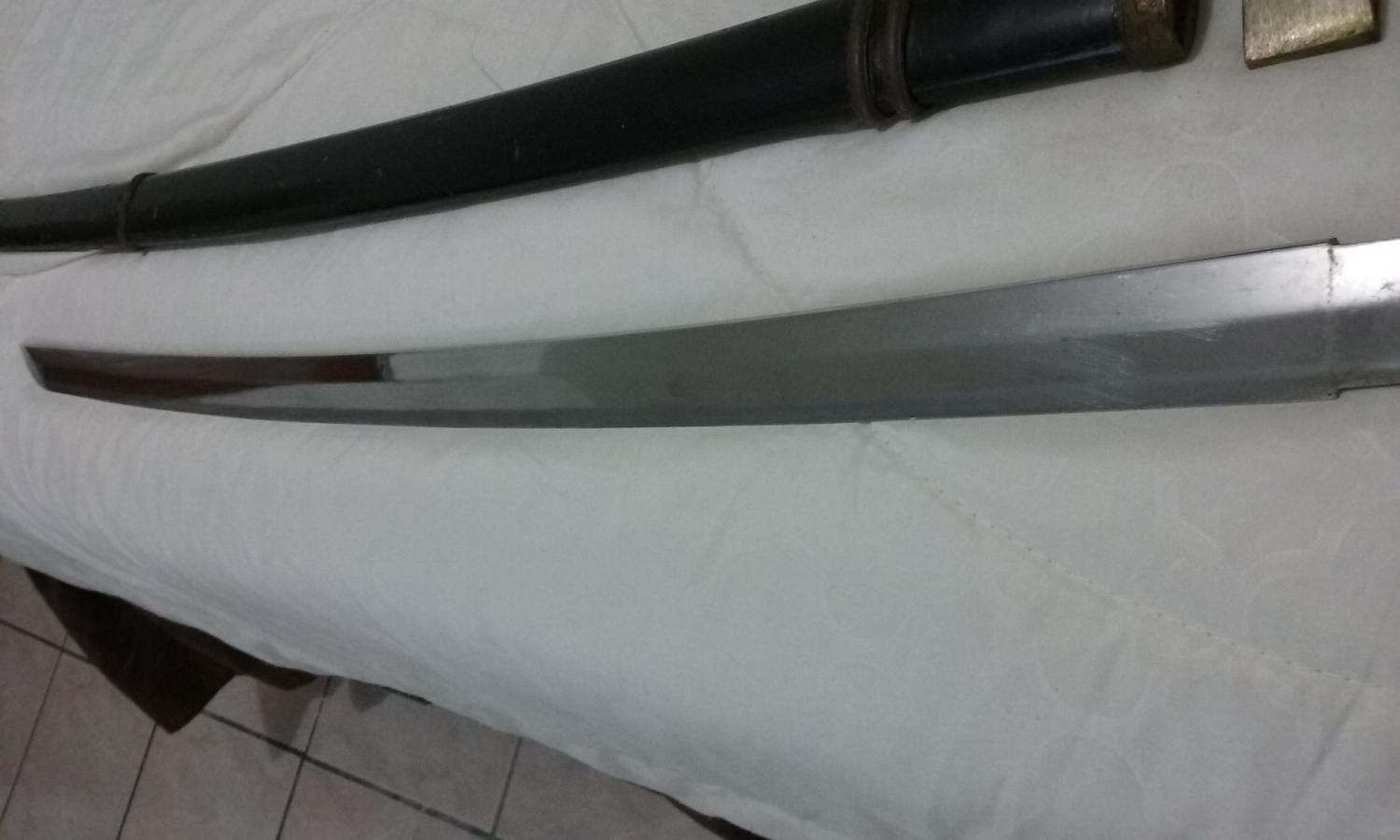

Johncstroud Posted June 5, 2016 Author Report Share Posted June 5, 2016 Blade Link to comment Share on other sites More sharing options...

Johncstroud Posted June 5, 2016 Author Report Share Posted June 5, 2016 Well after about fifty attempts,finally got a good picture of the mei this phone is a piece of do do.the interesting thing about this is the odd mix of army and navy elements and all seppa and handle have#45 for assembly numbers the sword has the typical brought back ww2 story was reportedly in the store for over thirty years hanging on a hook near the cieling Link to comment Share on other sites More sharing options...

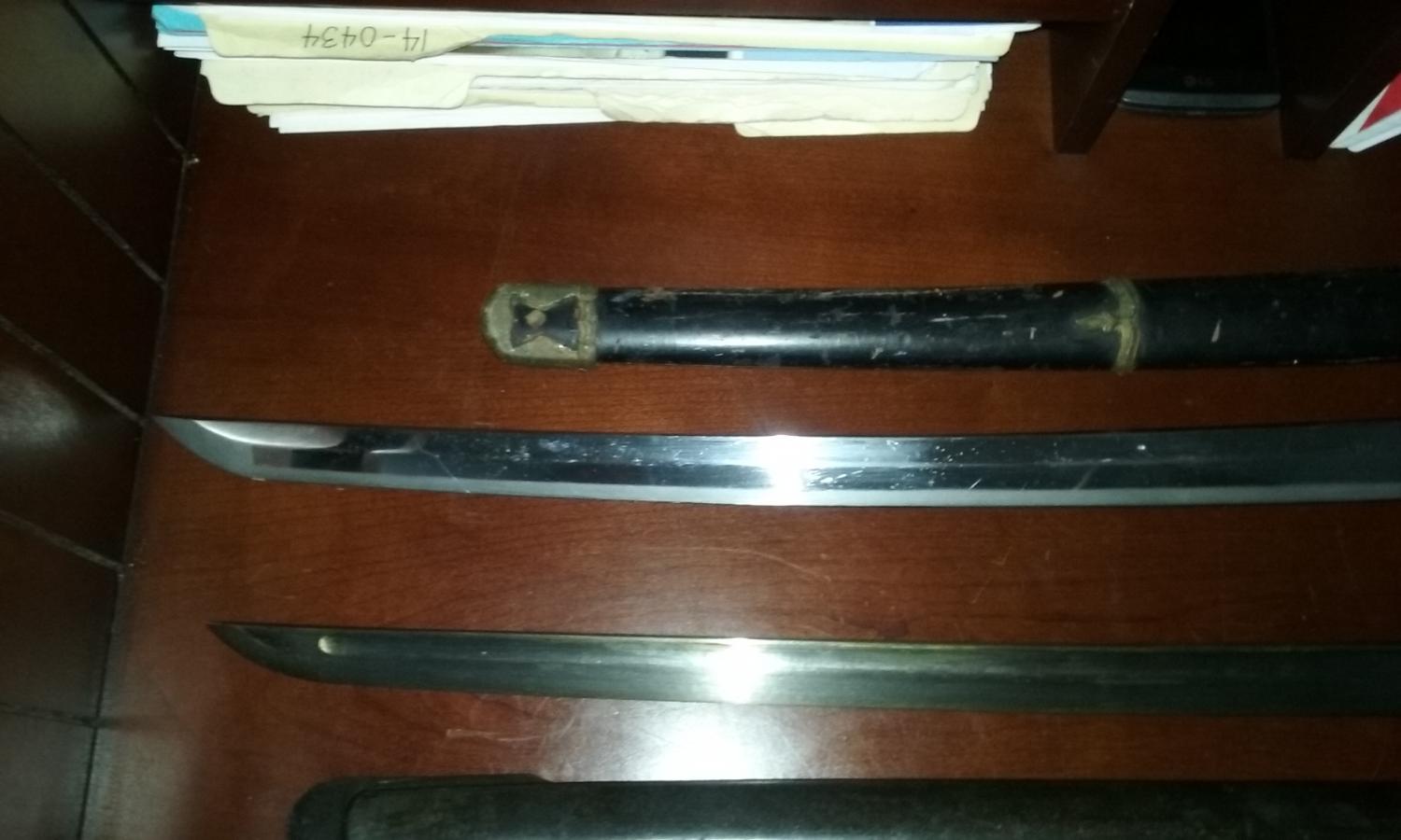

Johncstroud Posted June 5, 2016 Author Report Share Posted June 5, 2016 More pics... Link to comment Share on other sites More sharing options...
Johncstroud Posted June 5, 2016 Author Report Share Posted June 5, 2016 One more... Link to comment Share on other sites More sharing options...

Johncstroud Posted June 6, 2016 Author Report Share Posted June 6, 2016 Thought I would add one more picture yeah I know they are not great but its the best I can do for now. Link to comment Share on other sites More sharing options...
Bruce Pennington Posted June 6, 2016 Report Share Posted June 6, 2016 Well after about fifty attempts,finally got a good picture of the mei this phone is a piece of do do.the interesting thing about this is the odd mix of army and navy elements and all seppa and handle have#45 for assembly numbers the sword has the typical brought back ww2 story was reportedly in the store for over thirty years hanging on a hook near the cielingWhile the real pros are working on the smith - The mix of army fittings on the clearly navy gunto make this, what is commonly called, a Marine Landing Sword. The IJN did not have "marines" as a seperate unit, but the navy troops that worked on land were often known to take up this style of saya with army fittings. They were originally gold-gilded like the navy fittings, but the gilding seems to wear off somehow. Nice blade! And yes, the painted numbers are 45 just like the stamped numbers on the seppa. Everyone agrees they were there to keep fitted parts together during manufacture and assembly. Link to comment Share on other sites More sharing options...
