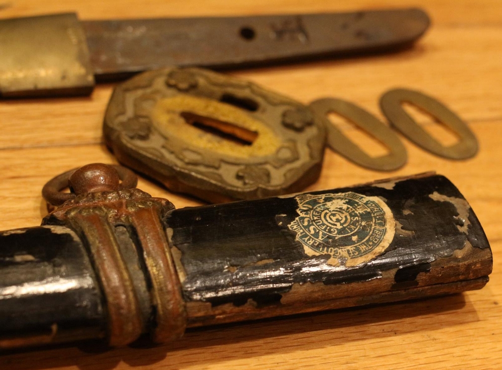

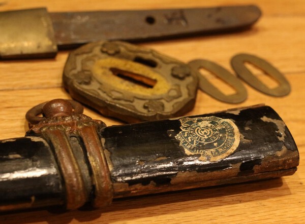

Now, this sword scabbard clearly states "Sword of Seki", which I´m familiar with, BUT, my question:

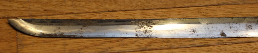

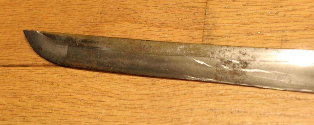

1) This blade doesn´t seem to bear a stamp nor signature, 2) The sword definetely and clearly reveals a hamon. Machine made/an officer´s privately ordered, handforged sword? Can anyone kindly elaborate on this sword, please? Highly appreciated. Thanks out there.
Tsuka and Saya didn't look unique for me.

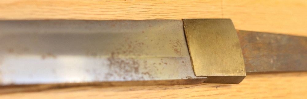

The parts look like they did not fit together. The habaki is to small. Die sarute peg doesn't fit. Maybe the sword is built from different parts?
The culinary stamp is usually found on seki swords as you know, seldom is found a gendaito, more along the lines of mass produced  blades, it may not be org to it.
Thanks appreciate it. Same thought crossed my mind. But what about the blade itself, can you help on anything, it does have a hamon. What should I make of it, please? A 1930´ies blade, but traditionally forged, "disguised in a later "Seki"-scabbard or.....???
Can you show a picture from the nakago without the habaki from both sides?

But congratulations anyway as the saya with the Seki sticker is considered rare. It's not in great condition but clearly original. Are all the mounts low quality? The Seki saya tends to come with low quality fittings as these were produced towards the end of the war. Saya would have had a combat cover to at some time. These were cheap and flimsy so few survive. Unsigned blades with oil temper and painted kanji on the nakago are the usual for the model.

That is a really ugly short tang on the sword . I don't think a trained swordsmith would produce anything like that. You should get it out of your thoughts that there is even a possibility that this is a hand forged piece by a recognised smith . Steve is right it is highly likely that it is a late war sword with an oil quenched blade of low quality. Ian brooks

I, like several others are puzzled by the unusually small nakago (tang). Would you do us a favor when the gunto arrives, of taking the kisaki off and getting some good pics posted of that area where the tang meets the blade?

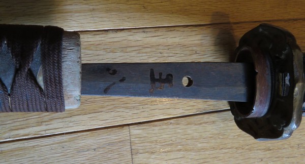

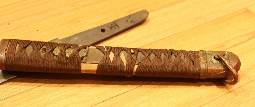

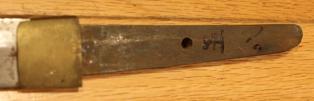

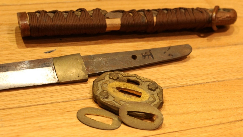

So since I'm finding this quite interesting I've gotten around to something I've been meaning to do for 3 years now. The mekugi got jammed in my late war sword in transit, so I was never able to look at the nakago, though I knew it had painted kanji as the late war Seki do. So having drilled the peg out carefully, I've taken the tsuka off for a look and photos. Disappointingly not the same markings as yours. Type 44 also regularly have painted kanji, as do the stainless naval gunto. It's pretty common in military swords. I don't think it really tells us much about the blade.
I've still posted these in case you're interested in looking. I'll be interested in seeing more photos of what you've found. As has been repeated oft; as soon as you think you know all the Japanese patterns along comes a surprise.
Thanks again, your comments much appreciated. I expect to receive the sword within a couple of weeks. Firstly I´ll carefully remove habaki(which seems stuck? and definitely not handfitted for this sword) and hopefully take some nice shots of the whole lot in the hope that this seemingly - (?)a little uncommon - military sword will reveal what it really IS... - Flemming. By the way, VERY nice sword shown above :thumbsup:
I've found a few habaki get stuck with dry grease, oil or rust buildups. A good way to carefully remove it is using half a cloths peg with the wedge against the habaki, flat side against the blade (any bit of untreated wood in a wedge shape will do, peg is just easy and available). Then gently tap with a small wooden hammer. Will pop off easily. A little oil helps.
