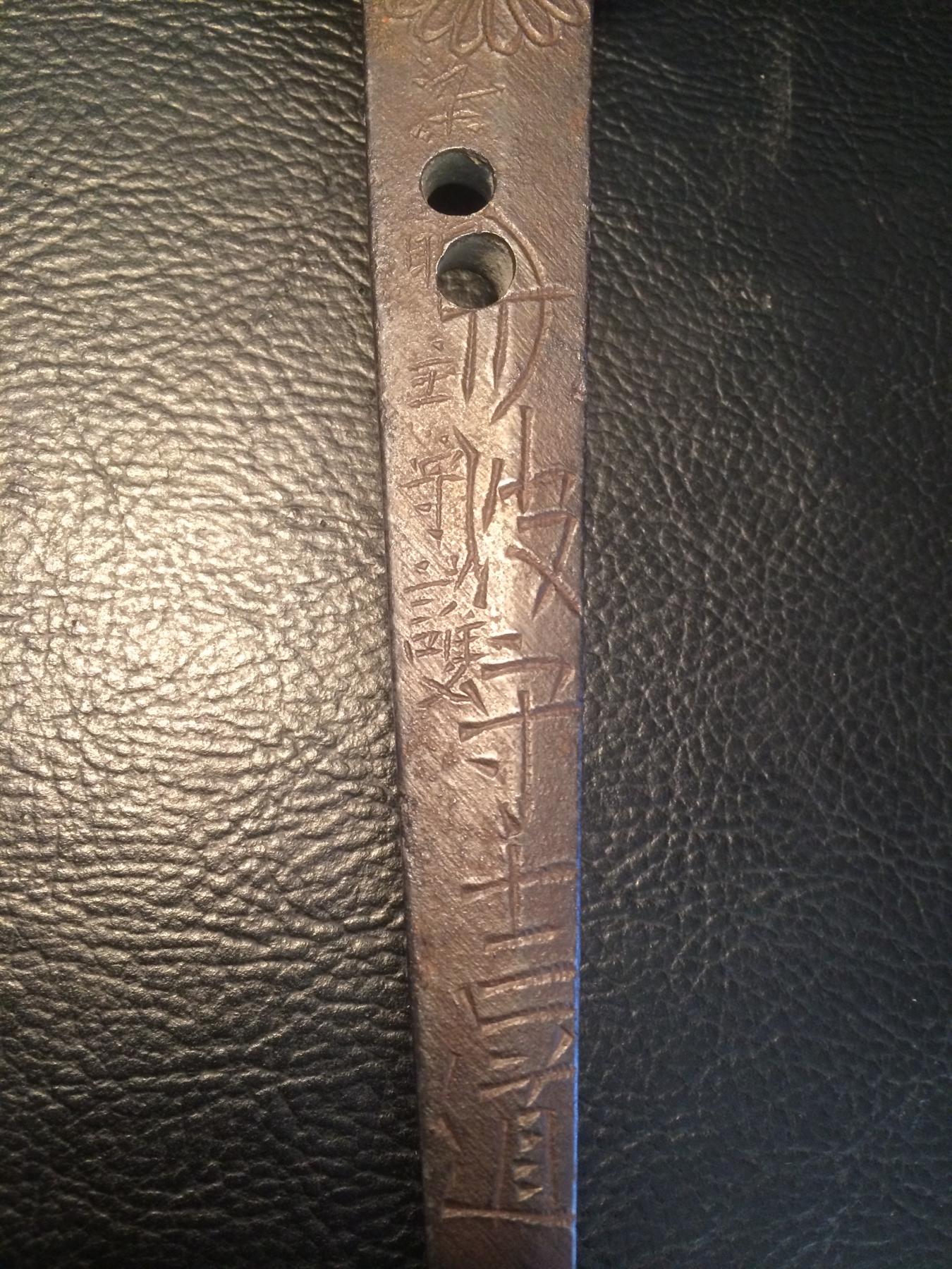

Hi to everyone.
I've bought a year ago a wakizashi from an individual for a relatively decent price, for the main reason it was in a bad shape. I've sent this wakizashi to a polisher and it should be ready at the end of this year.
From my reasearch, I've found that the mei was "tanba no kami yoshimichi". The hamon seems to be sudare-ba, so perhaps it is a genuine one. Now, I have a chalenge : which Yoshimichi is it ? shodai, nidai, etc. ? Osaka or Kyoto ?
Thanks for your help !
Sylvain

Hi Sylvain, IMHO.  I think you should get it to shinsa , I had a look at a few references and had no luck matching it to Osaka or Kyoto has the polisher given a opinion on the mei ? As you say ( I can guess the sudare ba design of the hamon within the rust, ) are you 100% its sudare ba ?
Hi Jim.
The polisher thinks it's a real one, even if he could'nt determine which generation it is. He just began his work on the blade, so he couldn't reveal yet the sudare-ba. However, he told me yesterday that he was planning to do a "window" on the blade (polishing a small part) so as to check the jihada and hamon for my purpose. He had an interesting remark about the "weakness" of the mei : "who could say he signs exactly 100 % the same way everytime, expecially when it is hand made ?" I would emphasize : mei are not hot stamps, right ? So, in theory there could be a sligthly difference of signing from a blade to another, even it is performed by the same swordsmith.

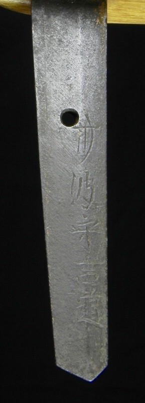

Anyway, through my different readding, I was taught : don't judge the mei by itself, judge the entire blade. Please wait for further photos of the blade itself and we'll have a better judgment. Meanwhile, here's another picture of the mei with natural lignt. Looks better.
Hi Sylvain, IMHO I am surprised the  polisher would say that, yes there is variation in the way a smith signed but they did not have bad days and your mei has some differences that I had a ? about for example Hawley lists 3 generations so have put up  some shoshin mei from Aoi art what do you think ? the Yasurime looks ok but the mei has some ? I would be interested to find out who signed it if its shoshin
Hi !
The mei is an issue I agree :-? , for it seems definitely a bit weak compared to other signatures of these swordsmiths. :doubt:

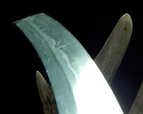

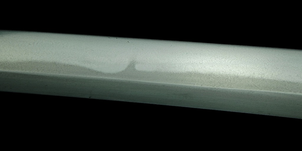

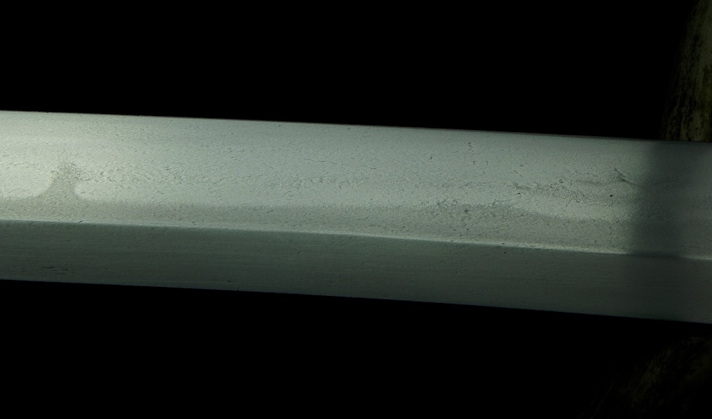

Anyway, the polisher sent me this morning some pictures of the hamon at the first step of polishing. What do you think ? Is it sudare-ba or not ?
Sylvain
A big thank you to all of you guys, I think we have moved forward.
I will submit it to NBTHK shinsa for sure, thanks to your comments. You will have to wait for the result for a while, as the polishing has just beginning. I will do an update of this thread once the sashi-komi has been done completely, and obviously once it has passed the shinsa.
Sylvain
Hi Darcy, I had a look at a few Yoshimichi most of the ones I looked at did not have sudareba about 60% and looking at this blade it has some of the form that makes up sudareba so maybe a mix ? or just the polish ? we will see when the polish is finished .I enjoy doing a bit of kantei  right or wrong it helps improve our skills :)

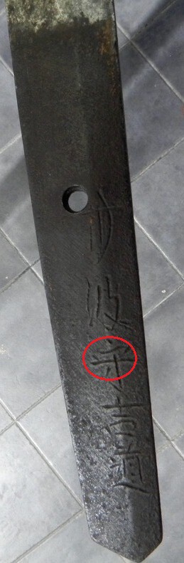

Hi Jacques, Saw that the atari was pointing the wrong way and looked off is that what you are pointing to ? it should be pointing down when this was first posted I had a look at a few and some characters vary a bit but the only one that had it in this place was yamato no kami yoshimich but the rest of the mei does not match look at pic For those that want a good article on the kyoto yoshimich's mei have a look at  TOKEN  TO  REKISHI Issue 614 IMHO if you take all of the info together it has a good chance at shoshin,

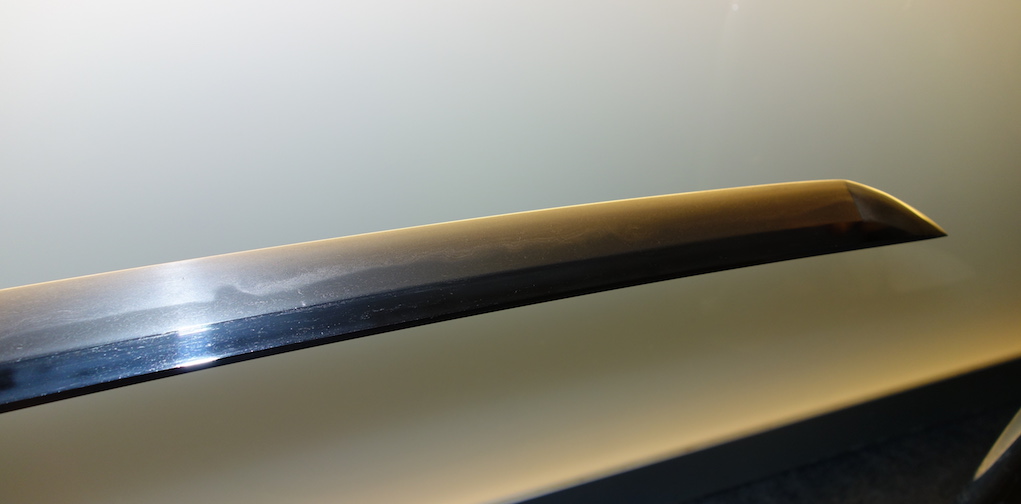

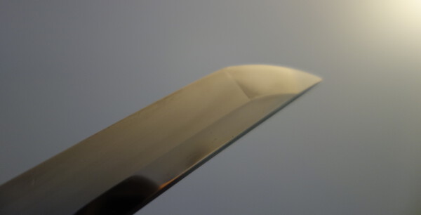

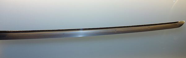

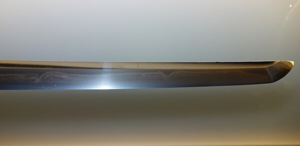

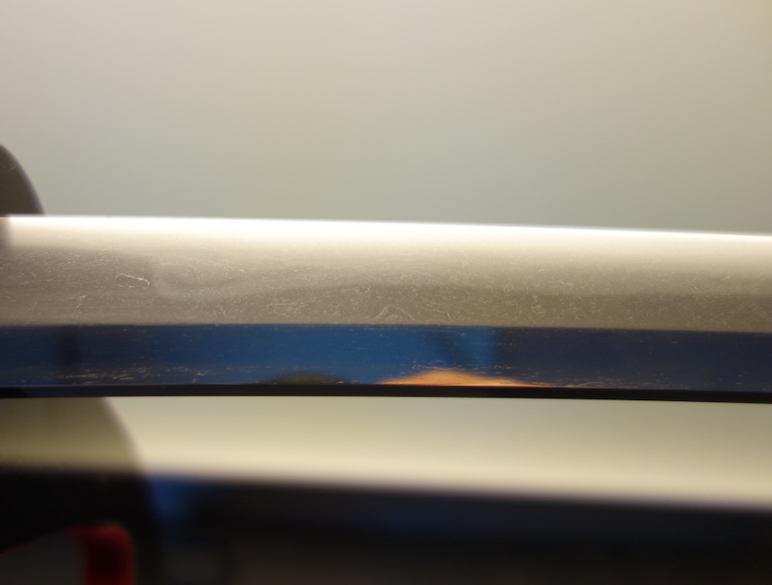

Hi all !
It's been a few months since my last post on this thread.

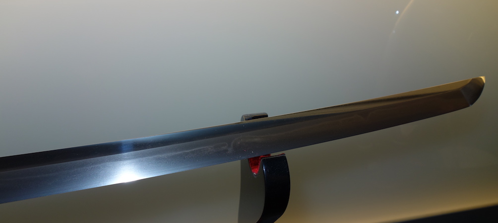

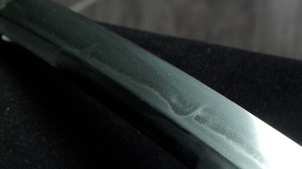

I got the wakizashi back from the polisher. Now it's on its way to Japan to pass Shinsa. While awaiting for the judgment, here are some pics of the blade. I got difficulties to take good pictures with the poor light of my appartment, so please be kind !
Probably OK.
The NBTHK is not always confident in the generations and over time the scholarship on Yoshimichi (as a school) has shifted around a bit. So you need to be prepared for it to come back, if it's legit, as just copying the mei onto the papers without any resolution of ambiguity. Whomever submits it then, if it comes back without saying anything about generation then probably you may want to try a sayagaki. They do not seem to want to really nail the generation down though and will either say shodai or else later generation if the Juyo are any indication and this is more prevalent in recent history than in older Juyo, wherein if the blade was really good it just went to the shodai. None of the Juyo have kiku mon though. Odd side note. Though many are not by the shodai.

Hi all !
I just got the results of the kantei for my wakizashi:
NBTHK judged it as gimei
NTHK-NPO judged it as genuine (origami issued)
As the blade is still in Japan, I don't have the NTHK origami yet. We'll see if there is any indication of the generation on it.
Still, I'm quite surprised of the difference of judgment of the two associations for the same blade... Seems to be often the case by  reading other topics.
