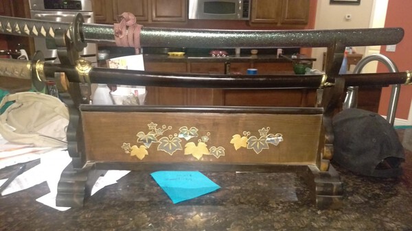

I said picked up because I went and looked at a trunk and the guy had these sitting on top of it. It was a sword stand with this sword and a ww2 navy sword with an anchor stamp. He said his grandfather brought them back from ww2 and was stationed at pearl harbour, and that they sat outside for 3 months waiting to get through customs. I asked if he would consider selling them, he named a price and I went home with them and not the trunk.

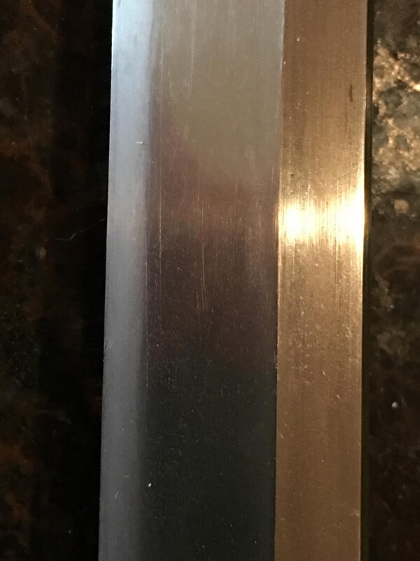

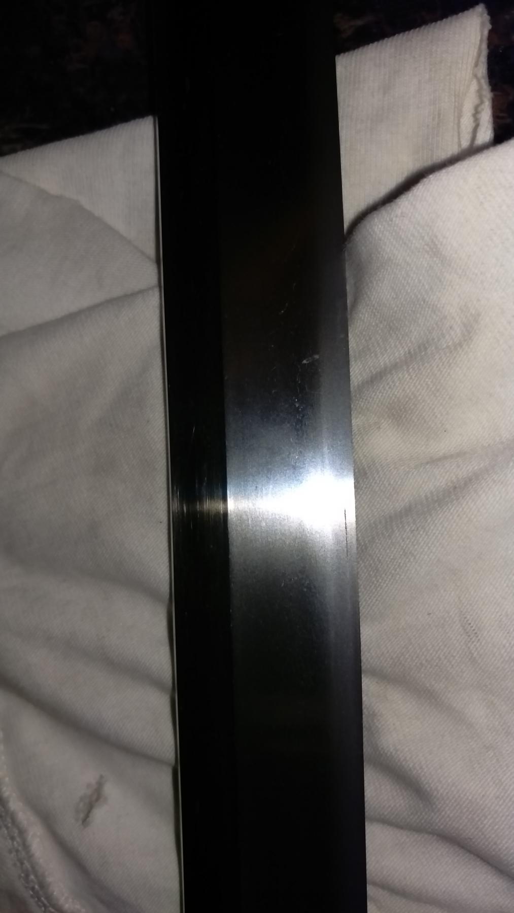

You might want to see if you can post some photos with more detail to see how the workmanship stacks up with the above as at first blush it looks an interesting blade.

From what I can see of the sword's sugata (wide hiraji and large point) it suggests nanbokucho period...but this wouldn't be the first time I have been wrong. That's why I was hoping that Sean could post some further pictures which might help to confirm the sword's age.
Sean, do you have any measurements for the length of the cutting edge of the blade?
Also, it looks like the original mekugi ana is near the end of the nakago now and the distance between the ana would give a feel for how much the blade's length was reduced in the suriage.

The cutting edge measurement from the tip of the kissaki to the munemachi was about 22 1/2 inches, I am not home right now but am having my wife send my pics and I will post them as soon as I get them. If there are any specific areas I need to get better photos of please let me know. And thanks again for all the helpful information.

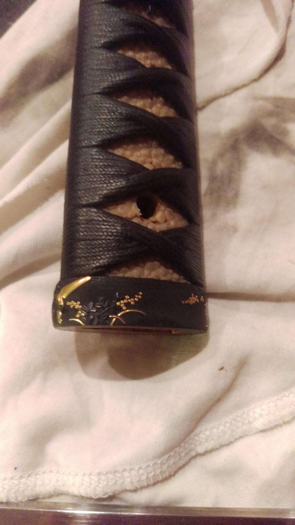

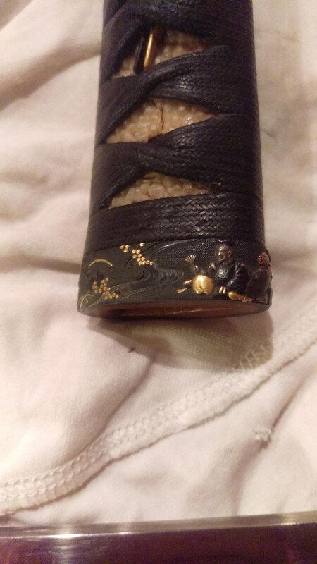

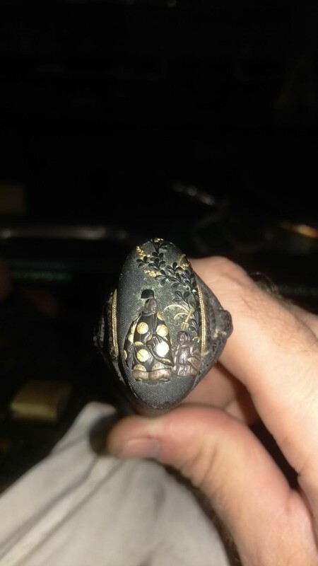

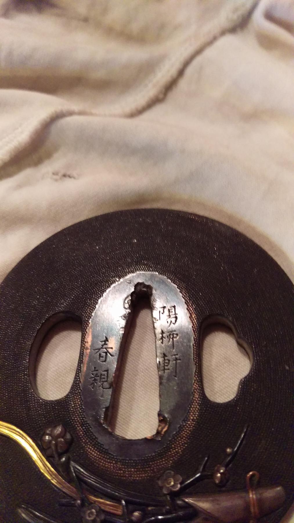

No telling exactly how old the koshirae is. Say anywhere from 300 - 150 years old. I have read that this type of "aogai mijin nuri" (mother-of-pearl) koshirae was popular towards the end of the Edo period, which would make yours roughly 150 years old if it was made during that time.
As is often the case with Japanese swords and fittings, older doesn't necessarily mean better. Think of koshirae as replaceable parts, and the sword may have had several different koshirae throughout its life. (Yours certainly would have since the sword was shortened at some point).
The koshirae in your pictures looks to be in very good condition. Could be even more recent than edo period. In any event, it looks fabulous.

I must disagree with Steve. While it looks Kanbun Shinto, I think Nanbokucho is a distinct possibility if not late kamakura and sue muromachi can look like this when suriage.  The hada has a koto look to it. It's extremely hard to tell with only 57cm remaining, a chu kissaki and without better pictures/polish to see the hada and hamon. Definitely one for shinsa as it's certainly well beyond my abilities.
