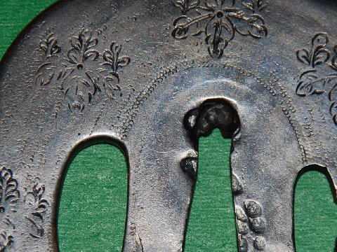

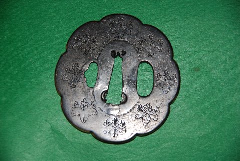

bought this lately, seller called it late edo/Meiji and I disagree.......
I think this is ko-kinko , possibly Momoyama or earlier.
The wear pattern looks very natural and, in my opinion , not contrived.
pics will be posted in mutilple massages.
Don't be shy with your opinions........... thanks
p.s. this is in shakudo, but ye all know that already.......
milt the flying ronin
" it is Yamagane with a thin shakudo plate on the outside ? "
nope, solid piece, looks like shakudo ( very dark blackish brown ) not like the typical yamagane with the " reddish grey brown " color.......

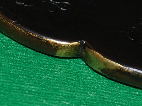

I am not sure about the gold " wash " on the mimi, not nunome but doesn't look like gold paint-on either........

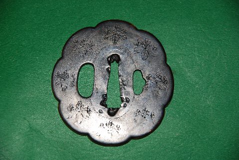

Milt -- I believe it is Momoyama, mid to late therefore Ko Kinko. The gold on the mimi would be original, probably some type of plating. The size difference in the kogai and kozuka bitsu is seen during this time period. What bothered me when I first saw it on Ebay was the extreme wear to the omote. This I can't figure out. The nanako has been wiped away in places. The dealer showed mostly ura pictures with only one omote view toward the bottom of the page if memory serves me. It's an interesting piece but the reason for the wear alludes me.
The extreme wear to the nanako can't be natural. No amount of wearing a sword, fighting with a sword, or any other normal sword usage would erode the nanako that badly, no matter how old it is. Something had to have happened to this; either the nanako wasn't cut fully to begin with or it was removed all at once later.

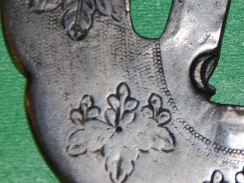

the last " dark " pic could be deceptive.........
the kiri mon and what's left of the nanako are very " LIGHTLY " incised/punched.
I would say over 85 % of the tsuba surface is actually smooth with traces of " nanako "
The nanako we can see is almost like a cursory " after throught "....not fully punched like we have in the edo period kozuka.
A strange piece...........

I, too, would confidently label this tsuba as Momoyama Ko-Kinko work, but the exaggerated wear does pose some questions. Surely that measure of wear would have exposed the raw metal, and either the tsuba has been repatinated at some stage in its long life or - and more probably - the artist deliberately created the impression of increased ageing by 'going easy' on the decoration.
