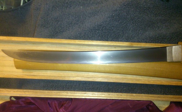

I´ve been an admirer of Nihontos from a distance ever since youth (which was waaay too long ago!). Why "from a distance" you may ask? Well, to tell the truth, I´ve allways had too many interests, and to trying to add even a fraction of what´s to know about Japanese swords simply hasn´t been practical.
Today however I aquired my first true Nihonto in trade for an antique Colt percussion revolver (my main collecting interest). The blade is complete with documentation, in shirasaya mounting. The description (freely translated from Swedish to english) reads like this:
Tanto from the 1540´s. Mei Kanenori, overall length 41 cm, blade (tang excluded) 31 cm.
Shirasaya mounting 50 cm.
Habaki in silver,
Blade in good shape, shinsa performed (smith  and mei are okey). Blade has been polished over the centuries by which the double bohi on one side is gone, but there are remains on the tang that shows it´s been there. Blade has a slight twist noticeable under close scrutiny.
Documents from the NBTHK are enclosed.
