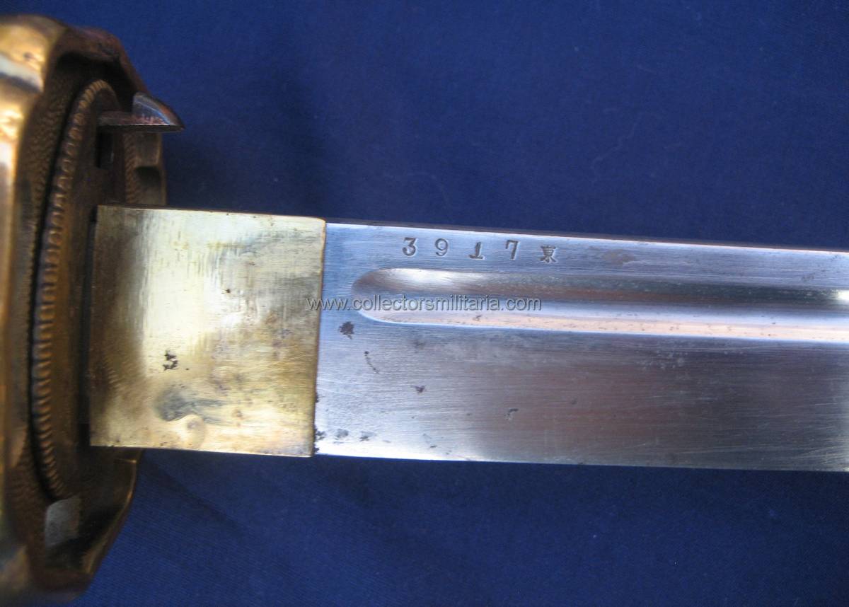

Daniel Posted October 23, 2015 Report Share Posted October 23, 2015 +2 No doubt, look at the Kissaki, the wobbly bohi and how it ends. Link to comment Share on other sites More sharing options...
SwordGuyJoe Posted October 23, 2015 Report Share Posted October 23, 2015 +3 - Look at the bohi... Link to comment Share on other sites More sharing options...
Shamsy Posted October 23, 2015 Report Share Posted October 23, 2015 That sword is so obviously fake a quick glance in any book should alert even the newest purchaser. Someone will be sadly disappointed. Maybe best not to list all of the errors, but the kissaki and stamping are enough to make me cringe. I can see... 7 errors in a quick glance. One so obvious I'm surprised no one mentioned it yet. The screw. Please no one elaborate on that. The Chinese do read these forums. Link to comment Share on other sites More sharing options...

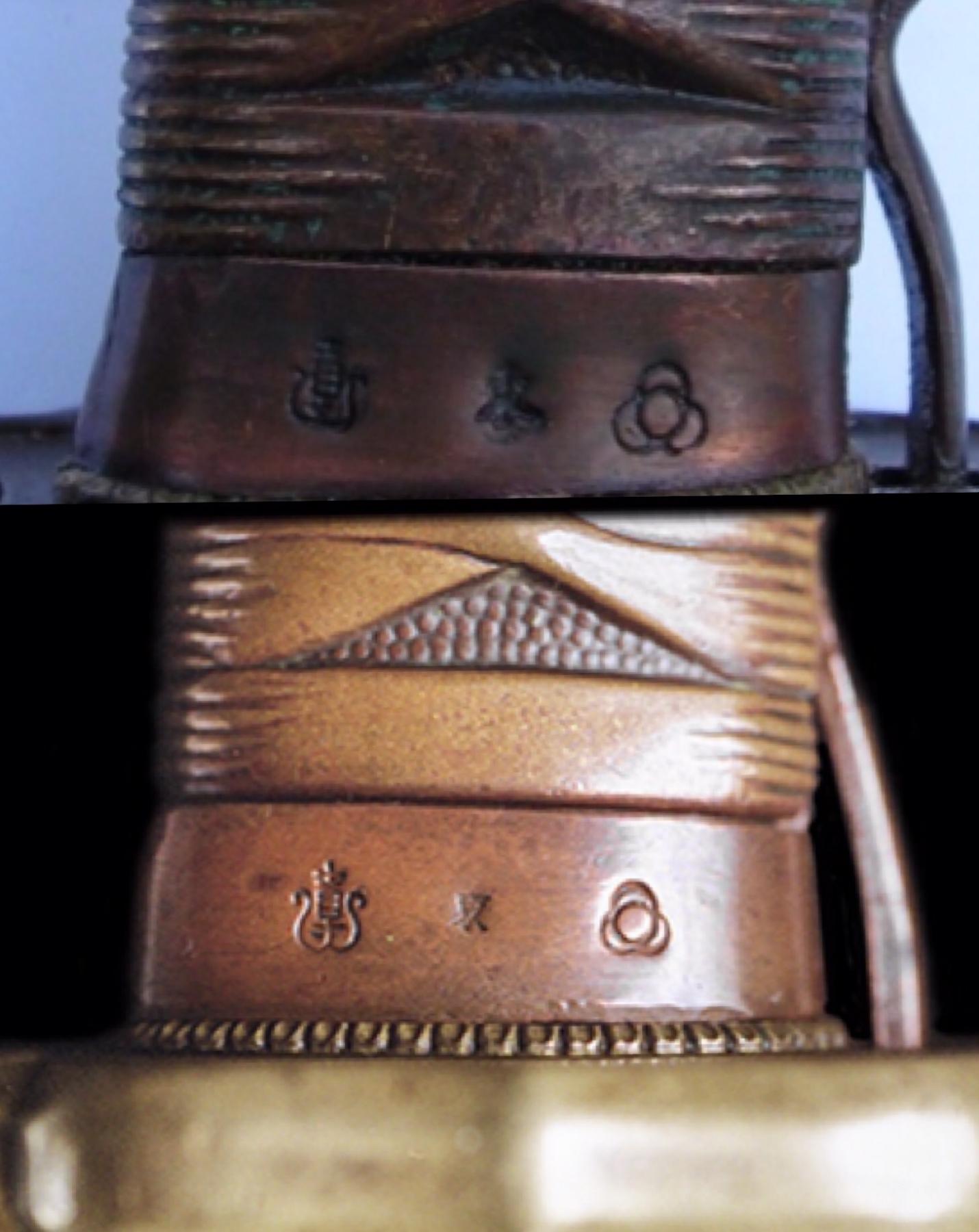

Baka Gaijin Posted October 24, 2015 Report Share Posted October 24, 2015 The giveaway for me is how deeply indented each the stamps are on the Fuchi. Link to comment Share on other sites More sharing options...

Baka Gaijin Posted October 24, 2015 Report Share Posted October 24, 2015 Take a look at the crispness of the Fuchi and the stampings here: http://ohmura-study.net/792.html Also, didn't the original Type 95 Copper Tsuka only have one secure screw at the Kabuto Gane? The secondary screw where one would expect a mekugi ana, was added on the later Aluminium Tsuka models. Also, looking at the extreme close up of the Fuchi area shows something weird, like a verdigris coloured waxy substance has been added in the areas of the Itomaki casting. Link to comment Share on other sites More sharing options...

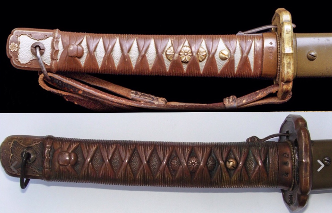

MAXBLISS888 Posted October 24, 2015 Report Share Posted October 24, 2015 For comparison 1 Link to comment Share on other sites More sharing options...

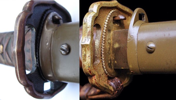

paul griff Posted October 24, 2015 Report Share Posted October 24, 2015 Hello Mark, It's a dreadful fake ,from the heavy patina finish to the hilt,the overspray onto the scabbard throat and the recently added file damage again to the throat. The list could go on and on but must admit they are getting better . Thanks to Thomas for alerting any potential buyers. Paul. Link to comment Share on other sites More sharing options...

Kai-Gunto Posted October 24, 2015 Author Report Share Posted October 24, 2015 The lock clip attachtmeant is to high on the tsuka and the lock clip is to thin. The seppas are poorly done. The shape of the fuchi is wrong....I could go on.... 2 Link to comment Share on other sites More sharing options...
Kronos Posted October 24, 2015 Report Share Posted October 24, 2015 Forget the koshirae which has many errors, the blade itself is just plain wrong. Once the chinese learn to make bo-hi/a kissaki that doesn't look absolutely awful then there may be something to worry about but not until then. 1 Link to comment Share on other sites More sharing options...

brannow Posted October 24, 2015 Report Share Posted October 24, 2015 Mark, I have owned several of these over the years. The one on ebay is a fake. One only has to look at the poorly cut grooves in the blade to know this. The serial number and arsenal marks are wrong. The handle on the sword looks decent (still not original) but the rest is typical poor copy of an original. I hope these photos will help clear up any confusion. Bill Rannow www.artswords.com 1 Link to comment Share on other sites More sharing options...
