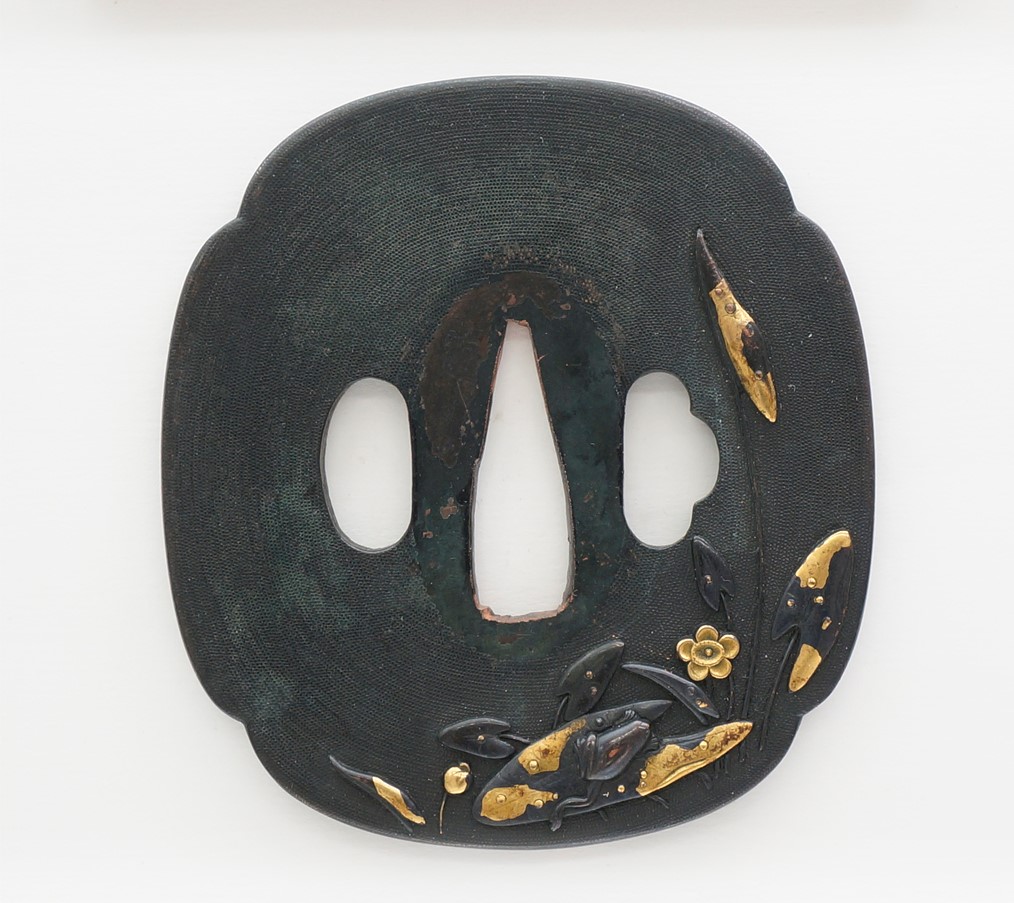

Thank you all for your thoughtful replies,  personally i was torn between A and C. I do like the look of kogai, but leaning to none now.
Which leads me to second question, plug both ana or leave open?

link shows tsuka, ive had a change of mind on the one posted, which ill never sell as its a favorite.
http://www.militaria.co.za/nmb/topic/16526-new-tsuba/?hl=%2Btsuka+%2Brepair&do=findComment&comment=172087
the frog tsuba and its  gold highlights plus the kurikata from elders having gold on leafs brings it all together with the gold in tsuka?  all opinions welcomed.
It depends. If you have relevant kogai and/or kozuka, or better a matching set of both, contemporaneous to your blade, one or two pockets could be marvelous.
On the other hand, if you have no such kogai and/or kozuka or only later examples, A remains a sound solution, but I am not exalted by tsuba-plugging.
Stephen, many katana sized tsuba have ana, even if they never were intended to be used - they're just kind of a design element. I listed the "traditional" preferences already, but it's up to you, whatever floats your boat will be fine, you're assembling *your* koshirae after all, and it doesn't matter if it's a crowd pleaser. A. is usually the traditional choice, and probably would be mine as well, but I'm pretty conservative (ar least when it comes to koshirae). Less is usually more.

Your Koshirae (Tsuka and Tsuba) looks really nice.. We have all have seen many Koshirae with (both) Hitsu ana open, so it  will work…
Just to reiterate what I was saying though, here are two of my Wakizashi Tsuba That have only Kozuka fitted (as is the standard for Wakizashi), but I personally would not bother fitting plugs to an antique Tsuba, simply because of the cost; I hate spend money.. LOL. Your koshirae will look great as it is… As Guido - and every one else - has stated, its your Koshirae.. We do this for 'us'.. no one else.
Looking forward to seeing the finished product…
