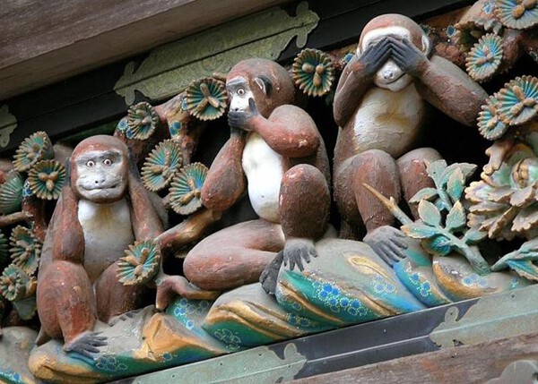

Looking at the kanji I wondered if the meaning was split and read as:
Grev
"-zaru -ざる" is an archaic negative verb conjugation, and is pronounced the same as zaru, the vocalized form of saru 猿, monkey. The famous three wise monkeys at Nikkō's Tōshōgū use this word play for an old proverb: mizaru, kikazaru, iwazaru 見ざる, 聞かざる, 言わざる – don't see, don't hear, don't speak [evil].
Maybe this is a similar word play, nozaru – although I don't know what it might stand for.
