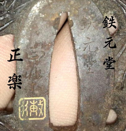

Hi all. I've had a sword floating around the house for a while and the other day I decided to try and do some research on it.  According to a member on another forum (Reddit), it's an antique Japanese tanto from the shinshinto period. I took it apart to take some pictures of the tang, and there were quite a few markings on the tsuba that I was hoping you guys might be able to help decode. There were no markings on the tang, so I'm hoping that the tsuba might be able to tell me a little more about the history of the sword. I know that the fittings were changed pretty often, but this would at least give me a jumping off point. I only have a few pictures of it, but they should be clear enough to read the writing and see the design. I can provide more pictures if needed. Thanks in advance for your help.

Hi, I think the signature on the tsuba could be:
鉄元堂 - Tetsugendo
正楽 - Shōraku
For a similar signature of this artist AKA Okamoto Naoshige see: https://commons.wiki...1199_-_Mark.jpg
Bye, Mauro

I went back and took another look at the tsuba with a loupe and it seems like those are the correct characters. Thanks for the lead Mauro, and thanks to Ian for mentioning Tetsugendo earlier. I flipped through the pictures and didn't see a connection but I didn't realize you were reading the characters off the piece. The signaure on the piece shown in wikipedia looks extremely similar as well. Thanks again everyone.
