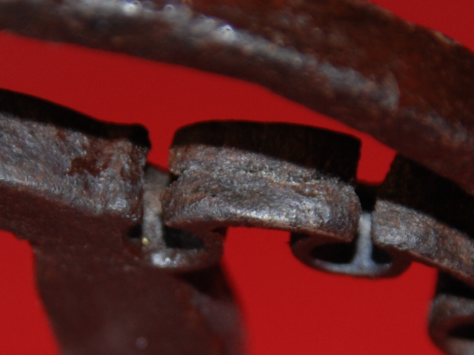

I know we have spoken briefly about whether or not ware on tsuba are fatal, but I was wondering if anyone has any info on the following flaw on a tsuba I got recently on a wakizashi?
I am unsure if it is a casting flaw (doesn't appear to be cast to me?) or a flaw in the folding or forging?
The opening seems to run around a section of the tsuba, and then seems to go diagonally up to meet the edge of the tsuba. How badly are ware such as this regarded on tsuba?

Hi Brian -- that looks like a forging flaw from a single fold. If you look into the sukashi you can see how that line actually goes around the area as the grain is different. Possibly a Kyo Shoami piece Momoyama to early Edo to my eye. The opening is probably due to a lack of flux in the seam causing the weld to fail over time as stress in the iron pulled the layers apart. It would be considered a point loss in a kantei/shinsa.

Yes...looks like a clack, but if you look at it in hand, and you follow that ware around where it is not as noticeable, then that is where it comes up to the surface of the tsuba, so it is a continuation of the ware, not through the whole mimi.
Brian
Hey Brian -- sorry, I couldn't resist :roll: . I think it's probably where the weld came to the surface (ji). It all depends upon how the bar was folded and then cut. Little trick: get a raw piece of pizza dough rolled out and fold it either once (like a U) or twice (like an S). Then take a glass and cut circles in different positions; middle, ends. You can see the different ways the folds can express themsleves along the mimi depending on where the maker cut/rounded the plate.

Milt..I see what you are refering to, but the bottom part of the "crack2 isn't really there, just caused by the loss of gold making it appear that way.

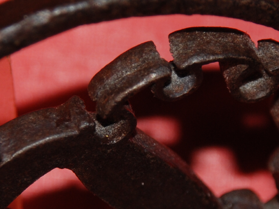

This is how the ware actually runs...

Brian -- that's a very good picture you just posted as when you look into the sukashi above the delineated 'clack' (LOL) you can plainly see the fold line running in the middle. Anyone who has not seen this before please note that this is a kantei point for determining age as you rarely see this after the early Edo period as the tsubashi went over to using factory forged plate thus eliminating the forging irregularities that gave much of the character to the old iron pieces.
Pre Edo construction techniques often show 2 layer construction. With the old gold on the mimi, I agree with Pete's possible Kyo Shoami call.
The 2 layer construction can bee seen in Katchushi, Tosho, Saotome and even early Kaneie.
When seen in good condition, as on this Muromachi period Ko Shoami, it can look almost like a single long running bone.
I am not sure of the sword strike theory, the natural ware and tear of age can cause these flaws to open, plus careless handling by owners who would have cared less than the samurai that originally wore these on their swords.

Milt -- well done on the pics. Interesting how the oxidation favors the weld as is shown by the invagination of the sukashi wall.
