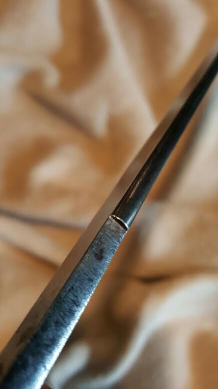

Ron, thank you for the picture.  What significance, if any. to the shallowness of the marumune on my wak?
Trying to clear things up to the point where i can submit it to shinsa at a Burlingame Token-kai, hopefully next year.  Looks to be Mino in Soshu style.

John,
Honestly, I've no idea what a shallow marumune vs a more rounded/higher marumune indicates. Seems very little solid information is available regarding this, as opposed to mitsumune being wide or narrow often indicating age.
