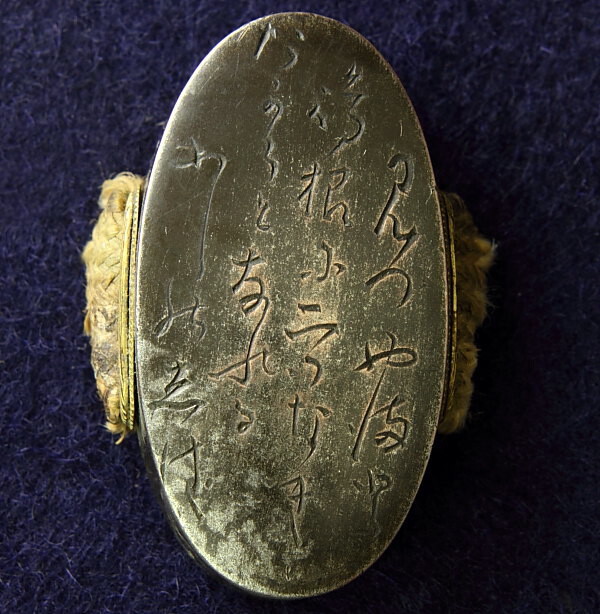

items in question are a fuchi/kashira set with a Mt. Fuji theme im trying to handle the mei on the fuchi, BUT the inscriptions on the kashira are WAY beyond me

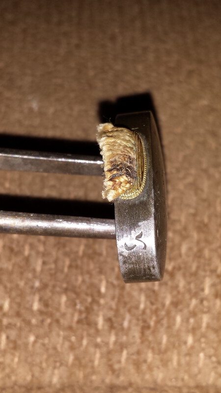

the face is completly covered on a very small kashira,Was told it's a "WAKA"? and it also has some inscription around the edge by the shitadome possibly a date? will try to get a clean photo of those
any thoughts opinions, i would love to hear them
thanks in advance
Ok guys, morita-san did the hardpart of getting script off kashira pics and on paper so im going to trust it's solid, looks good to me lol
anyone want to try to translate his work into english in meantime?
looks like typhoon hitting Japan, id think mr morita's got bigger fish to deal with right now
I am not certain. This is how far I got using Denshi Jisho. :)
Maybe Morita sensei has a slightly other interpretation of the text. The part I am unsure about is the two people becoming enriched since there is no particle which states the meaning [by] or [because of] the wooded slopes of Mount Fuji.

Thank you for your all postings!!
Meaning of the haiku poem of the kashira:
[The extensive foot of the mountain,the Mt. Fuji, only one treasure in Japan.]

This Japanese poem(Tanka poem) of 31 syllables is the poetry which admired Mt. Fuji.
Please wait for English translation.
Your ability is really indispensable.
My finding suggests that the reading might be a little different.
たから(宝)となれる ---> たよりとなれる
空にみつ やまと嶋根に二つなき
たよりとなれる ふじのしば山
---> In Japan, there is an irreplaceable symbol/sign(?) - that is Mt. Fuji.
However, I am not sure about the correct translation for "たより" in this context. :?:
This tanka poem seems to be one of poems composed by Keichū (契沖).

Moriyama san,
I searched the book of the Edo period in the library of Waseda University.
This book is the 100 poetical works in which Keichu composed Mt. Fuji.
It says TAKARA (宝/treasure), not TAYORI.
You don't believe wrong web-site!
Attached pic is a avidence.
This book says TAKARA 宝 .
Translation :
Filling the sky,
In The island country of Yamato,
Two lives become enriched,
(by) the wooden slopes of mount Fuji.
KM

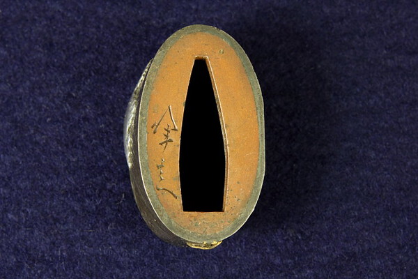

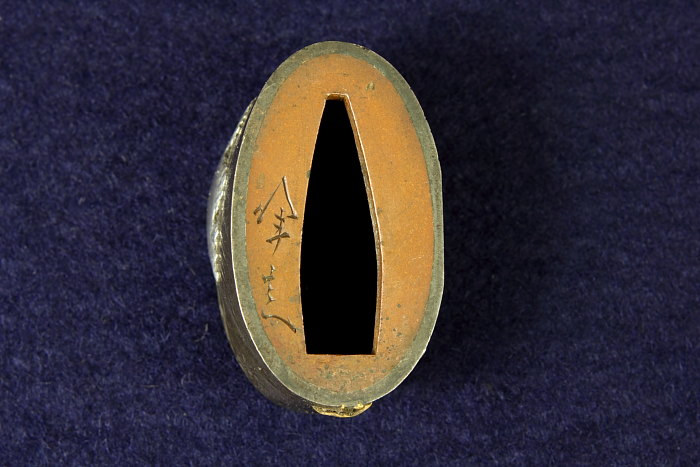

heres the mei on the fuchi if anyone wants to give it a go
thanks sorry if pics are sideways one kept flipping
James

First character of that mei looks to me like the one for Kin (gold), or Kane (money)
So Kane ..... Would be my guess.
KM
mr botanical,
Hard to read upper kanji of the mei of Fuchi.
Because, it is too artistic and artful .
Lower kanji is "Shin" 真 .

It is beautiful your translation.
But, translation of poem is not creation of poem. ;)
