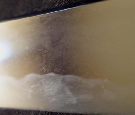

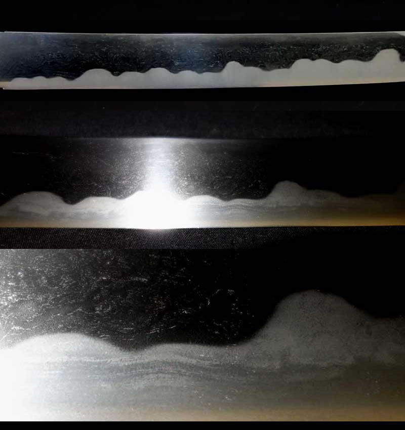

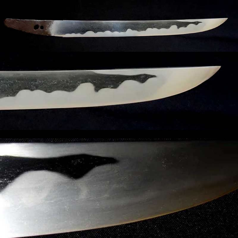

kunitaro Posted September 21, 2014 Report Share Posted September 21, 2014 This post is not really for Kantei, I am trying my new camera with an old blade. Could you tell me your opinion about this blade or opinion about photos. Hamon is based on O-gunome-midare hamon and Mune-yaki, Jitetsu with Jinie, strong Nie-utsuri, it looks almost Hitatsura on Ji. I could not take photo of this Utsuri/Hitatsura on Ji, however, please let me know what you see, Tanto : Hirazukuri, Mitsu-mune, Nagasa : 26.5cm, Sori : 0.1cm, Motohaba : 2.8cm, Motokasane : 0.58cm, Link to comment Share on other sites More sharing options...
kunitaro Posted September 21, 2014 Author Report Share Posted September 21, 2014 other side Link to comment Share on other sites More sharing options...

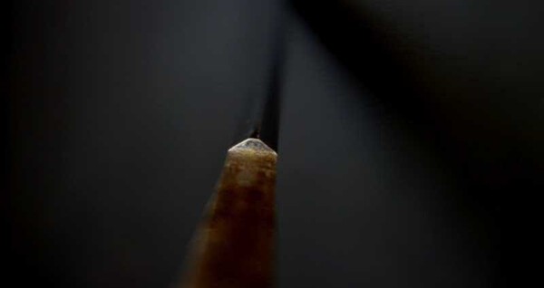

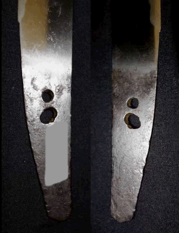

kunitaro Posted September 21, 2014 Author Report Share Posted September 21, 2014 Mune and Nakago Link to comment Share on other sites More sharing options...
Marius Posted September 21, 2014 Report Share Posted September 21, 2014 A good old Masahiro(?) Your pictures, or most of them emphasise the hadori, which looks like a real eye-sore. Tanto seems Nambokucho/Oei, as the sugata, including mitsu-mune seem to indicate. The polish is irritating. Honestly, what is the purpose of such a strong hadori for what seems (almost?) a hitatsura? I am not saying that this must be done in sashikomi, but the polisher should have been more considerate with his finish. Having said that, this might be only your photos... Link to comment Share on other sites More sharing options...
cabowen Posted September 21, 2014 Report Share Posted September 21, 2014 The hardness of the hadori struck me as well... Nakago shape looks like Sengo. Nice Soshu den.... Link to comment Share on other sites More sharing options...
Jean Posted September 21, 2014 Report Share Posted September 21, 2014 Good pictures but the hadori is very strong so it is almost impossible to photography the hataraki. The light to take the whole blade is facing it so you can see it in the blade, instead, it should be oriented sideways. The close up is very good. Link to comment Share on other sites More sharing options...
Tcat Posted September 21, 2014 Report Share Posted September 21, 2014 Soshu and looks a bit 'Muramasa'. Hamon looks very white... Link to comment Share on other sites More sharing options...
Gabriel L Posted September 21, 2014 Report Share Posted September 21, 2014 As to photos, I think you are on the right track Kunitaro-san, but the biggest issue is that the light is very "hard." This means a direct lamp close to the blade, creating extreme contrast and one bright spot with very dark falloff. It reveals much, but only in a narrow region; everything else becomes under- or over-exposed. I think you could improve the results using lights left and right, angled lower, at a distance. Then you will have even lighting across the blade—no "hot spots" or dark shadows—and still reveal a lot of activity. Overall though these are certainly useful photos which do show some features for kantei etc. Link to comment Share on other sites More sharing options...
bubba-san Posted September 21, 2014 Report Share Posted September 21, 2014 Taking everything into consideration , I my opinion its still a beautiful blade . Thank you for letting us see it. . James Link to comment Share on other sites More sharing options...
Brian Posted September 22, 2014 Report Share Posted September 22, 2014 I know it is not a kantei, but does seem Muramasa Den. Can only repeat what others have said. The one closeup does show the ji nie well, and can see it has traces of hitatsura and muneyaki. The lighting is a bit harsh and makes the hada appear a bit hard too. But still good shots and a nice looking tanto. Brian Link to comment Share on other sites More sharing options...
k morita Posted September 22, 2014 Report Share Posted September 22, 2014 Hi, Good camera! But, black(ji,地) and whiet(hadori,刃取り) is too much contrast (#1 and #2 pics). Is it cause of lighting? Link to comment Share on other sites More sharing options...
kunitaro Posted September 22, 2014 Author Report Share Posted September 22, 2014 Thank you for many reply. the camera is Sony Cyber-shot RX-100. small digital compact. I have no knowledge of photo, so, I used flash light with Auto mode. took a few shot by hand (not tripod) and cut and resized, adjust (changed) contrast and darkness for showing activities of Jitetsu and showing activities in Ha. The polish is also strong Hadori, it made dark Ji and very white Ha. It is better to make Ha white to show fine activities IN Ha. and good to make dark to show activities of Ji. So, both combination of photo and polish makes hard picture….I think. I should try with photo light and tripod… also, try to shoot from angle through light like how we look at. To make Ji dark is "Nugui" process, putting "Jitekko/Kanahada and oils" on Ji to make it dark to show good Hada actives, and use Hazuya stone to make Ha part white to show fine activities in Ha, That is the concept of Hadori polish that developed by Honnami Heijuro Nariyoshi at beginning of Meiji. The sashikomi polish before Meiji period was not using "Nugui", using only Tsushima-to powder (almost Uchiko) on ji and ha, after Jizuya and hazuya stone. so, The Ji was not very dark, and Ha was not very bright. Modern Sashikomi is different, they use "Nugui" to make Ji dark and use acid to make Ha bright without using Hazuya,,, (If you use finger with stone to make hamon whiter after Nugui, you can not trace complete exact Hamon) I am not going too deep about process about modern sashikomi polish, because, I don't want to disturb some other polisher's business, or some one has secret… by photo above, you can see some Muneyaki parts on june. That is Hamon without Hadori(Hazuya stone), so, the Hamon of Sashikomi polish looks like that, It is good to see in hand by bare eyes, but, it doesn't look good on digital photos… Most of people are studying, buying and selling by photos, so, the photo must be good…also, it is important to know how to see(examine) the sword properly as well. BTW, This Tanto is not very difficult to do Kantei. It is Koto, Soshu-den, from Nanbokucho soshu to maybe Muramasa (late Mino den ?) for most of us. It is very healthy flawless blade, so it is remained most of original. Hada is very clean/smooth, ( see the last photo, it is under room light), but,when you see well,it is Mokume-Itame Hada with Jinie, and see strong chikei, near Nume also same. Near Ha become Masame. (as you see photos) Hamon is based on O-gunome midare as Hadori, but, above it, there is strong Nie-utsuri all over, some parts become more Hamon than utsuri, and irregular Muneyaki, a lot of Hataraki (strong Kinsuji) in it). when you see it good angle of light, it looks like 3D Hitatsura, I will try if I can shoot this. BTW, In the picture of closed up Hamon, Could you see Hataraki of Ashi, Yo, Sunagashi, Kinsuji and Inazuma ? Link to comment Share on other sites More sharing options...

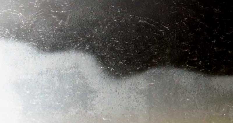

Marius Posted September 22, 2014 Report Share Posted September 22, 2014 BTW, In the picture of closed up Hamon, Could you see Hataraki of Ashi, Yo, Sunagashi, Kinsuji and Inazuma ? Yes. Very clearly :-) Link to comment Share on other sites More sharing options...
CSM101 Posted September 22, 2014 Report Share Posted September 22, 2014 Dear Kunitaro, I think, sonner or later you will choose only a DSLR for photos. A pocket camera is not very useful, because you cannot control light. And even when you change contrast and darkness, JPEG is not good enough for that. Only RAW will give a you chance to work with it and bring out hataraki, chikei, kinsuji, etc. Grettings Uwe G. Link to comment Share on other sites More sharing options...

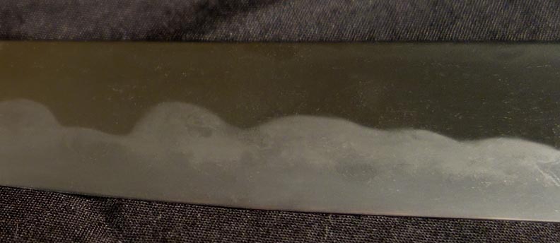

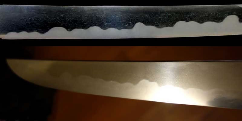

kunitaro Posted September 29, 2014 Author Report Share Posted September 29, 2014 Thank you for many comments and advices. I tired two lights without flash, with tripod. Maybe you can see some parts of Nie-utsuri on Ji and mune-yaki ? Link to comment Share on other sites More sharing options...
Tcat Posted September 29, 2014 Report Share Posted September 29, 2014 A much more natural look! Very nice. Link to comment Share on other sites More sharing options...

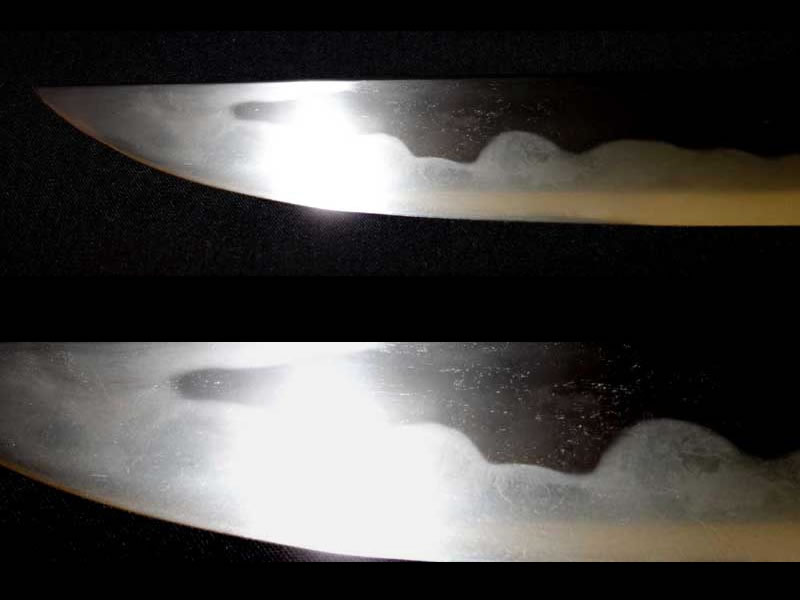

kunitaro Posted September 29, 2014 Author Report Share Posted September 29, 2014 and close up. without adjusting contrast or brightness. What do you think ? Link to comment Share on other sites More sharing options...
Marius Posted September 29, 2014 Report Share Posted September 29, 2014 Cool, but out of focus. Even so, much better if one wants to see hataraki :-) Link to comment Share on other sites More sharing options...

Darcy Posted September 30, 2014 Report Share Posted September 30, 2014 For Muramasa there are inconsistencies. Normally he is not making such thick nie and vivid sungagashi. There are not so many hataraki in the yakiba in Muramasa. It is Muromachi work in Muramasa not Nanbokucho Soshu den or derived. This tanto is more like late Nanbokucho Soshu den then like Muromachi Soshu influenced work from what I see if the jiba. Second problem is that Muramasa's hamon is normally mirror image. If we accept the hadori then there is an offset and mismatch going all the way down the blade including the turnback. This does not rule Muramasa out, it is just inconsistent with 4 out of 5 of his works. Sometimes he made them without mirror hamon. Third is that the nakago jiri is kengyo or seems to be in the bottom right photo, not so clear elsewhere. This is not consistent with Muramasa. But these are almost always added after by someone trying to make a point (pun intended). The Sengo like look of the nakago I think is because the blade is a bit machi okuri so it causes it to taper below the waist suddenly but this is an illusion (I think). Soshu tanto of the late Nanbokucho have often been made with very stubby nakago. Why this is, I don't know, but we see them become machi okuri frequently later as people seem to want to correct for this in later periods with works of Akihiro, Hiromitsu, Hasebe. This makes the nakago fairly straight above the mekugiana where there used to be ha and then seem to suddenly taper in the middle where the natural curve of the nakago was. The result is similar at first glance to Sengo but it is not the same. The type of nakago that makes him famous though is much more clearly formed with a clear concave curvature below the waist. This one appears on the left to have a concave curve below the waist which would be right but on the right side doesn't appear to be the same. One of the two is a trick of the light but it is important to clarify one way or another. So I can't tell for sure in this case, I am hedging my bet but mentioning the illusion caused by these blades. Another side effect is that it makes the already low signed hamon of Hasebe to look extremely low to the point where one may think the tanto is suriage when it is only machi okuri. Hasebe just signed at the very bottom often times. Last issue for me is that there seems to be a lot of nie in the ji forming yubashiri. Muramasa did do some hitatsura but they are infrequent and when I have seen the Muromachi hitatsura it is not the same as Nanbokucho, it is more forced and seems to be a different process. The problem with judgment by nakagojiri is that it is fairly straight forward to put kengyo onto anything or to reshape these without a lot of skill required to do either. Give me a file and I can do it. A friend of mine has a Samonji daito with a clear kengyo on it and in the upper it looks like Go. The blade is o-suriage. When kengyo shows up on an o-suriage blade you need to understand that it is part of someone's kantei. It is very straight forward to add to tanto and sometimes we see a Soshu like blade standing out with one of these in a group of the smith's work that otherwise does not feature them and as a result this is probably something someone added to make it main line Soshu. The blocked out signature leads one to thinking that it might be a Muramasa on there and the nakago shape then makes one fall in line but the rest of the work doesn't really fall in line for Muramasa for me. I think the work in style and quality looks more like the middle to end of the Sa school. If you were wanting to make a mumei Sue Sa blade into a Muramasa it is not so hard to massage the nakago a bit. Even so this nakago in the current state is not a dead ringer for Sengo. The width at the jiri is about 50% of the max width of the nakago. It's closer to 1/3 in the prototype blades. Again there is variation in Muramasa but this one would be an outlier on every front. So I am not convinced. (( 30 minutes later )) I grabbed the first Muramasa and first Sa Yasuyoshi I could find and slapped them on top of this nakago. I had to flip them because the right image is more clear in the blade in question. Scaling is an open question, I tried to match the size of the mekugiana as a reference point then align by machi. The Muramasa tapers more noticably as it is wider at the top and narrower at the bottom than the blade in question (though this may vary per blade, but it gets into what I am talking about in terms of the width of the jiri vs. the mihaba of the blade). The Yasuyoshi I think is much closer in terms of the actual shape and dimensions of the nakago. This is not to say that this is Yasuyoshi and not Muramasa, it does illustrate one of the departures I spoke about though. I just grabbed one from the era and I think the rest of it reminds me of Sa school more than Muramasa. So that is my feeling on this one. As a side note, look at the low position of the Yasuyoshi mei. This tanto is not suriage but I think is also a bit machi okuri and is featuring the same original structure and so later period correction as other Soshu style tanto. Stubby nakago and long body. I'm curious why they did this as it seems like it would not be a very good feature. In later periods they seem to agree because we see it altered so often. Do keep in mind that I had to make mirror images of the signature sides of these oshigata to layer on top of the right side image of the nakago of the blade in question. Link to comment Share on other sites More sharing options...

Darcy Posted October 1, 2014 Report Share Posted October 1, 2014 Here's what I counted in the Juyo zufu. 52 items, 14 katana, 14 wakizashi, 18 tanto and surprisingly 7 yari. Yari are never mirror images for anyone and I am going to discount them as this is not a yari. My yari also did not have mirror hamon but I thought it was just an outlier at the time, so I learned something about Muramasa yari here. From the comments and signature what I could figure for sure went to the Shodai had 4 mirror hamon, and 1 without mirror hamon. 1 other blade looked like it was meant to be a mirror but tempering was not perfectly balanced. Close enough to small notare that I couldn't judge it either way. There seemed only to be one that was directly stated to the third generation. It was mirror image. Masashige had three that mirrored for half, it looks like it's intended but not coming together, three clear no (one of which is hitatsura), five clear yes, one undetermined because they added the koshirae and didn't show the alternate hamon due to space concerns. Just over 50%. Masazane has one mirror but suguba over half of it, then the same bit of quasi-notare on the lower (goes up and stays up for a while, goes down and stays down). One more suguba but starts with a dip on both sides in the upper so counts. One hitatsura is a mirror. One slowly undulating suguba ashi fails the test. So 3 out of 4 again. In all this I think defends what I said. On the Muramasa signed blades there is no departure from nidai to shodai to sandai in frequency of mirror image showing up. Sandai can't really be assessed with only one grouped in there. Masashige, majority mirror and Masazane 3 out of 4. So it evidence agrees with the Nihonto koza that there is faithful reproduction of style over the Muramasa name, and is pretty much what I said. I think if someone wants to make flat denials of the Nihonto Koza and of the Juyo zufu examples then the onus is on them to provide evidence for the opinion or just hold it as a contrary opinion with no basis. But I think the point stands that the statistics make it an outlier piece if it is associated with this school and not in mirror hamon. That does not rule it out but it puts it on the unusual side. There are only so many unusual that can be tolerated in one piece before doubt is raised. So that is the backing of my opinion. Won't be commenting on it further as the original poster asked for our thoughts, these are mine, and are backed up, any arguments to the contrary can be made to the oshigata and Nihonto Koza. Link to comment Share on other sites More sharing options...

kunitaro Posted October 3, 2014 Author Report Share Posted October 3, 2014 Thank you very much for good discussion with sharp discernment. and Thank you Darcy san for your very interesting picture comparison of Nakago, That is WOW !! As I wrote "This is not really for Kantei.." because, it has no answer…. The mei is "Hiromitsu", but, it is Gimei…. But, The quality and condition of the blade is excellent. My photo doesn't show enough, however, I think that the blade is late Nanbokucho Soshu. as Darcy san wrote, the Hitatsura of Muramasa or Sue-Mino, even Sue-Soshu are more Nioi-deki, and more looks like Hamon than Utsuri. and this Utsuri is besed on Nie, much brighter than Bizen utsuri, and Shirake-utsuri of Mino is more whitish cloud without activities. This has very complex hataraki in bright utsuri and it mixed ji-nie and chikei makes more complex…. The Hamon itself is Nie-deki based on Gunome-midare and Nie(s) are all over in ha and on ji, so the border of nioi-kuchi and ji (utsuri) are not clear. so, if the blade is old Sashikomi polish, we can not see what is what,,,,,, When you see close up photo of Ha. There is many activities IN Ha. also, you see many very strong Kinsuji(horizontal dark line) and Inazuma (vertical dark lines), some are thicker dark lines. That is called "Strong excellent kinsuji" that is the sign of old and high class activities. Ji and Ha looks like Soshu Akihiro or Hiromitsu. the mei was cut in Edo period, and it has old Torokusho 1955 from Kyoto. It is called Daimyo toroku. This kind of sword (very high quality old Gimei blade) is called "Daimyo Gibutsu". Daimyo(s) must have certain sword collection, but they were not enough for all Daimyos, so, They made Gimei blades for their collection. sometime, they made new swords, sometime they made signature on old high quality blade. Many of these kind of sword were taken the mei off, made it Mumei and got high Papered and sold after modern kantei system. because, Gimei swords don't get certificate. If the signature is Gimei, they don't examine the blade. When it is un-signed, Mumei, then it will get paper, Many of modern collectors are relay on papers to estimate the value… If the mumei blade is attributed as Kamakura or Nanbokucho period, good quality and good condition, It would become Juyo-token. sold for high price. so, many of these blade's mei were taken off… I think that it is pity, because, it is part of history of the sword as formal Daimyo collection. when you take mei off, then Old torokusho also gone, get new torokusho. then interesting history of the blade is gone. It is possible to be attributed to mumei "Soshu Hiromitsu" after the mei off, and get high rank paper. It is often happening, because, put the Mei on the blade which look like. However, I prefer to keep this way, not for investment but preserve its history. and we can enjoy high class blade with low price. These kind of blades were treated as treasures under high ranking Samurais during Edo period, Meiji priod till before ww2. I would like to ask people about this concept. What do you think ? Link to comment Share on other sites More sharing options...
