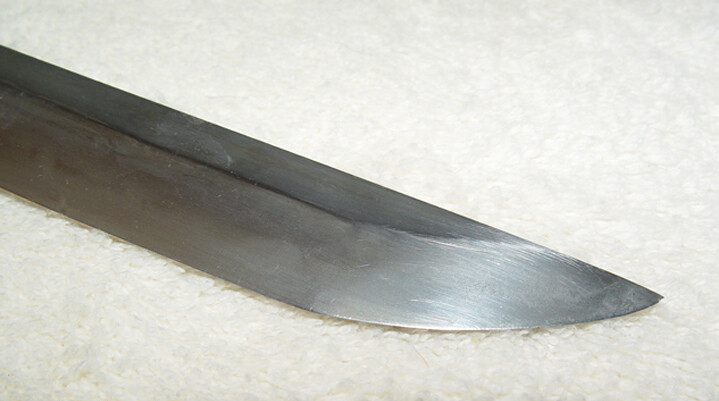

AndreasU Posted July 30, 2007 Report Share Posted July 30, 2007 Right! After I received it from Mike this is what I got: And here are the pics I sended the morning before Charles agreed to buy it: In one thing I have to correct Mike a bit. One end of the saya was open and the paint was partially away. Zhis may look like it was cutted but again I didn`t. I just splitted the saya to see if there is a repair possible to make it a better fit. Link to comment Share on other sites More sharing options...
mike yeon Posted July 30, 2007 Report Share Posted July 30, 2007 And here's the original kissaki (as it was when I sent it to Andreas.) As you can see it's a little longer. Andreas, I'd recommend you work it out with Charles like we worked it out originally. Link to comment Share on other sites More sharing options...
kusunokimasahige Posted July 30, 2007 Report Share Posted July 30, 2007 okay here come my metalworking skills....... i have had these things happen with a few Roman Gladii.... now here is what must have happened.... the kissaki was bent, then repolished... which means the kissaki was bent forward and polished... problem when doing this is that the metal keeps soft in the exact spot. thing goes in transit and falls, with a LOGICAL result that the tip bends in virtually the exact same manner, being soft.. the only solution is for someone to rework the tip completely, since the other solution (strenghtening the kissaki again) is to hammer it back into shape, reheat and re-cool it again so that it gets hardened again (ruining the sword much more than a reshaped kissaki would do) since these problems also often happened in the age of the Samurai, and kissaki were very often reshaped, there is NOTHING wrong with reshaping it......... it wont make the papers any less valid, and you can always re-shinsa it... so whats the fuss? if its a money question, i must say that i would almost want to demand that you act in a SAMURAI manner!! so... sorry to say this, but stop whining and sort it out friendly. excuses are always a nice thing, and well if the both of you truly feel your honour has been damaged and you have lost face, you can always still open your stomach and restore it... (which i would not advise since its a messy business) just sort it out............ ONEGAI SHIMASU!!! KM Link to comment Share on other sites More sharing options...

AndreasU Posted July 30, 2007 Report Share Posted July 30, 2007 And Mr.B says: No it wasn`t bend back. The only way to restore a Kissaki is to accept that some material will be lost. That does mean that the damaged part was polished "off" and the the whole curvature of the Kissaki (Ha) was reshaped! Everything else is B-$hit! But still there is 5-8mm material left after this to reshape the Kissaki again. Anyhow, as stated before, the blade needs a polish. So it`s an easy task for a polisher to do the minor repair. It`s ot more, The whole story about is that I don`t like to get named a lier and cheater! So this was my last statement to this. Everything is said and sorted out. End of story. I am looking forward to my new sword and saw today it arrived at customs. Yippee! Link to comment Share on other sites More sharing options...
Brian Posted July 30, 2007 Report Share Posted July 30, 2007 Ok..how about this: 1)Andreas says rightfully that the saya was longer than the blade. 2)Charles says that the saya was too short, and the blade sticks out the front. 3)Mike says that the kojiri was not there, leaving the bottom open, but with space and clearance for the blade tip. I believe the kissaki was bent, reshaped and was in good condition on shipping it. Andreas, I do believe your method of wrapping the blade in cling film, and then putting it in the saya (even with tape and bubble wrap) was not enough, and in being dropped end on, the blade shifted down into the saya, with the end of the blade comming right through the bottom of the saya, and either hitting something hard (floor or wood on the saya?) and bending the tip. This would explain why Charles, on opening the package, would see the blade sticking out of the end of the saya, and looking like the saya was too short. This does explain both sides. Whether you 2 can agree that this happened is up to you. I would like to see you both agree on someor other probability, and come to an agreement like Mike did with Andreas. Try and see the situation from the POV of the other guy, and try and understand their feelings, and maybe this can become civil again. I am only letting this discussion carry on to serve as a warning to both buyer and sellers, and as an education into packing Nihonto. If you keep it fairly civil, I will let the discussion go on, otherwise I will be forced to lock it. Regards, Brian Link to comment Share on other sites More sharing options...

Mark Green Posted July 30, 2007 Report Share Posted July 30, 2007 You cannot over pack a sword. I like to use strips of hardwood if no saya is available. bags of foam and tape. There seems to be enough boshi to fix the tip "again". This will need to be the last time, and I'M not sure the shape of the fukure will be the same. But, it does look fixable. Polishing this is the 'ONLY' way this can be fixed. Sure a heck, no heat is involved. That would destroy the temper of the boshi that is there, and would ruin the sword. I have seen much worst fixed. Not a bad little sword. If it papered at last fall's shinsa it must be a gem. You guys work it out. It was likely dropped by the shippers. Give them hell first. go all the way to the top. Regestered letters. Mark G Link to comment Share on other sites More sharing options...
