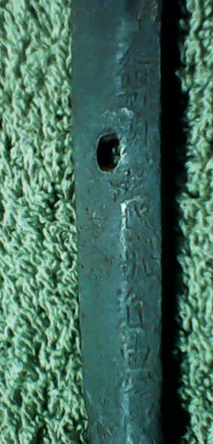

This is my first time getting a mei translated. Let me thank you in advance for the time you spend helping newbies like me... :)
The subject is a wakizashi in really poor polish, and what I think to be parry marks on the back of the blade. I bought it in shira-saya mountings from a dealer I trust for $450. I bought a modern chinese wakizashi, took it apart and discarded the blade, then adapted the fittings to my new (old) blade. I tied the handle myself with parachute cord--which does work, although you have to pull it very tight in the process. Here is a photo of my sword along with the now-empty shira-saya mountings.
Here is the mei in question. I apologize for not photographing it top to bottom; I wanted to get more detail in by going sideways. I also apologize for my cheap, cheap phone camera quality. If you can actually read this, I salute you.

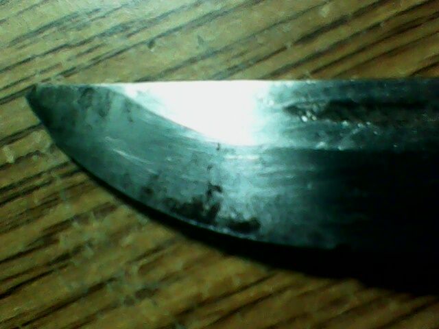

The kissaki. One can find the yokote, but the really lousy polish makes it invisble, I think, in my best photo. It's very faint, but appropriate and present on both sides. One might be able to make out the boshi; note the bite out of the very tip. Gah.
The parry marks I mentioned. I realize they could be faked, but my gut tells me this blade was actually fought with.

Back on topic. I do have better close-ups of the mei, but I was keeping myself within the five picture limit. Having read the forum rules. :| Here is the top half:
The bottom half. I really am sorry for the quality of these photos. My phone is so, so cheap.
I suspect that there might be one more kanji after the last kanji in the picture. :?:
Hi Jim,as I a Jim too ;) I fixed the photo right side up for you, It looks like even with a better photo it going to be harder as there is some damage to the Mei also one of the reasons for not putting nihonto in Chinese stuff is the wood on some of them is an unknown and potentially can cause rust over time. Hope that helps :D
備州 ナントカ 丸 光兼
At first blush this is what I am seeing. Was not able to find a smith with these kanji in the Meikan. More and better pics will be needed. Jim - preservation is the watchword even for folks who do Iai, and I do hope you're not doing any yardwork with it...
You rock! :) Heck, that looks clearer than the real thing almost. Guys, I will consider your advice about replacing the sword to its shira-saya. I know you mean well. It's just...well, nothing compares to the balance and feel of this sword in a draw. The chi (*ki* for us nihojin types) is like lightning and water. In the shira-saya it was in cold sleep--an artifact more than a living sword. Note: the old shira-saya is also in poor condition, and split to the point that it cannot be drawn at speed or used in a cut if necessary. I could repair with glue, but I know for sure that that is a no-no of great order. The shira-saya is carefully preserved.

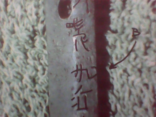

I took my original photo of the mei and printed it out. Then I took the actual tang and compared what I could make out in person to what is in the photo. What is noted in marker is what I am sure is struck there by the smith as his mei. There could be more, but I cannot pull the detail from the background noise of rusty bumps and wiggles. Forgive my shouting, but I think I need to emphasize this: THE MARKS ARE ON THE PHOTOCOPY, NOT THE TANG ITSELF!!! ;) This time I split the signature in three sections, which overlap.
The top, where the blade begins:
The middle:
The end of the tang. And yes, that is absolutely the last character. I see no evidence of more below that.
I noted two places of interest, A and B. A is a rough patch in the steel where I suspect a lot of detail has been lost. That's the smith's name, isn't it? Crap stick. Area B is a spot where the part of the kanji that curves off to the right disappears altogether, then comes back further up. Looking at it, it seemed apparent to me that some of the steel has been removed at some point in its history.

I've neen pouring over the kanji tables myself, but it's obvious to me that with the unclear signature I have, I could spend a years trying to match up my squiggles. It looked as if Moriyama-san and Toryu-san had an idea what they might be...but my computer won't display Kanji. :| Can't install them because I can't find the flipping windows XP disc...
Could some helpful human help this foolish rabbit out by telling him what those guys came up with in Romanji? I'm probably still stuck, but it will give me an idea where to start.

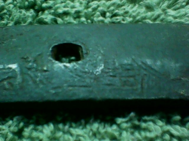

Howdy, all. :) Sorry to bump this topic, but I finally have the better pics that might help finally identify the maker of this sword. Right now, all I know is that someone named Maruko made this sword, and it was pretty there...
From a different angle:
Any ideas on the damaged area? All I see is chaos, but perhaps someone here can make sense of it.

I agree with Jean: Bizen Osafune-ju Kane (cut off)
備前長船住兼
It almost looks as though one mei was chiseled over another mei. There are a number of confusing marks or scratches near the mei that make the individual kanji take on characteristics of other kanji. Particularly the 住 looks like a completely different kanji. There is enough space under the 兼 to accomodate the second half of the name, but all I see are the three prominent parallel scratches.
Edit: I looked again at this, and I can't completely reject the possibility of Chikakane, but of the many Chikakane smiths, most of them use a different "kane" (近包). I couldn't find any 近兼 smiths from Bizen. There was only one smith by this name in Hawley's (CHI61), and he is from Mutsu.
Just to add, with this kind of mei, the name Kanemitsu comes to one's mind. THE Big One. Only one which mei syntax matches this one (Bishu Osafune JU...). Gimei. Steve (who never ceases to surprise me by his translating skills) is right when mentionning that the mei has probably been messed with.
