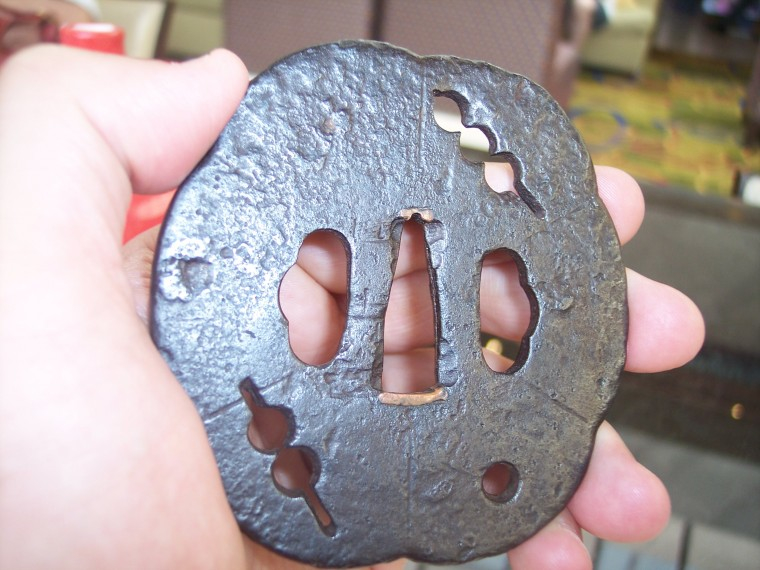

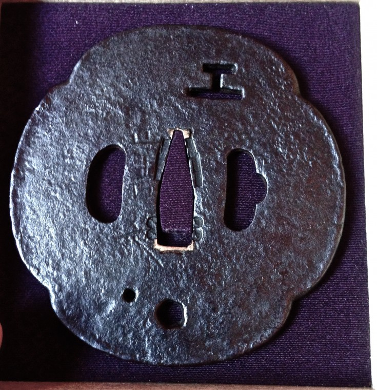

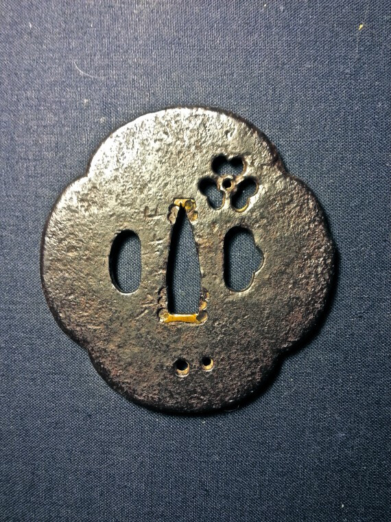

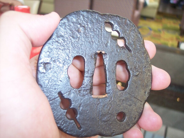

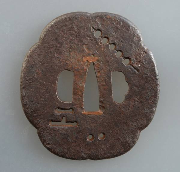

Not too long ago, the first tsuba pictured here received NBTHK papers to Saotome. For many, such papers with such an attribution would put an end to any speculation as to who/what group may have made the work in question, as the NBTHK had "decided" the issue. The fact is that this tsuba was certainly not made by any tsubako of the Saotome group. It is positively a Yamakichibei tsuba. Not only is it a Yamakichibei tsuba, but the specific Yamakichibei tsubako who made it is identifiable. The style, workmanship, motif, and remnant mei(!) all confirm this "attribution." I am providing photos of two other Yamakichibei guards, made by the same tsubako as the tsuba in question, for reference.
As I have said many times in the past, I don't necessarily fault the NBTHK for making mistakes, even ones as serious as this. The far greater fault is to be found in those who uncritically and unreservedly accept any and every NBTHK/NTHK judgment as inarguable fact. Because the inescapable conclusion, drawn from the egregious NBTHK mistake in stating this tsuba to be Saotome, is that one can never know when the NBTHK (or other "main sword group") will be in error, which means that having full and unqualified confidence in papers is necessarily sheer folly. And all of the above is besides the murky issue of the politics of shinsa/papering, which only further cloud the reliability of papers... This is not to say that there is never any circumstance in which it is reasonable to seek papers for tosogu; however, I would argue that even in such a case, whatever judgment is rendered is only a starting point in ascertaining the actual origins/maker of the piece in question.
Steve
It does look Yamakichibei, but how can you be so sure it is not Saotome? I can't see any remaining mei by the way. Is it on the back? (Don't tell me I should take your word for it.... 8) )
The provided pictures don't do anything to demonstrate your point because they are chalk and cheese compared to the Saotome one, in my opinion.
Sorry if this seems antagonistic but please, to all you Amakudari out there, come off your perches.....

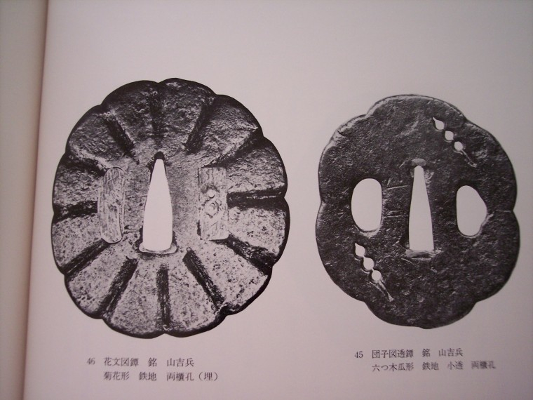

You need to look a little more carefully, amigo... There are certainly the clear remnants of the "bei" character from the Yamakichibei mei present in the "Saotome" guard, right between the "e" kana character and the left bottom corner of the nakago-ana. Further, the subject in the upper right of the tsuba references skewered dumplings, which as a motif has very tight associations with Oda Nobunaga, whose home province of Owari the Yamakichibei tsubako lived and worked in as well. The Yamakichibei tsubako are known to have reproduced this particular motif with some frequency (see photos below). Scholar John Dower, writing in The Elements of Japanese Design, notes that "..."...Oda Nobunaga [織田信長 or おだのぶなが - 1534-82], Japan's great sixteenth-century unifier...wished to see the severed heads of his enemies skewered like dumplings on a spit." (Dower, 110) Nobunaga's well known fondness for dumplings even resulted in a nickname for this particular food: uesama dango---"his highness's dumplings." (http://www.busho-aichi.jp/english/index.html) This design motif alluding to "Nobunaga's dumplings" is reproduced in the first image below. That there is a firm, concrete connection between Yamakichibei tsuba and the use of this motif is thus clear enough, but on top of this, I know of no other group or individual tsubako who uses this particular design, certainly not the Saotome. And on top of that, the use of (what looks to be) the "e" kana (katakana) is another practice virtually unique to Yamakichibei tsubako (see photo below). When one combines this knowlege of use of "trademark" motifs, with the yakite treatment evident on the tsuba in question, AND the remnant "bei" ji visible just at the lower left of the nakago-ana, it becomes abundantly clear that this is a Yamakichibei guard, and not Saotome. Yet it is papered Saotome.
Still chalk and cheese...?
;) Yes, I can see where I come off as rather stubbornly insistent... But I suppose it would be helpful, as John said earlier in this thread, if the various shinsa teams were (more) transparent and generous with their assessment processes. Doing so would not only make their judgements more trustworthy/dependable, but would afford a terrific learning opportunity for us poor, lost students... One wonders why such "generosity" is not made available, especially given the prices paid for papers... I know I would love to see the explanation offered up for determining the tsuba in question to be Saotome... ;)

I'm with Henry on this one.
Perhaps it is the pictures but the iron of the first "Saotome" looks nothing like the quality of the iron of the rest.
Nor does the shaping of the hitsuana or the quality of the sukashi work.
Could this 'Saotome' not be an utsushi of Yamakichibei?
you do mean the your´s i suppose Jean?
if me am correct with that assumption-well yes of course Jean!
Certainly!
Definitely no need at all to let certify such....
(me but have to confess this school here,it´s not really mine stuff-you but do know that mine is Owari and Akasaka only)
Christian
Lee,
Well there are a few things to consider here... First (as your qualifier suggests), arriving at confident judgments of iron character from photos is notoriously challenging; my providing of the photos of other pieces is therefore not so much about inviting careful comparisons of the various pieces' iron qualities as it is about offering tsuba to compare the mei and motif-work of. Further, the tsuba in question would seem pretty clearly to have significant condition issues (to put it mildly). The hitsu-ana would likewise appear to have been tampered with (also to put it mildly). As to the rendering of the sukashi elements, again, a hand-held examination would afford more confident conclusions.
As to this being an utsushi of Yamakichibei work, it could be, but I strongly doubt it. However, having said that, I need to emphasize that I do not subscribe to the current view which holds that there were only two early (Momoyama) Yamakichibei tsubako. I believe there were at least four, probably five, of which the man who made this piece was one. Utsushi of Yamakichibei work is more or less limited to 19th-century copies after the time of "Sakura" Yamakichibei (latter 17th century), who did do some utsushi work, mostly in the vogue of the "nidai" Yamakichibei. When one views the 19th-century Yamakichibei utsushi, one does see very different treatment and appearance of the iron itself when compared to authentic Momoyama/early-Edo pieces.
In any event, Lee, the main point of my original post was that the tsuba in question is not Saotome, yet it received an NBTHK paper to Saotome. Anyway, I fear that I am... :flog:
Cheers,
Steve

@Steven,
this discussion about an Saotome attribution,is,as obviously to ben seen(for those of us,who did specialise and dedicate their´s study to the Group of Owari Tsubako)-simply speaking ridiculous in every aspect.
The given attribution to Saotome is of course totally wrong!
(me´d really love to speak to that Shinsa-guy who gave that attribution ;) )
generally speaking-the BIG problem with these Shinsa teams in Tosogu is(still!),they just are not individually specialised to one certain/specific group(like Sasano-san for example was,(however he always refused to be "active" in Shinsa as we know...((me do ask me why? ;)) ...)...
These Shinsa rather but have to cover the entire field,but...
and this,is strictly speaking-IMPOSSIBLE!
Impossible due financial situation of these associations...
yet but also impossible due politics of course!
That´s but no critic-it´s just reality-and you have to accept,despite you are willing so to "reset" old beliefs again....(ouch!...tough!)...LOL!
