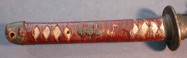

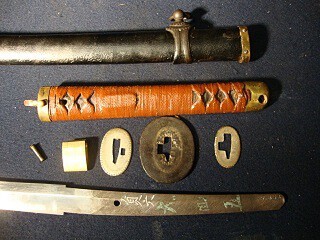

There seem to be several variations on the type 3 theme. I would put them into two groups: those with lacquered tauka-ito and wood lacquered saya, and those with unlacquered ito and metal saya, usually a light, olive green color.
The first type above are often found with RJT blades and I have to wonder if they weren't developed at the same time as the RJT program was launched, and possibly specifically for the RJT blades. Sometimes non star stamped blades are found in them too, but nearly always better quality blades.
The second type, in my experience, are always found with with low end, machine made showa-to blades. I have NEVER seen one with a quality blade.

The first link is to the newspaper articles announcing the introduction of the new type of fittings, and also the drawing from the army information pamphlet that describes the new variation...too long for me to translate (I could do it but you and I would be a lot older by then...)
The second link shows the early/high quality lacquer type Type 3 (often RJT and other gendaito blades) and also the lower group is the better later/lower quality type. All? of these later/lower type have good blades by such as RJT Sadaroku and a Nakata Kanehide ...(see 2 lower pics of red lacquered tsuka type)...some do not have dust cover seppa, but I think all/most have second button.
This link does not show the lowest quality "awful" variation with steel (lighter brownish) scabbard and unlacquered tsuka ito.
This "awful" type usually have no second button on the sayaguchi and usually have no dust cover seppa....usually 99.99% showato blades....BUT...this will interest you Chris...I say 99.99% as I have seen 2 star stamped blades in these...1 by Nakata Kanehide (see top pic) and 1 by (forget, but Seki I think), and a third also by Nakata Kanehide, but with no star and no tiny seki stamps as it had a hagiri.
The only difference with these 3 and the other "awful" variety was that these all had the second button and the dust cover seppa, BUT imho, the mount quality is way below the blade quality. Maybe only the hagiri Kanehide "deserved" the mounts.
As all the blades I have seen in these were dated late 1944-45, maybe it is a sign that like the better later/lower group with black lacquer saya - red lacquer ito, these good blades in "awful" mounts are towards the end of the war and some corners were being cut in mountings quality? or maybe, it was just convenient for the showato mounting shops to use some "awful" fittings on some RJT swords? who knows.
