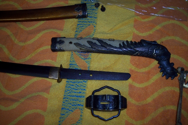

Sooooo, how do I remove the Tsuka? Is the round fixture a screw? Is there still a wood peg underneath? Again, not my blade but I really look forward to studying it further.
Thanks in advance.

I have never dismounted one of these but you may find one of the following; a screw on one of the menuki fitting into a threaded shank on the other, the same but with a left hand thread just to confuse things, less likely a round shank on one fitting into a hollow shank on the other. I would advise real caution, if they have not been moved for some time they might be quite tight. Looking forward to seeing what you find.
Yes, the one at the end of the tail feather.

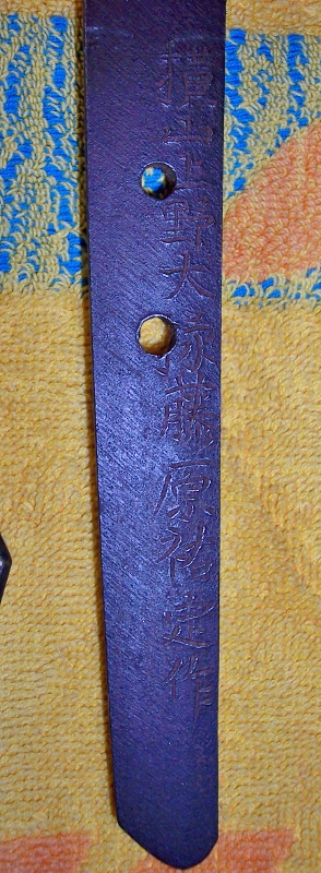

Whew! :phew: was able to get the Tsuka off. Has not been removed for at least 20 years. Screw came off like you guys said. Can I get some help on Translation? Fujiwara Sukesada?
Ben M.

Yokoyama Kozuke Daijo Fujiwara Sukesada Saku.
Grey

Grey. Thanks! Wow. Could it be this Sukesada? :shock: Not my sword, but if it is, my friend will be very very happy. No papers...I'll post pictures of blade. wow...

That's the smith this signature is representing, but that doesn't mean that's the smith who made this sword. There are many gimei (fake signatures) for this smith.
I am not going to give an opinion one way or another on this specific sword as I don't really know this smith well enough to even form a good opinion. But I am just letting you know that just reading the mei does not itself form an airtight appraisal.

I am not at home at the moment but I have an NBTHK papered blade by this Sukesada. From what I can see, it looks very similar to the signature on my blade.
Fred D

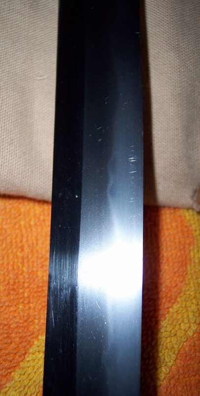

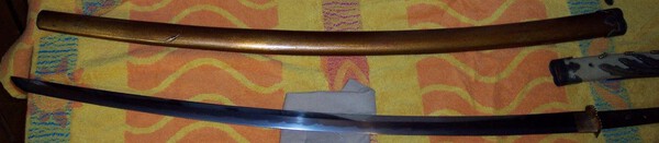

Attached are a few pictures of the blade....not the best pictures and I don't have in hand. What would you suggest as next steps with this one? Send to someone in the U.S. for evaluation and possible Shinsa submission? Post more pictures? It belongs to a friend of mine who has only a passing interest in Nihonto but this is a Sword passed down from his father so he wants to keep it for that reason alone. He is interested in the value (relative range) for insurance purposes and to ensure that the next generation does not give it away.
I find it interesting that the saya is missing most of the elements (I believe Sayajiri, Ashi, and Semegane). Not sure if the pictures show but you can see the gold color not as faded in those areas. You have to wonder why these would be removed? Clearly a shame as I find this Tsuka beautiful, but incomplete without a fully matching saya with all the mountings.
I was thinking about buying him a book which features works from this Sukesada...perhaps peak his interest so that he may wish to learn more about Nihonto and interesting Koshirae like this one.
All comments and suggestions welcomed.
Ben M.

From only the few pics, I think this sword may be genuine, but my opinion doesn't get you very far, so... get more informed opinions, even better if from someone with the sword in hand.
Also, I see an older mekugi-ana (meaning it has been remounted sometime into these tachi mounts). Makes me wonder how a sword like this (if genuine) would end up in mounts like this. Should these mounts make us question the authenticity of the sword? I'm not sure...
Edit-I forgot how early Kozuka Daijo Sukesada worked (Genroku-1688)... I am seriously doubting the sword mei now (I'm thinking the sword is newer- maybe Shinshinto?), but maybe you can get some better opinions from members more familiar with this smith...
Adam L.
Adam: A bit earlier than Genroku as this Sukesada was Era Kanbun (1661-1673). Clearly it was remounted as many swords from this earlier period have later Koshirae. I don't think that is the question. According to Markus' book (see pdf link above) "The torikubi no tachi (lit. „bird-neck tachi“) is a ceremonial tachi mounting which as its origin in the Kofun-period keikantō no tachi (鶏冠頭大刀, lit. „cockscomb-pommel tachi“)." I would think that a mount of this quality and significance would not have a lower grade blade. If anything it makes me more inclined to believe it is authentic. I defer to the experts however on the technical and quality aspects of the blade as to whether or not the it is Gemei. I agree with your advice to have it evaluated by someone "in hand."
Again, welcome all opinions and direction.

I'm back from a period of not actively participating or collecting.  I've been doing a bit of reading and look forward to getting back into the "business."
Does anyone have any ideas or thoughts on how to acquire the "furniture" on this saya?
I find it interesting that it was removed at one time...you can still see the spots where the lacquer is less faded in those areas.
Is there any hope to get this back into the condition shown in the picture below?

A better pic of the saya I'm looking to fix.

As for the mentioned price, athough I haven't seen the mentioned koshirae, to make hiqh quality koshirae would cost even more.
I can make you matching missing parts for your saya if you are interested send me an email please.

I purchased one last year on ebay.  Several experts have examined my sword and believe that the blade is early 1500's.  My blade has three holes, so koshirae has been replaced several times.  Anyone who attempts to evaluate your sword from a photograph is not doing you a favor.  Don't judge the blade from the koshirae or signature.  Get several experts to examine your blade in person.  A true expert will not charge you for his opinion.  A written appraisal, however, may cost you.
