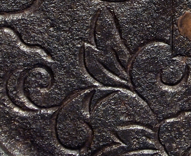

It is a small, iron tsuba, with a nade mokko gata 撫木爪形, sukinokoshi mimi 鋤残耳and a cross section described as sukisage no ita 鋤下げの板. There are carvings of various plants front and back, the easiest to identify is omodaka or shogun grass (sagittaria trifolia) with the characteristic three leaf arrowhead shape. On the front and back there is some foliage in the top left which might be seaweed. The motifs and signature are carved using a technique called giri-bori. Apparently giri means kick (I can’t find it in any dictionary thought) and this style of carving technique does not remove metal but displaces it, using a special shaped chisel. It is the kind of technique commonly used for signing blades. There is some tekkotsu on the plate surface and granular type on the rim, and there are some faint fold lines near the rim, too.
The surface of the tsuba is slightly concave on both sides, this effect is known as sukisage no ita 鋤下げの板, and the distribution of the metal from the nakago ana to the mimi is subtle, but very pleasing. The overall finish of the tsuba has a kind of yakite shitate which softens the carving, but the mei is confidently carved, not worn at all, and would appear to have been added after the surface treatment. The rim is quite low when compared to similar ones seen on other “katchushi” style tsuba, and the kozuka ana has a soft, round shape. The kogai ana is plugged with lead which is punched front and back and it has a nade 撫 shape too, just like the outline of the tsuba.

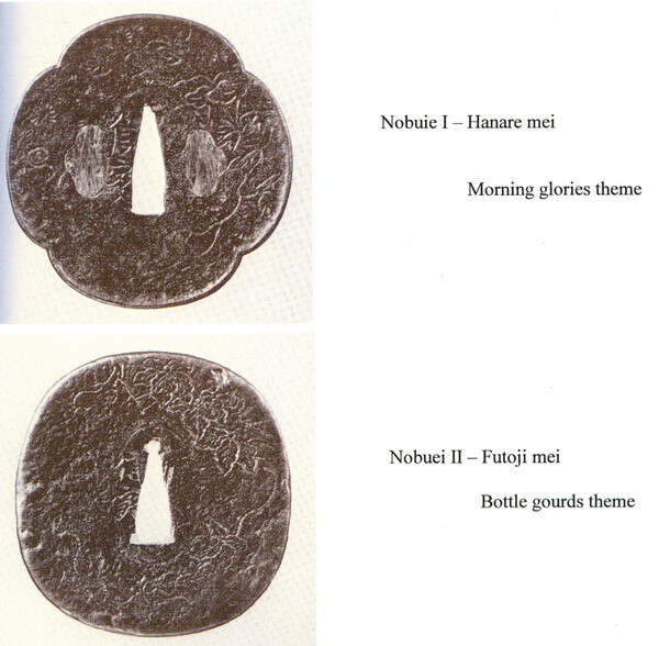

Pete Klein commented that the mokko rim bothered him at the intersection of the mokko lobes. Nobuie’s rims and how he manipulate them in the corners or joins of the mokko lobes is said to be a kantei point. Sources says, in particular Kastuya Toshikazu, that Nobuie was very competent at this tricky task however, he also states that his work was not always perfect because Nobuie was only human after all. Below is a picture composition of three Nobuie tsuba. Look carefully at the intersections of the lobes and how the rims taper around the area connecting the lobes. The left tsuba has perfect lobe-rim work, meaning the rim keeps a consistent and pleasing shape and thickness as it turns from lobe to lobe. My tsuba is in the centre, and the right tsuba has some lobe-rim turns (the top right anyway) that have lost their shape and are slightly flat. I think in comparison, my tsuba in the centre is not so bad and there is nothing really to worry about.
Brain Robinson mentioned signature type. From my research, Akiyama identified several Nobuie signatures and grouped them into two groups: Gamei 雅銘 (elegant), describing the writing style as gentle, slight and tasteful and found on the work of the 1st generation Nobuie. The other group is Chikara-mei 力銘 (powerful or mighty), and described as strong and bold, and are of the work of the 2nd generation. The variation of the signature styles for each generation with in the Gamei or Chikara-mei groups is believed to represent a change in signature style over the years of each tsuba smith’s career. See examples of these groups in the three tsuba picture composition above. By the way, I think that the Nobuie signature that is similar to the one found on kabuto has been discarded as not being “real” Nobuie tsuba smith work.
The signature of my tsuba is very bold and that of the 2nd generation who signed with futoji mei 太字銘 that falls into the Chikara-mei group. This dates it to around the Momoyama period as he is said to have worked the periods Tensho 1573- 1592, Bunroku 1592-1596, Keicho 1596-1615 and most of Genna 1615-1620 in the Kiyosu area of Owari, near present day Nagoya, after which he is said to have moved to Aki Province (modern day Hiroshima Province) around 1619. Compared to accredit mei, the mei on my tsuba looks authentic and verifies the workmanship as being that of the 2nd generation Nobuie.
It is wakizashi sized and when small Nobuie are compared with large ones, generally they appear to consist of completely different metals. In my opinion, small Nobuie seem to have a less refined metal, finished with a totally different patina. I have been able to compare in hand this tsuba with two other large Nobuie, one with a Gamei and the other with a Chikara signature, both papered, and I was surprised how similar they felt even though the size, metals and patina were quite different.

There are carvings of various plants front and back, the easiest to identify is omodaka or shogun grass (sagittaria trifolia) with the characteristic three leaf arrowhead shape. On the back there is some foliage in the top left which might be seaweed. The motifs and signature are carved using a technique called giri-bori. Apparently giri means kick (I can’t find it in any dictionary thought) and this style of carving technique does not remove metal but displaces it, using a special shaped chisel. It is the kind of technique commonly used for signing blades.
